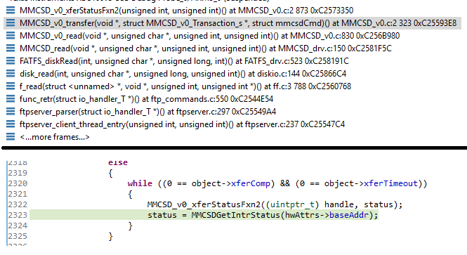

I'm using the latest SDK (pdk 1.0.9) and I have a problem with MMCSD.
Sometimes during read/write a program hangs on the MMCSD_v0_transfer fucntion and never goes forward again.
The same problem I have found there  -> http://e2e.ti.com/support/processors/f/791/t/649423
but I didn't find a solution there..
Could you help me solve this problem?
Patryk

  • Hello Sahin,
    I'm not using DMA, I know this problem because I reported it myself.
    This problem occurs for all sizes because it occurs for different functions:  f_read, f_write, f_open, f_mount, etc
    In my main application I also have other modules and I am working on a custom board but I did a test where I am only using MMCSD on the LCDK board and sometimes I observe the same problem.
    The function MMCSD_v0_xferStatusFx2() has a very big problem because when I enter it and some error occurs, it is never left and the application becomes useless.
    Patryk

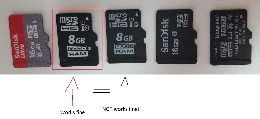

  • Hi Sahin,
    I did some tests using different SD cards and each card behaves differently...
    I have only one card which works properly.
    One card hangs on f_open the other after a few seconds on f_write, etc...
    In my test program LED D4 indicates  the operation status (when blink all works fine).
    Please, try to do the tests for different cards and see if you never run into this problem
    All cards work correctly on other devices...
    I work on the MMCSD_FatfsConsole_lcdkOMAPL138_armExampleProject
    Regards, Patryk

  • I'm using:
    - Goodram 8 GB SDHC (I have two cards and one works correctly)
    - Sandisk 16 GB SD
    - Sandisk ultra 16gb SDHC
    - and other old microSD cards
    Any news?
    Patryk

    It's different for different cards. I noticed that the problem doesn't occur for all cards. For one card the problem appeared after save 3x10MB, other after 534x10MB. It's random, and I find it worse because we don't notice this problem.
    By the way, I noticed a strange behavior because when I disabled MMU: Mmu.enableMMU = false; the program always works fine and I have never seen a problem on the cards.
    Patryk

    I did a lot of test today and I noticed that the problem is dependent of the SD card but I think that the MMCSD driver should protect against a situation in which we use inferior cards.
    Patryk

    I have only one card which works well. But I have two the same cards and one of them not works fine.
    I noticed that for each cards the "hang problem" occured always at the same point (for example: first cards while writting 524288B other while reading XXX B) but each card has a different weak point.
    List of my cards:
    Patryk
