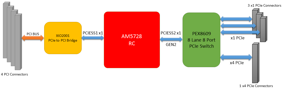

I have build the system I have described here:
AM5728 PCIESS1 is connected to XIO2001 PCIe to PCI bridge and PCIESS2 is connected to PLX8609 PCIe switch on PCB.

My question is at least how to see XIO2001 and PLX8609 switch on lspci ?

    To understand if it is really PCIe2 which causes the issue, have you checked
    - Before enabling PCIe2-rc, plug the PEX8609 switch to PCIe1-rc to see if it gets detected?
    - After enabled PCIe2-rc, plug the XIO2001 bridge to PICe2-rc to see if gets detected?
    - Instead of XIO2001 and PEX8609, try to plug in PCIe-Ether or PCIe-USB card in all the scenarios above?
