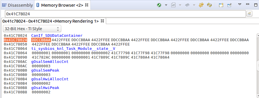

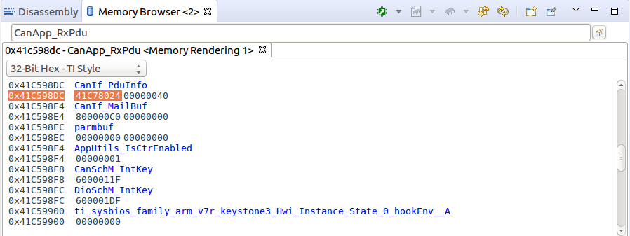

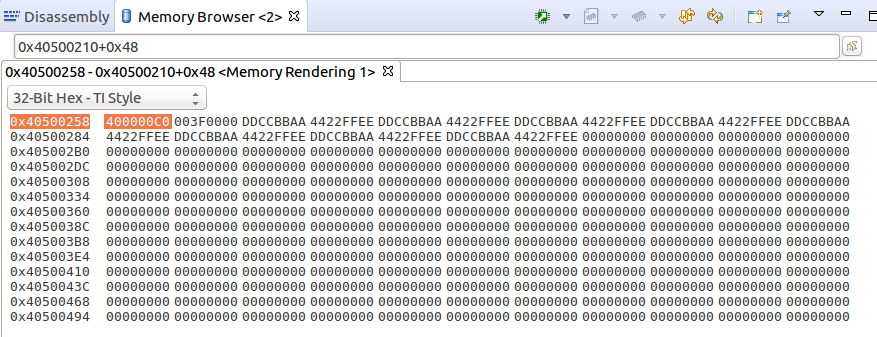

Additional question : Testing CAN application of MCUSW of TDA4_PSDKRA_RTOS(v0.9) in J721EXCP01EVM(Board)
Hi, This is LG member.
The previous questions are replied by .
I have a question and would like to get the explanation against your replies by .
It is a additional question in "Testing CAN application of MCUSW of PSDKRA_RTOS(v0.9) in J721EXCP01EVM(Board)"
Below it is the latest  's answers.
From f2bc02076c31e529882286261a1cb67899ec06f8 Mon Sep 17 00:00:00 2001
From: Karan Saxena <karan@ti.com>
Date: Mon, 23 Sep 2019 13:43:22 +0530
Subject: [PATCH] Add Rx support
"For the first level tests, just copy the message which you were receiving while running the application in Tx mode and use the same message to send to the MCAN in the Rx only case. This is important as the message ID-based filtering happens during the reception of the message and if you send an ID for which the MCU MCAN0 does not have any filter configured - it'll reject it."
After your answer, I asked a question additionally.
I replied like below :
After applying above your patch, the error is happened via your patching.
I just modified for the compiling and finished compiling it.
I wasn't able to understand your test method.
Could you explain your test method in details ?
What i am saying is the CAN communication between EVM Board and CANoe.
I can't receive any response in EVM board because message ID-based filtering.
I don't know how i configure the things, related to ID in CANoe.
Perhaps  would remembers below my question.
Please, need to check this question and explain about these.

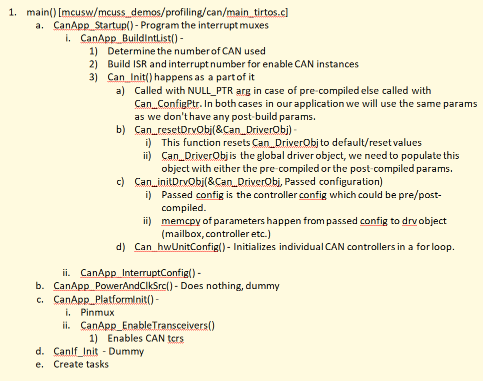

  • I have prepared a summary explaining the can_profile_app main function.
    Please have a look at the following -
    For changing the filter configurations you need to go to the file mcusw/mcuss_demos/mcal_config/Can_Demo_Cfg/output/generated/soc/j721e/mcu1_0/src/Can_Cfg.c

    And then, I checked 1st Rx buffer the in CCS "memory browser"
    I looked at the memory browser at address - (0x40500210+0x48) I saw the message (You said that this is the address of the 1st Rx buffer)
    C00000C0 003F0000 08CC04AA 0011CCEE 00000000 00000000 00000000 00000000
    00000000 00000000 00000000 00000000 00000000 00000000 00000000 00000000
    It is Ok.
    And then,  I also look at the CanApp_RxPdu in the memory browser.
    However,  The values like below in CanApp_RxPdu in the memory browser were weird
    0x97016e60 - CanApp_RxPdu(+0x18)
    CanIf_PduInfo
    97016DA8 00000000
    CanProfileCumulativeTx
    00000000 00000000
    parmbuf
    00000000 00000000
    gSciclient_maxMsgSizeBytes
    00000000
    AppUtils_IsCtrEnabled
    00000001
    CanIf_Mailbox
    *I set the breakpoint like below :
    I try putting a breakpoint before below this function "SemaphoreP_pend"
    • SemaphoreP_pend(CanIf_RxConfirmationSemaphore, SemaphoreP_WAIT_FOREVER);
    I check the value at - CanApp_RxPdu.SduDataPtr (0x41C78024)
    CanIf_SDUDataContainer
    00000000 00000000
    CanApp_RxPdu(including "CanApp_RxPdu.SduDataPtr") were so weird.
    Could you check this values ?
    If I received the message in 1st Rx buffer correctly, I thought that CanApp_RxPdu(including "CanApp_RxPdu.SduDataPtr")  data must be also received correctly.
