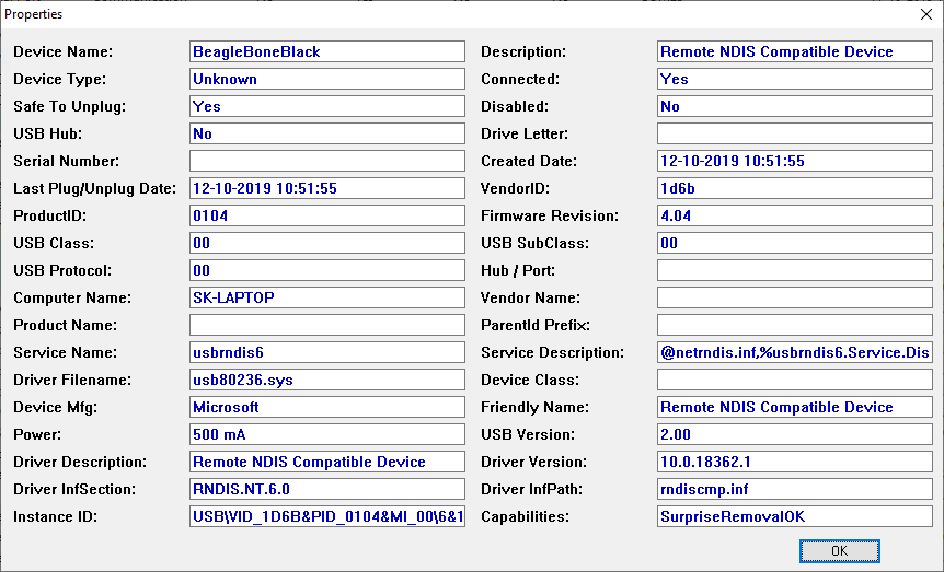

It has been solved, I know because I downloaded it and flashed it to my beaglebone. G_multi exposes all 3 devices over USB (RNDIS, MSC and VSP).
With WIndows10, they need additional OS descriptors to identify the device type. They must have developed some patches to solve the issue in g_multi and g_ether driver modules. The script at /opt/scripts/boot/am335x_evm.sh sets up the devices.

Thanks Bin. FYI, below is the script which fixes the issue:
https://github.com/RobertCNelson/boot-scripts/blob/master/boot/am335x_evm.sh#L482-L593

Yes. The script fixes the issue. I incorporated in my device just the part of the script relevant to me i.e run_libcomposite function (which loads libcomposite driver, u_f_rndis driver, creates a USB gadget, specifies its configuration, adds relevant descriptors and finally binds it to UDC) Having done this, my device when connected via a USB cable to the laptop gets detected as a composite device which provides RNDIS functionality. I didn't need to install any driver... the native Windows RNDIS.NT.6.0 driver works well with my device.
