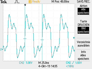

On scope I can see the pin toggling with a pulse with of 50 ns. Now I implemented period timer with interrupt like this:

On scope I still see my pin toggeling with 20 MHz, but each one millisecond there is a large gap.
This is the time where the C66 is hanging out in the timer interrupt.
According to the documentation I expected this gap shall 300 to 500 ns.
But the time where the main loop is inactive is nearly 4 microseconds long!
I also measured the time of execution of SysTimer_Handler(), but this is very short (below 100 ns).
It seems the C66 has an interrupt latency of nearly 4 µs instead of some 100 nano seconds.

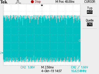

      while( 1 )
        HWREG( SOC_GPIO3_BASE + GPIO_SETDATAOUT)   = 1 << 13;
        HWREG( SOC_GPIO3_BASE + GPIO_CLEARDATAOUT) = 1 << 13;
    As result you can see on scope at pad VIN1AD9 (ball AG2) a endless level toggeling with 60 ns period (30 ns each toggle).
    No gap or interrupt of this process can be detected. Everything is perfect.

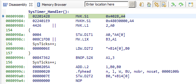

    Here is the assembler code of the timer 3 ISR:

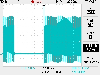

    Now you can clearly see at the scope a gap within the main loop execution, that has been appeared.
    And it is repeated exactly each 1 ms.
    This gap is the time where the main loop is not executed, because it is interrupted by the only interrupt in the system (timer 3 ISR).
    Perfect so far.
    But this gap is 3.8 micro seconds. That is a very long time for a 600 MHz DSP.
    According to the target configuration scripts (see AM57x_PRCM_Clock_GetConfig) there is no doubt that the DSP is working on 600 MHz and no cache miss or DDR3 access can happen. The DSP is running from its local fast SRAM.
    So what is the DSP doing?

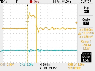

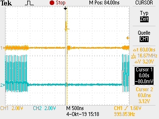

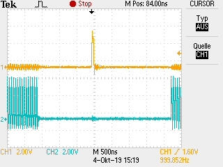

  • On step 3 of reproduction you may install a second GPIO (I used GPIO3_25) to measure the ISR execution time of the short timer 3 ISR.
    The result looks like this on scope. The interrupt execution time is only 60 ns. That matches to the asm code.
    Around the interrupt ISR execution is a dead band of nearly 3800 ns where neither the ISR nor the main loop is executed.
    This are in other words 2200 cycles.
    Previously I thougth this is only IRQ latency (time from exiting main to entering ISR), but now I see a part of this time is also burned after the ISR.
    I can not deal with such a long interrupt overhead.
    Where is it coming from?
    How to eliminate this overhead?

  • Hello Frank,
    thank you very much for reproducing my issue.
    >> Are you including the library file pdk_am57xx_1_0_15/packages/ti/csl/lib/am572x/c66/release/ti.csl.ae66?
    Yes, as reported above I use the library C:\ti\pdk_am57xx_1_0_14\packages\ti\csl\lib\am572x\c66\release\ti.csl.ae66.
    >> I don't yet have proof, but I suspect the problem is with the CSL interrupt handler.
    I'am pretty sure the problem is within the CSL interrupt handler.
    I will follow the E2E thread you found. The problem described there is the same and I will reproduce the solution from this thread.
    I guess this will solve my problem.
    Thank you very much for your great support.
    Regards Dirk.
