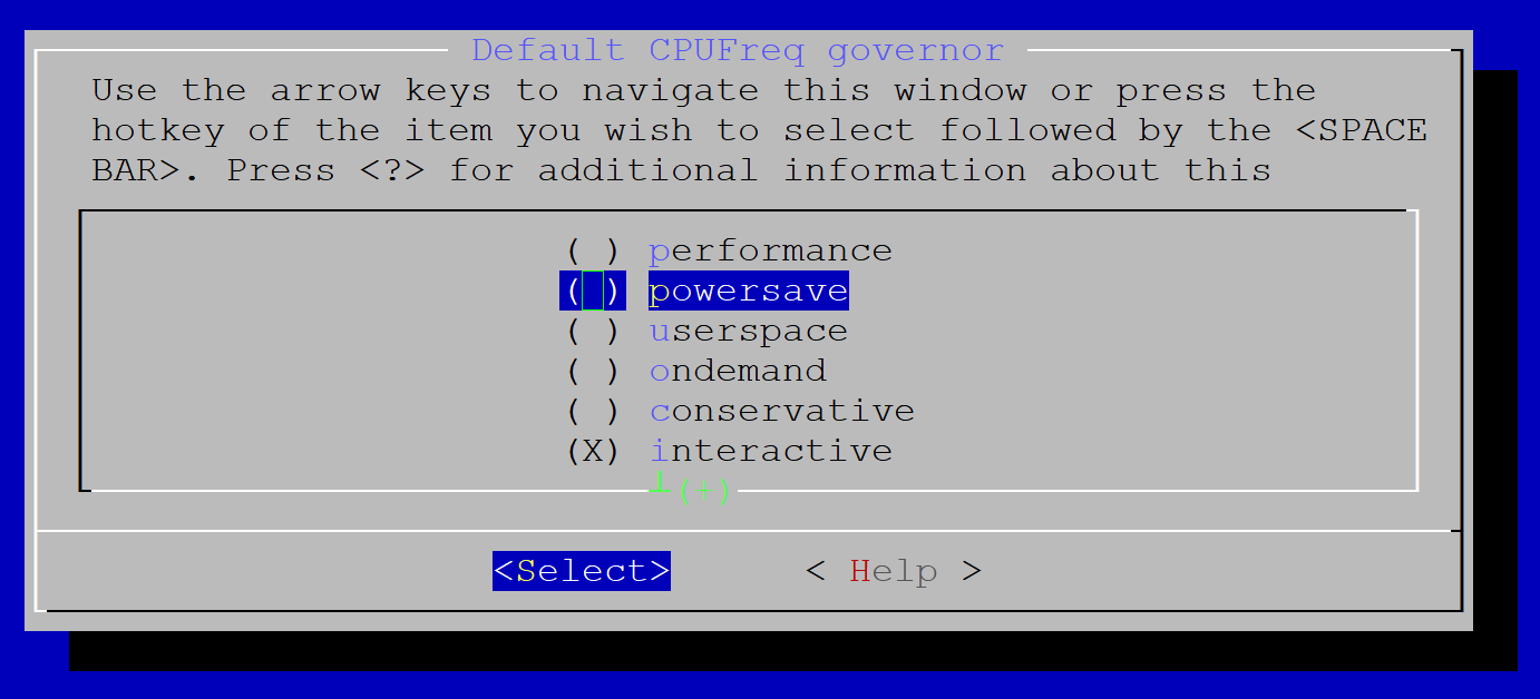

  • Hi Vishal,
    Yes, there difference between DTS files is OK. After our main input (VBAT) we have two branches: a 12V regulator, and the TPS43351 (the same as EVM) to output the 5V & 3.3V.
    Could you do a test by changing the CPUFreq governor in Kernel to "performance" as default?
    This will disable OPP switch from Kernel and stay with one OPP through out.
    CONFIG_CPU_FREQ_DEFAULT_GOV_PERFORMANCE
    Vishal
  • Hi Vishal,
    Issue still reproduced by enabling CONFIG_CPU_FREQ_DEFAULT_GOV_PERFORMANCE.
    Chokri
  • Hi Chokri,
    Based on the behavior that issue is not seen when you comment out buck10 or oppdm_mpu suggested that the issue could be due to MPU OPP switch done by Linux. When you don't have these entries then there is no OPP switch.
    The experiment above was suggested to keep a fixed OPP.
    We are discussing further with the team for other suggestions.
    Vishal

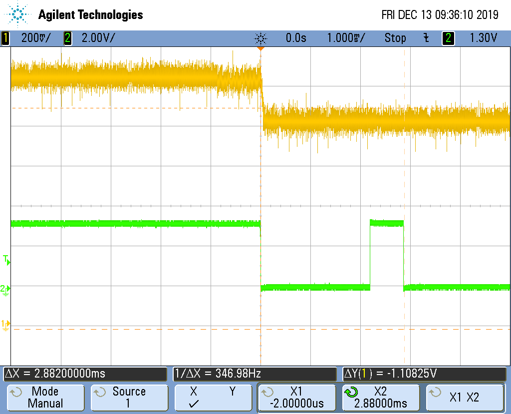

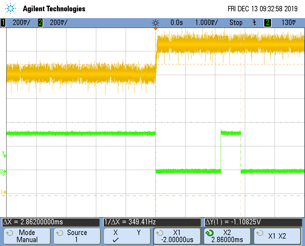

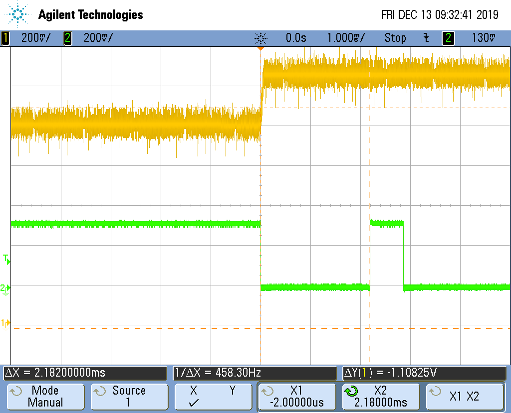

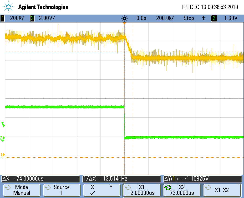

  • Hi Alejandro,
    Thank you for having confirmed that lowering the I2C3 frequency to 100 kHz did not improve things.
    Could you please probe vdd_mpu along with rstoutn? We would like to see the timing relationship between the changes of vdd_mpu (the various values mentioned in former posts: 1.13 V, 1.222 V, and 1.180 V) and the reset condition? Thank you.
    François.
  • Hello Vishal and François,
    Here there are the timming captures (green rstoutn, yellow vdd_mpu)
    Best regards.
  • Our PMIC engineer is not available this week, we will get back to you on Monday.
    We checked the oscilloscope snapshots and it seems like RST is happening not right after the voltage increase.
    Could you please give us the i2c register dump of the PMIC. So that we can check all the settings related to voltage regulator.
    Vishal

  • Hello Roxu,
    I am looking at the very first oscilloscope snapshot. VDD_MPU(Yellow) is at around 1V tries to get to 1.2V.
    The RST line is going down. Is that during the first power on? How is the yellow line already at 1.0V?
    Shouldn't the vdd_mpu be at 0v before power on? I am trying to understand the snapshots
    and the behavior or voltage w.r.t rstoutn line.
    - Keerthy
  • Hello Keethy,
    .What do you mean with "before power on"? As rstoutn is up, the power is on...
    What you are seeing is the error sequence we are facing. When the system power up first time, it starts OK. U-boot works fine and then kernel is launched. Once in kernel, the AVS sytem tries to update vdd_mpu. But when trying it, a reset condition is generated and the CPU resets... The power on vdd_mpu voltage is depending on the last configuration of PMIC, that's why sometimes the reset condition is generated when vdd_mpu rises and some times when goes down. This becomes a infinite loop of restarts.
    Best regards.
  • Hello Roxu,
    Okay understood so mostly any interaction with pmic voltage setting is causing a reset.
    So that is indeed a behavior not seen on J6 plus which has PMIC on i2c1.
