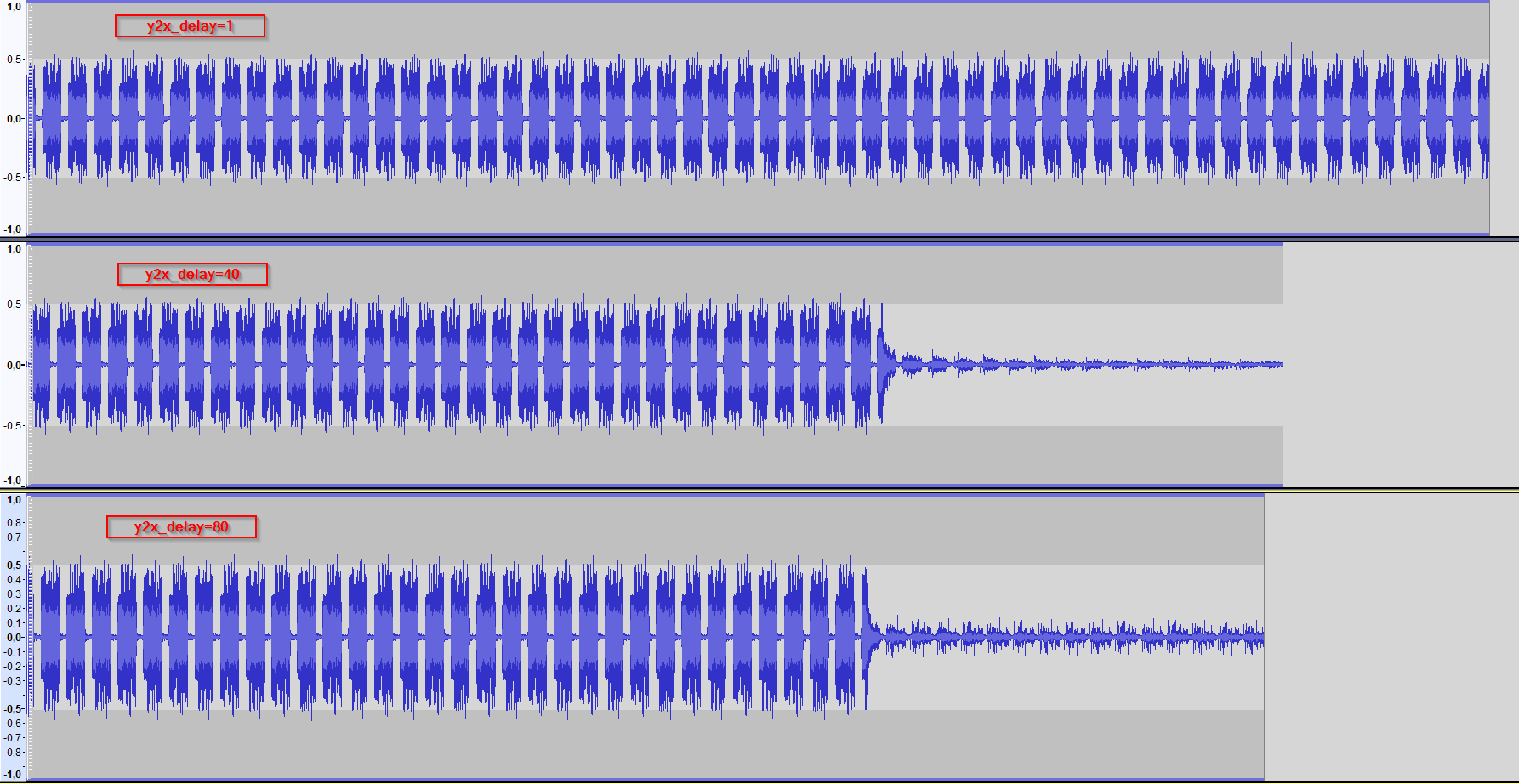

  • Hi Marc,
    y2x_delay can be set to 0 through aerOpen(). Apparently aerControl() doesn't take 0 value, but that's not a big deal. Setting it to 1 has almost same effect.
    Your system not converging with y2x_delay as 1 may be due to too many leading 0's in the tail model. Please refer to section 7.1 of the quick tuning guide.
    When you set y2x_delay to 40, you saw max_canc_l2 and curr_canc_l2 between 5 and 8. That means there was convergence of 15 to 24dB. Are you able to capture the send path signal as described in section 5.1? If the send path output signal looks like figure 5 when AER is enabled but NLP is disabled, then you have confidence that your system is converging.

    thanks for our response. I did some measurements as described in the Quick tuning guide in chapter 5 "Convergence verification".
    The AER instantiation and parameters are shown here:

    The following command sequence was executed and the raw data of send out was captured.
    // Set volout
    dp:volout 50
    // Set y2x_delay to xxx
    dp:aerpdez 3 xxx
    // Drop high band tx/rx, FDNLP On
    dp:aerphex 1 0xFFFFC040
    // Disable aer, nlp, cng tx/rx
    dp:aerphex 0 0xFFFF0088
    // Play sample 1
    dp:simmod 1
    // Enable aer
    dp:aerphex 0 0xFFFF00AB
    dp:aerphex <aa> <bb>
    aa: Parameter ID (0=Modes 0 Bitfield, 1 = Modes 1 Bitfield,....)
    bb: Upper 16 Bits=Mask, Lower 16 Bits=Value
    The send out data for different y2x_delay's looks like this:
    Corresponding AER Debug data is here:

    Questions:
    1. Is the main instantiation and parameter init ok (see AER_Parameters.txt)?
    2. Is this a good starting point for going on to chapter 6 "Main Nlp Parameters Tuning"? We could start with y2x_delay=40?!
    3. Why does coherence state of aer debug data start with 0 and then switch to 1 and stay at 1 (see Stats.txt files)?!
    4. What does parameter nlp linear attenuation in aer debug data mean (see Stats.txt files)?
    Thanks for your efforts
    Marc
  • Marc,
    Please see my response below:
    The default value of "nlp_combloss_target" is meant to have heavy attenuation. Since your convergence looks good, you should increase it to e.g.  8192 (12dB attenuation). Please refer to API documentation regarding this parameter.
    Yes.
    This means it is looking for coherence event which is usually caused by echo path change, e.g. moving the phone.
    Please refer to documentation of parameter "nlp_combloss_target".
    Jianzhong
