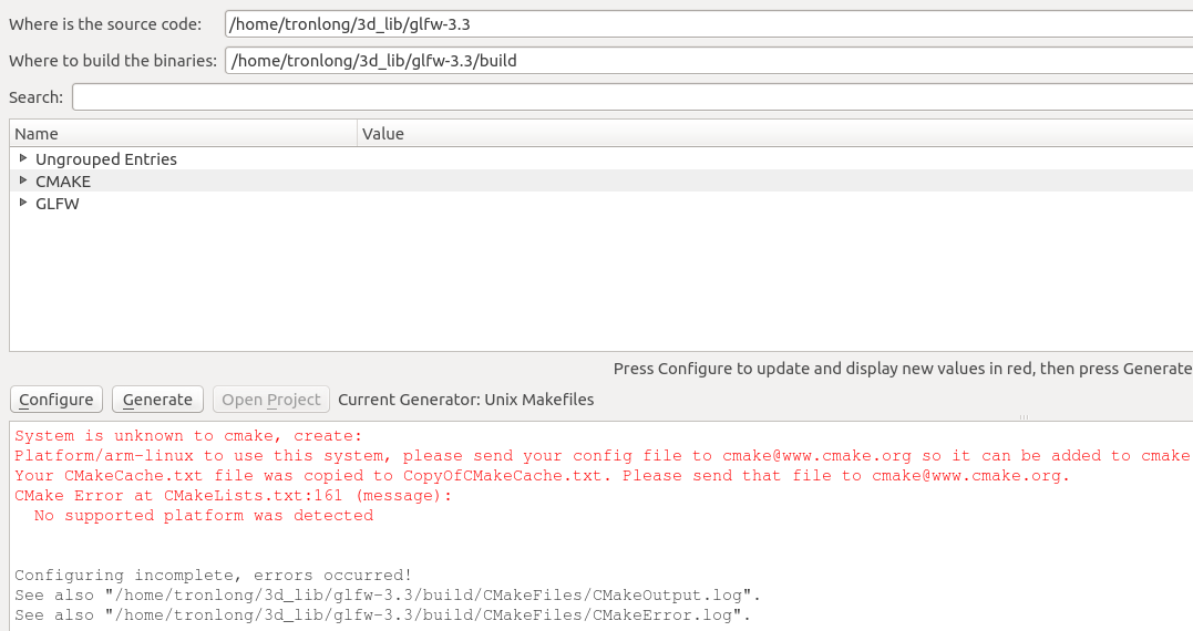

I want to use the glfw library on the am5728 (kernel, run linux operating system) chip on the am5728 (mv7, run the linux operating system) and cross-compile on Ubuntu using the cmake-gui, The compiler is arm_linux_gnuabihf. Prompt: system is unknown to make, is the use of glfw not supported on arm linux? If I want to use, what should I do, thank you!

    2) On the official website of the glfw, no support for arm linux is found. In the CMakeList.txt file of the
    glfw software package, only the support for linux is found, and the compile option of the arm linux is not found.
    The following error is prompted when using the CMAKE compilation:
    how do you compile it? Do you need to modify any file? Thank you!
    Based on my discussion with our experts, GLFW is not supported.
    Krunal
