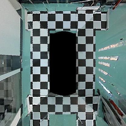

        Thanks for your reply! We are developing SRV feature now, we have found method to solve geometric stitching seamless, but do not know how to embed photometric stitching seamless algorithm into TDA codes. If you have deprecated photometric alignment algorithm, how do you solve solve geometric stitching seamless of SRV?Or is there some API in TDA codes we can develop our photometric stitching seamless algorithm of SRV?Our test  of SRV  is as follows:
        Can you tell me how to solve this problem?Look forward to your kind reply.
    Yongji
    We only provide reference demo software and expect our customers to develop their own algorithms. There are also several 3rd parties who can license algorithms for a certain licensing fee which is paid by the customer and typically requires an agreement between the customer and the 3rd party.
    At this point, we don't have any plans to develop a photometric correction algorithm.
