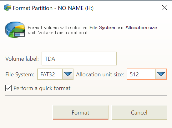

    >when you are preparing the SD card are you making sure there is an MLO file for the SBL and the SD card is formatted with FAT32 and has the boot flag set?
    Yes, of course.
    * I used format partition tool  and confirmed allocation size and file format as shown below.
    * I copied MLO from below after building.
    PROCESSOR_SDK_RADAR_03_07_00_00\vision_sdk\binaries\apps\tda2xx_cascade_bios_radar\sbl\sd\opp_nom\tda2xx-cascade-radar
    And also copied app file from below.
    PROCESSOR_SDK_RADAR_03_07_00_00\vision_sdk\binaries\apps\tda2xx_cascade_bios_radar\vision_sdk\bin\tda2xx-evm\sbl_boot

    * When I followed "Load using SD card" to create SD card(I just changed label from "SD_BOOT" to "TDA"), I saw following partion.
    I think that partition is created "boot" and "rootfs" in general case.
    Is above expected format result ?
    Machida
  • Machida-san
    The partition looks correct. Can you please double confirm the boot flag as well?

  • Hello Piyali-san,
    Today, I could confirm boot up.
    The root cause was below.
    * Previously, primary partition is not set as active.
    (When I created SD card by using active partition manager, I did not perform "set ACTIVE")
    My issue was resolved however I would like to know how I can confirm boot flag for the future.
  • Hi Machida-san
    Glad you were able to set the SD card partition to active.
    On Ubuntu using Gparted is the easiest way to check if the boot flag is set.
    "In gparted you click on a partition and right click set flags. You can also use Disk Utility or command line.
    set boot flag on for sda2 (off for others)
    sudo sfdisk -A/dev/sda"
    On Windows, I believe there the disk part only allows to set the parition to active. A quick google search gave me this link. Copying it here for anyone else to refer to http://www.spradlike.com/blog/2012/02/17/checking-active-partition-windows-7/
