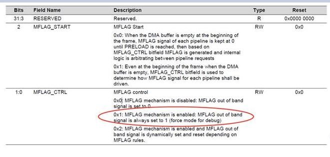

  • Hi Experts:
    Compare old SDK and 3.07 SDK.
    change 0x5800185C from 0x6 to 0x5. The problem resolved, LCD flicker disappear.
    Question 1: Setting GLobal MFLAG to debug mode, Does it have risk?
    Question 2: Could you please tell me why 3.07 RDK add those modify MFLAG's code like below picture?
    Best Regards!
    Han Tao
    1. change MFLAG to debug bit
    2. RDK default setting code at display link
  • Hi Team:
    Please check the feedback about setting MFLAG to 0x5 and 0x6 different.
    Question 1: 0x5 means DSS always on. There is no risk in setting MFLAG to always on mode. This essentially means display always gets priority, even if display internal FIFO have sufficient data.
    Question 2: change 0x5 to 0x6 reason is  we have set the display FIFO thresholds such a way that we could enable dynamic FIFO. Could you also please check if FIFO thresholds are setup correctly? If they are not set, dynamic MFLAG may not work.FIFO threshold is set in the register MFLAG_THRESHOLD. We believe Dynamic MFLAG is a better way to go with the thresholds tuned for the usecase 50% and 75% have been found to be good for most applications.
