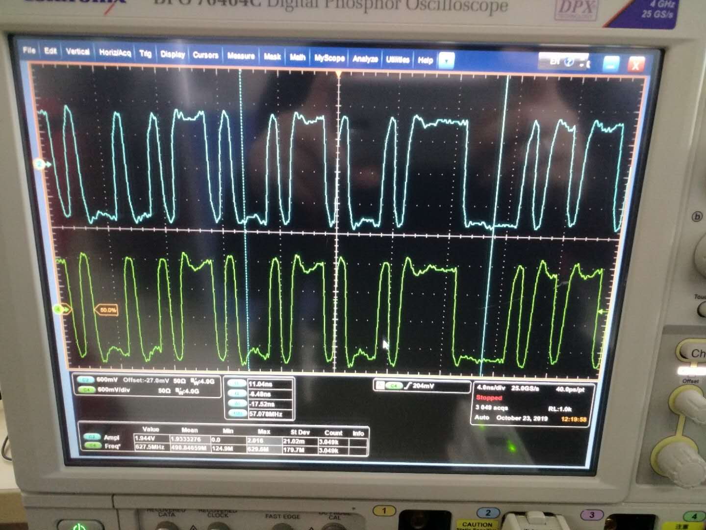

whenn 4x ok, lane0 and lane3 DspTx signal waveform ,  Sync & Skip(k28.5 k29.7) data pattern can be  found

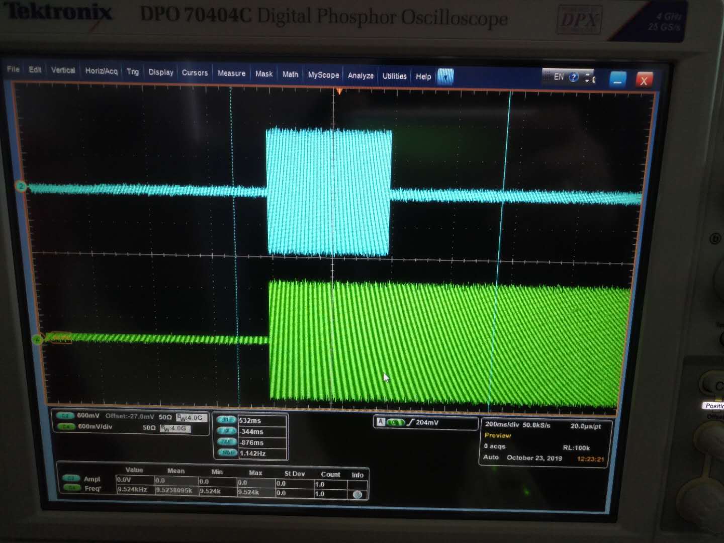

whenn 4x fail, lane3 and lane0 DspTx signal waveform  ,  lane3 has active signal  400ms , then no signal (here srio discover timer value 0xf),  (if srio discover timer value =0x2, signal presents for about 32ms )
when waveform of lane3 expanded,  k28.5 k29.7 data pattern can be  found , and the siganl qualitity looks fine

    I thought FPGA would wait a long time for init,  but it looks like that there is  a shorter allowed time window, and DSP miss the window due to the time delay.
    Always lane1 and lane3 fail?
    RapidIO spec Part6, 1x/Nx_Initialization State Machine ,
    when in 4x mode, lane0 is the main lane, and lane2 is the redundant lane, they will start sync together  at 'SEEK' state, and in my project success(other lane is shut down), so lane0 and lane2 ok first
    then  lane1 and lane3 will start sync at 'DISCOVERY' state, and timeout occurs here because the time delay.  lane1 and lane3 fail.
    So I gone the wrong way, the communication quality of the lanes themselves are ok.
