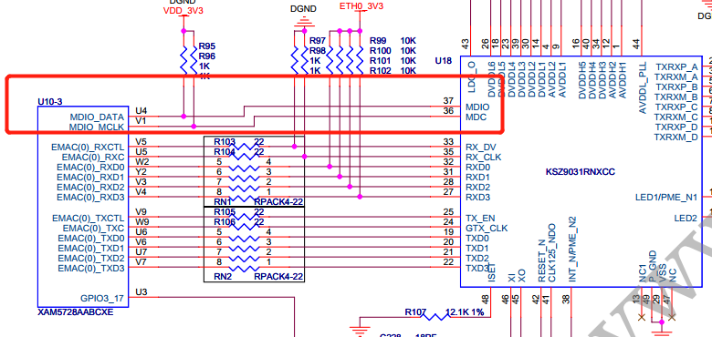

I connect to the 9031 chip through the MDIO_MCLK pin.
Below is the relevant schematic:
The pin configuration is as follows:
{MDIO_MCLK, (M0 | PIN_OUTPUT | SLEWCONTROL)}, /* mdio_mclk.mdio_mclk */
{MDIO_D, (M0 | PIN_INPUT | SLEWCONTROL)}, /* mdio_d.mdio_d */

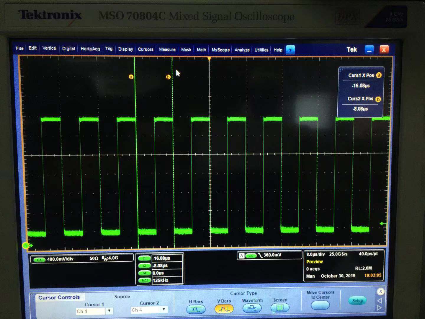

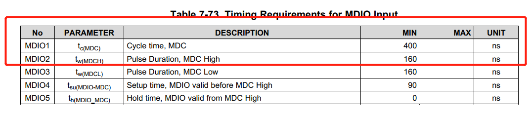

The manual states that the MDIO_MCLK pin frequency is supported up to 2.5Mhz.
But the frequency I measured with an oscilloscope was only 125K.
Is this because of what caused it? How can I make the frequency reach 2.5Mhz.
