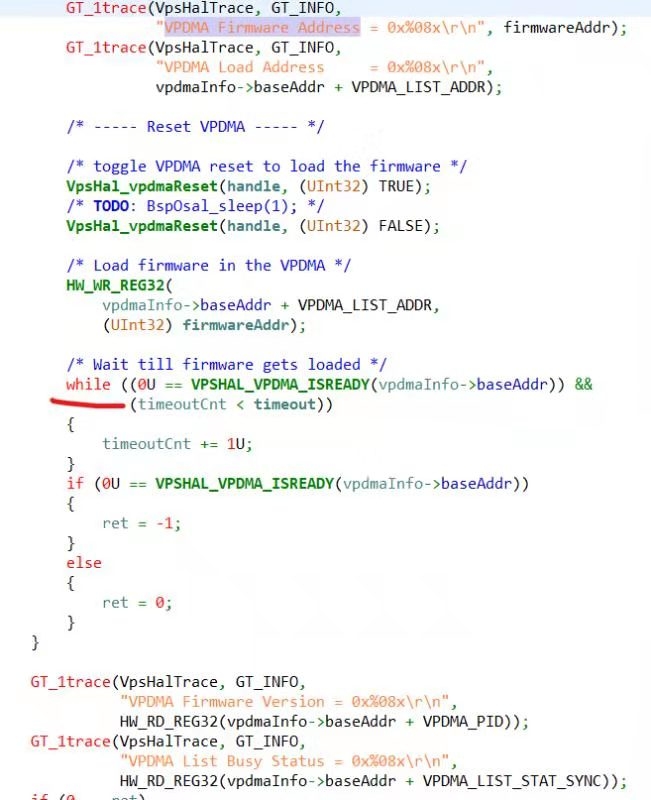

Program hangs in VPDMA Firmware loading
Figured out hanging on the line of while of vps/src/vpslib/hal/src/vpshal_vpdma.c in below snapshot:

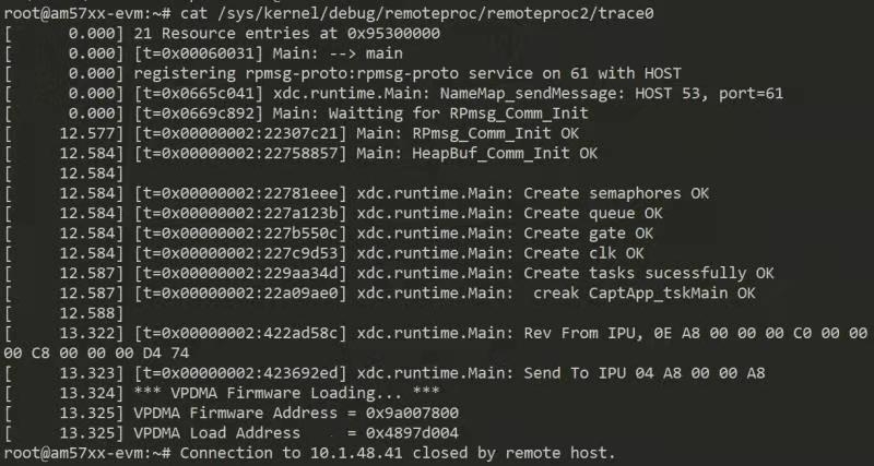

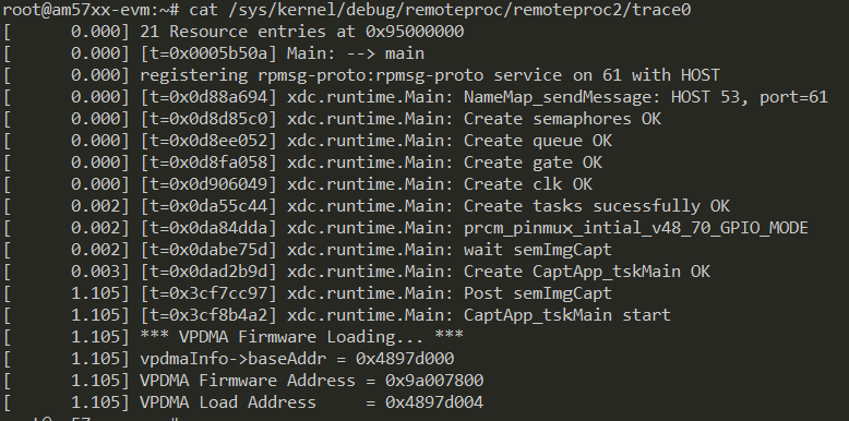

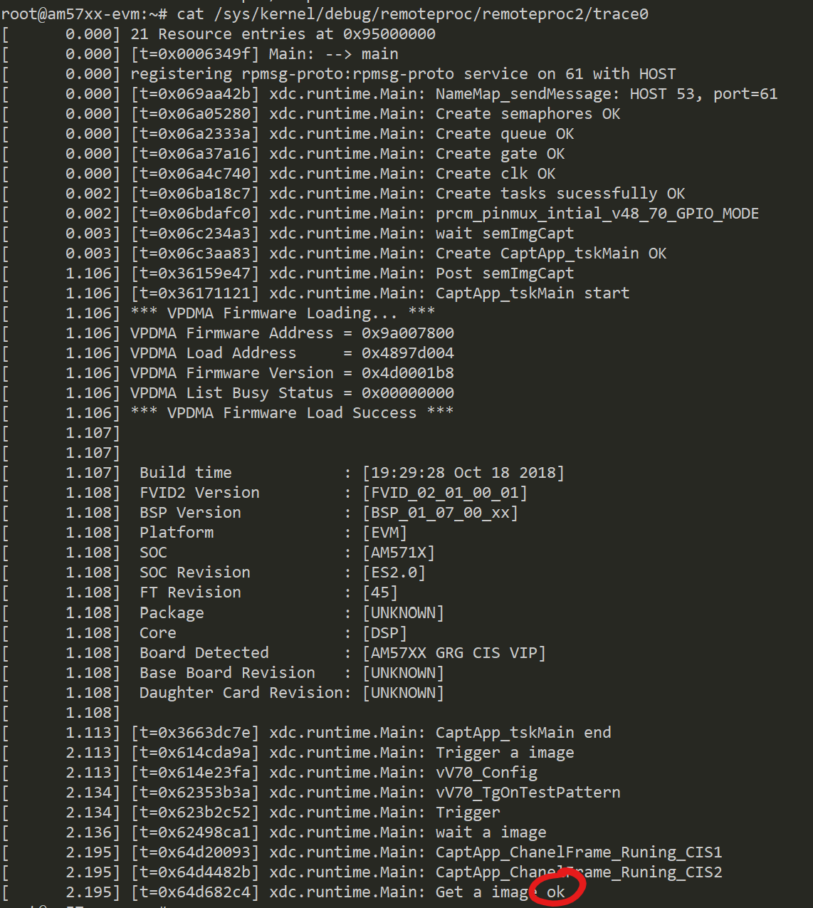

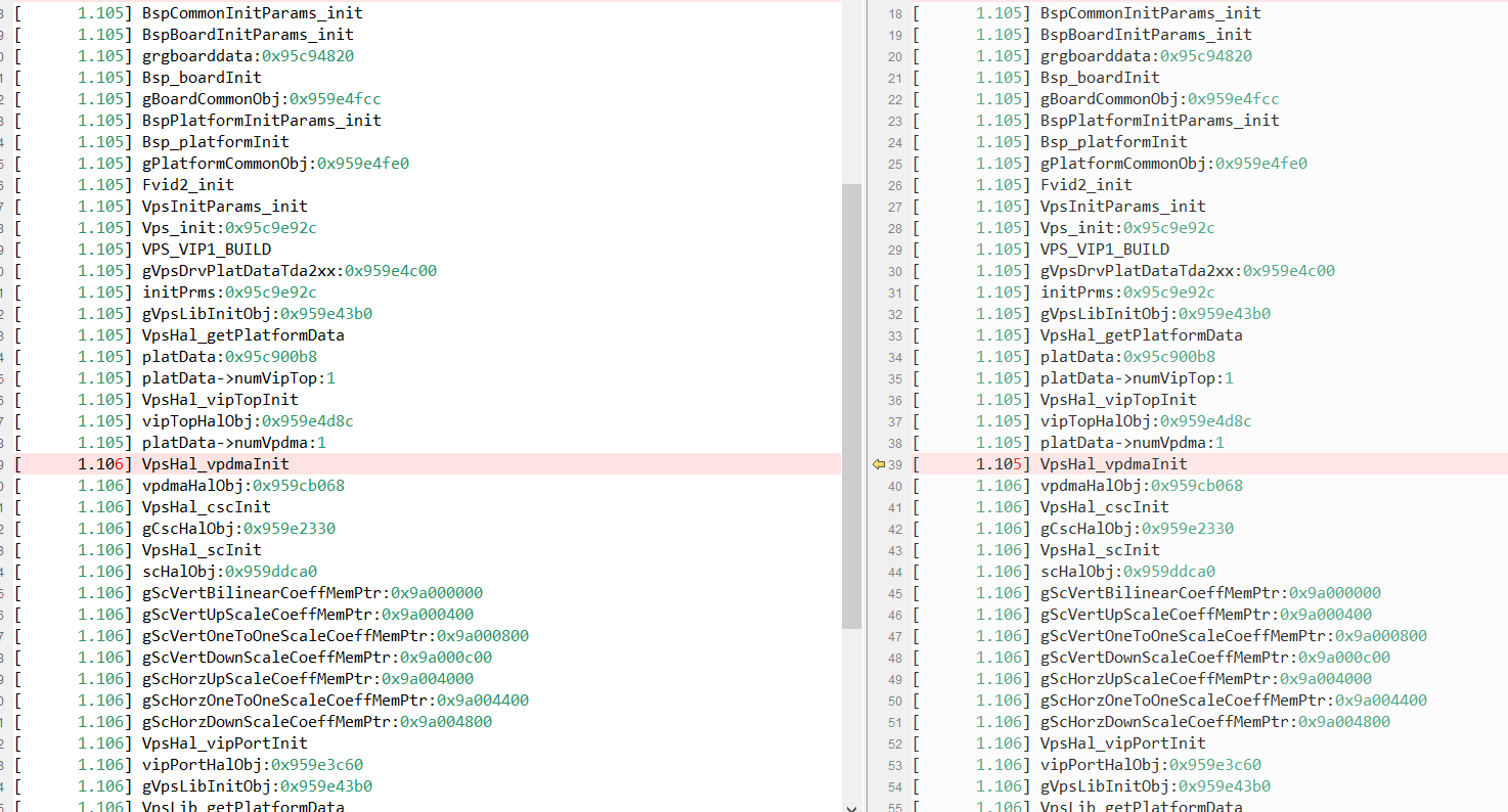

  • Hello Sahin,
    I've modified the DSP project, It can do vps job itself, No need the core A15,Ipu etc...
    Then I test the 7M memory, there is log below, vps gets image ok:
    After expanded to 8M, there is log below, I added a log about vpdmaInfo->baseAddr, the value is 0x4897D000, but still not work:
    This test must use GRG base board. Because the image upload depend on the IC ht82v70.

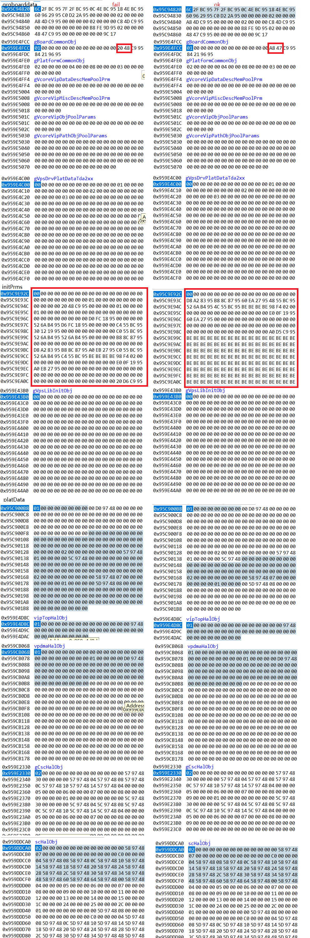

  • Hello Sahin,
    I loged all the global/static parameter address as below, it shows the address are all equal:
    even the data of all the parameter are mostly the same:
    I have no more idea about this issue now, please help.

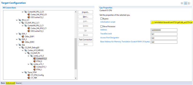

    Can you please ask the customer to check this for me:
    After loading and running the DSP via Linux remoteproc, connect to the device via CCS but do not run any GEL files (the device has already been initialized by Linux at this point so running a GEL file will be destructive). They will need to remove the GEL files from the Advanced tab in the target configuration as shown below.
    Once connected to the DSP core, load only symbols, and check ROV for any errors (Tools > ROV Classic > BIOS > Scan for Errors).
    Please let me know what they see.

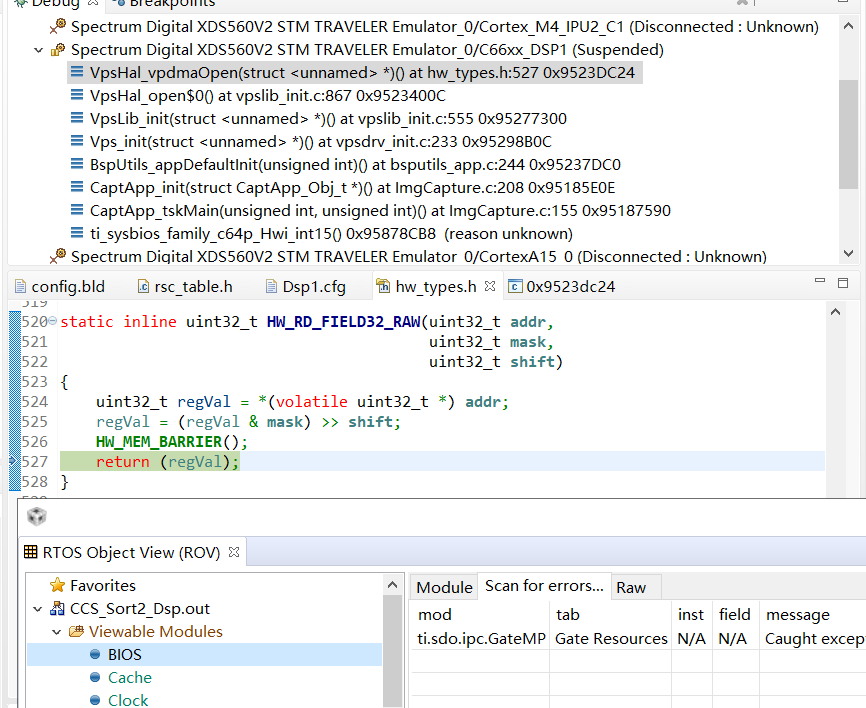

  • Hello Sahin,
    I think sending a final PCBA to you will speed up to resolve the problem.
    I've tested edit .cfg file Cache.setMarMeta(0x95000000, 0x0B000000, 0 );
    But it not work. Maybe it's not relative about cache?
    When using ROV Scan for Errors, there is screenshot shows below, message:
    Caught exception in view init code: Problem fetching remoteSystemInUseJavaException: java.lang.Exception: Target memory read failed at address: 0xbfc00300, length: 256This read is at an INVALID address according to the application's section map. The application is likely either uninitialized or corrupt.
