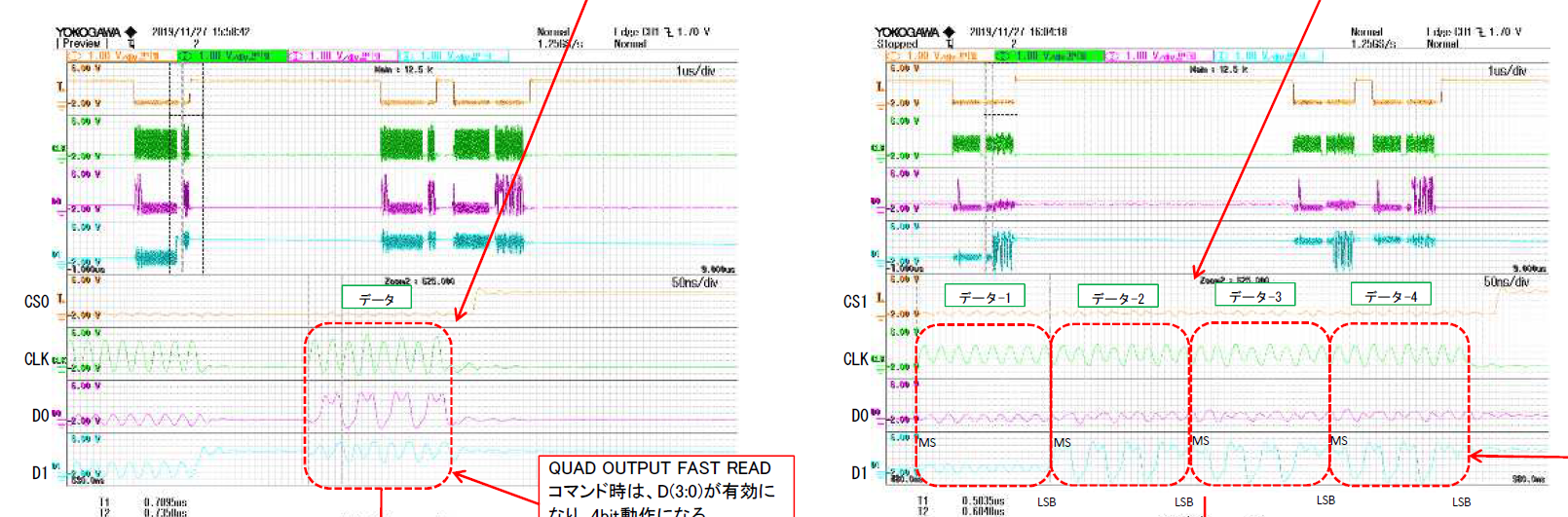

    Question 2:
    Also, we captured the waveform of the QSPI signals (CSx, CLK, D0, D1).
    For CS0, the QUAD OUTPUT FAST READ command (6Bh) is seems to be executed. (The left waveform)
    However, for CS1, the READ command (03h) is seems to be executed. (The right waveform)
    (The right wave read the data with 1bit data line, while the left waveform read the data with 4bit data line)
    Although we execute the same command (sf read) for each CSx, do you have any idea for this difference?
    Nomo

  • Hi Nomo-san,
    Nomo said:
    Question 1:
    As a result, we could find read data is shifted by 1byte.
    This  could be an issue related to dummy cycles getting used during certain transactions (not configured correctly).
    Nomo said:
    Question 2:
    As you found the controller operates only in 1-bit mode for CS1. This behavior is usually specified through the device tree spi-tx-bus-width and spi-rx-bus-width properties associated with a certain memory.
    Can you please share your full device tree additions for "&qspi"? This will allow us to further analyze both of these concerns.
    Regards, Andreas
  • Hi Andreas-san,
    Thank you for your reply.
    We can find the cause for this issue.
    QSPI_SPI_SETUP1_REG was not set when the CS1 access.
    So, we modified the following points.
    Could you tell us the correctness for the modification?
    1.We add the following code at the next line of "writel(memval, &priv->base->setup0);" in the ti_qspi_setup_mmap_read function in ti_qspi.c
      writel(memval, &priv->base->setup1);
    2.We add the following code at the next line of "writel(0, &priv->base->setup0);" in the ti_qspi_release_bus function in ti_qspi.c
      writel(0, &priv->base->setup1);
    Nomo
  • Nomo-san,
    Sounds like your debug efforts were successful and you got it working? That's really great!
    I had another look at the ti_qspi.c driver code. Yes the modification you identified will fix the issue with the mode not getting configured correctly for CS1 however as you can probably guess there are some limitations to this specific approach:

    I have attached a updated PATCH that has this above change integrated. If you don't mind, it would be great to try this one more time. Thanks again for your help.
    Regards, Andreas
    https://e2e.ti.com/cfs-file/__key/communityserver-discussions-components-files/791/0001_2D00_spi_2D00_ti_5F00_qspi_2D00_Fix_2D00_issues_2D00_when_2D00_accessing_2D00_CS_2D00_other_2D00_than_2D00_v2.patch
  • Hi Andreas-san,
    Thank you for an update PATCH.
    We've tried the patch and confirm we can read/write data from/to the SPI flash connected to CS1.
    Nomo
  • Nomo-san,
    thanks again for the extra effort with helping to test our patch!
    Regards, Andreas
