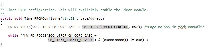

I was trying to calculate the execution time of a task running inside M4 with bare-metal code(No- OS), how I can do that.
I tried with example provided in C:\ti\pdk_am57xx_1_0_15\packages\ti\csl\example\timer\timer_app\main_m4.c  by using timers, but I am getting huge time period values. And I am getting 120 clock ticks for 2 successive TIMERCounterGet calls, why this much of huge values? Is any thing I am doing wrong?
SYS_CLK1 is the clock signal for the timer and in IDK board it's 20 MHz.
Below are the steps I have followed:
1. Started a timer4 with 60 sec timeout in interrupt mode
2. Reading the TIMERCounterGet before and after the task  execution, and calculating the number of clock ticks for executing the task
3. Calculating the time period from the difference in clock ticks,
time period = (clock ticks * 0.05 Micro sec)
As frequency is 20 Mhz, one clock tick will be 0.05 Micro Sec.

** Timer4 PRCM configuration. This will explicitly enable the Timer4 module.
static void TimerPRCMConfigure(void)
    HW_WR_REG32(SOC_L4PER_CM_CORE_BASE + CM_L4PER_TIMER4_CLKCTRL, 0x2);
    while ((HW_RD_REG32(SOC_L4PER_CM_CORE_BASE +
                        CM_L4PER_TIMER4_CLKCTRL) & (0x00030000)) != 0x0) ;
