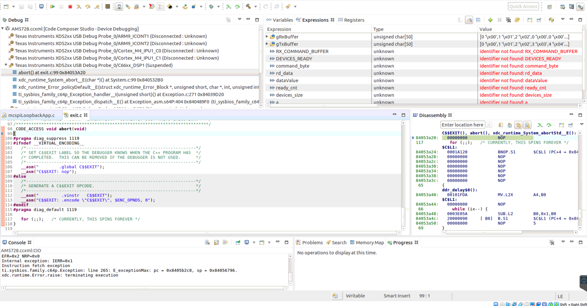

I am using the mcspiLoopbackApp example. I then wrap a loop around the
SPI_transfer(gSpiHandle, &transaction);
The loop sends a SPI_transfer around 4000-5000 times before the following error occurs.
Exception at 0x0
EFR=0x2 NRP=0x0
Internal exception: IERR=0x1
Instruction fetch exception
ti.sysbios.family.c64p.Exception: line 265: E_exceptionMax: pc = 0x8405b2c8, sp = 0x84056796.
xdc.runtime.Error.raise: terminating execution
This seems like a memory error. I have attached my code so you can reproduce this issue.

    Screenshot attached at time of error

    This is what was printed out to the console:
    [C66xx_DSP1] A0=0x0 A1=0x0
    A2=0x0 A3=0x8
    A4=0x8404d660 A5=0x1000
    A6=0xbd A7=0xbf
    A8=0x84056f45 A9=0x84000fbc
    A10=0x18000a8 A11=0x1800048
    A12=0x1800040 A13=0x84043d88
    A14=0x840012ec A15=0x2
    A16=0x84056f18 A17=0x84056f02
    A18=0x84056eea A19=0x84056dd2
    A20=0x0 A21=0x0
    A22=0x84056d74 A23=0x84056d52
    A24=0x84056d35 A25=0xb1c0e6c0
    A26=0x91d1e6be A27=0x3a0b02c9
    A28=0x3 A29=0x84050660
    A30=0x84057b18 A31=0x0
    B0=0x400 B1=0x0
    B2=0x1 B3=0x840449ac
    B4=0x1f B5=0x0
    B6=0x0 B7=0x40
    B8=0x18000a8 B9=0x1800048
    B10=0x84000000 B11=0x40
    B12=0x84000000 B13=0x40
    B14=0x2 B15=0x8405668f
    B16=0x8405b338 B17=0x840489f0
    B18=0x84001260 B19=0x1e
    B20=0x84056de2 B21=0x1
    B22=0x84053364 B23=0x8405b340
    B24=0x1 B25=0x84039a38
    B26=0x8405b2c8 B27=0x2
    B28=0x84056701 B29=0x58b3533
    B30=0x84056726 B31=0xffef
    NTSR=0x8405b2c8
    ITSR=0x0
    IRP=0x0
    SSR=0xffffffff
    AMR=0xffffffff
    RILC=0x0
    ILC=0xfffffffe
    Exception at 0x0
    EFR=0x2 NRP=0x0
    Does that provide any insight?

  • Thanks for verifying this Frank! I look forward to hearing the development team's response.
  • Andre,
    I've filed a bug with the development team. I'll keep you posted.
    Frank
