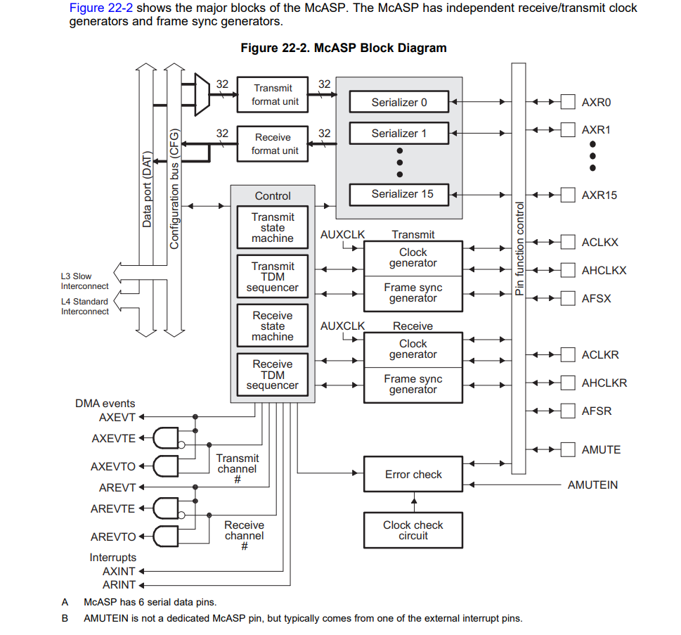

  • Hi Krunal,
    I am not sending audio all the time, so yes MCASP is turned off, but I just want ACLK and FSYNC to be on in MCASP and use AXR pins for Tx and Rx only when audio is transmitted.
    I want MCASP to send 512KHz BCLK and 8KHz FSYNC all the time. And when audio aplay or arecord is executed, only then use Tx and Rx pins.
    In this block diagram from AM335x TRM, maybe I can only turn on Transmit TDM sequencer to generate ACLKX and AFSX?
     Since I know my BCLK and FSYNC frequencies maybe I can just put those values in davinci-mcasp.c to generate those frequencies?
    If this is not possible, is there any other option to approach this problem?

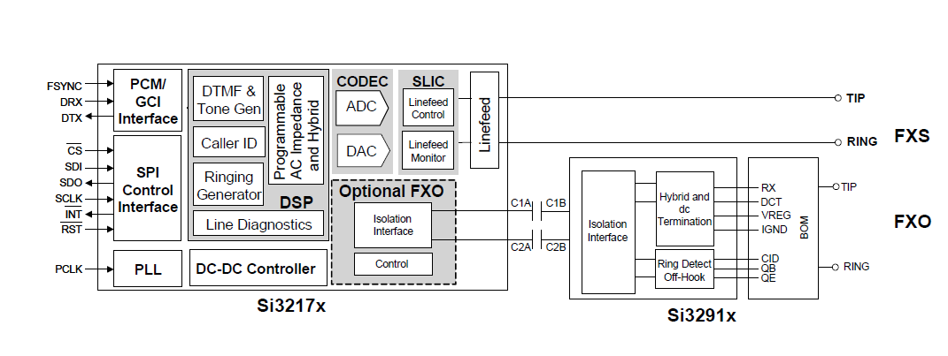

  • Hi Krunal,
    My application is to interface FXS/FXO using SiLabs Si32178 with AM3358 on a custom board. So its pretty much a VOIP phone, which can connect to an analog phone line using FXS/FXO ports. In VOIP, the audio in my case will always be 8 bit 8000Hz.
    SiLabs Si32178 has PCM and SPI interface to connect to a microprocessor. I have SPI and PCM/TDM device tree setup which you can see in my previous posts:
    https://e2e.ti.com/support/processors/f/791/t/862363#pi320966=1
    https://e2e.ti.com/support/processors/f/791/t/842530
    Si32178 needs BCLK and FSYNC to generate its internal clocks, and without a constant BCLK and FSYNC coming from the microprocessor it can not function. Even SPI on Si32178 will not work without BCLK and FSYNC.
    Currently with my setup I can see Si32178 as an audio Capture and Playback device on AM3358 and when I play an 8 bit, 8000Hz audio, I can see my desired BCLK and FSYNC going to Si32178 but as soon as audio is stopped, BCLK and FSYNC clocks go away.
    So I need a constant BCLK and FSYNC output from AM3358 all the time even when no audio is being played or recorded. Is it possible?
    Here is block diagram of Si32178:
    In the block diagram, BCLK is referred as PCLK.
    Hope I was able to make things clear.
    Thank you,
    Samer
