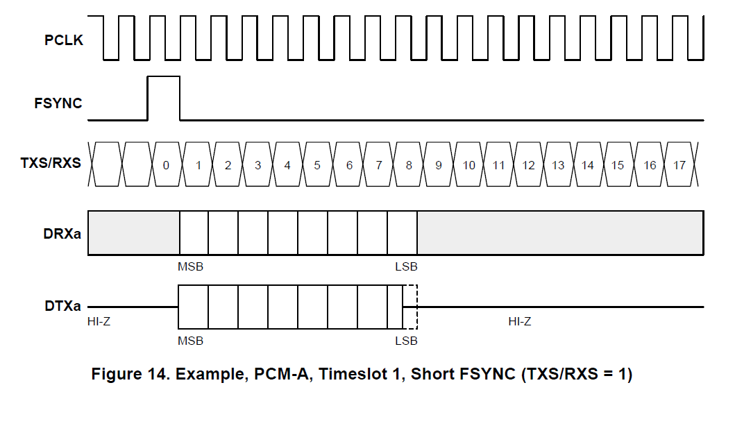

  • Pavel Botev said:
    Could you please clarify if PCLK is bit clock (BCK) or master clock (MCLK)?
    Datasheet for Si32178 does not mention if PCLK is a bit clock or master clock. Basically Si32178 needs the external PCLK to generate internal clocks that are essential for proper functionality and synchronization of audio transmission as well.
    On Si32178, I have following 4 pins for PCM: PCLK, DRX, DTX, FSYNC.
    PCLK needs to be in the range mentioned in my initial post. FSYNC needs to be 8kHz.
    Here is a snapshot from Si32178 datasheet for PCM:

  • Samer,
    From this description and from Figure-14 that you shared, seems to me PCLK is bit clock.

    From all these threads and documents you mentioned, it seems like I will have to define my audio route and widgets in codec file first and then mention that in dts.
    Silicon Labs voice chip that I am using needs BCLK and FSYNC all the time once the chip is powered on. How can I have BCLK and FSYNC going on all the time through MCASP? Is it possible?
    Because right now I only see BCLK and FSYNC when I execute aplay or arecord commands.
    Thank you,
    Samer
