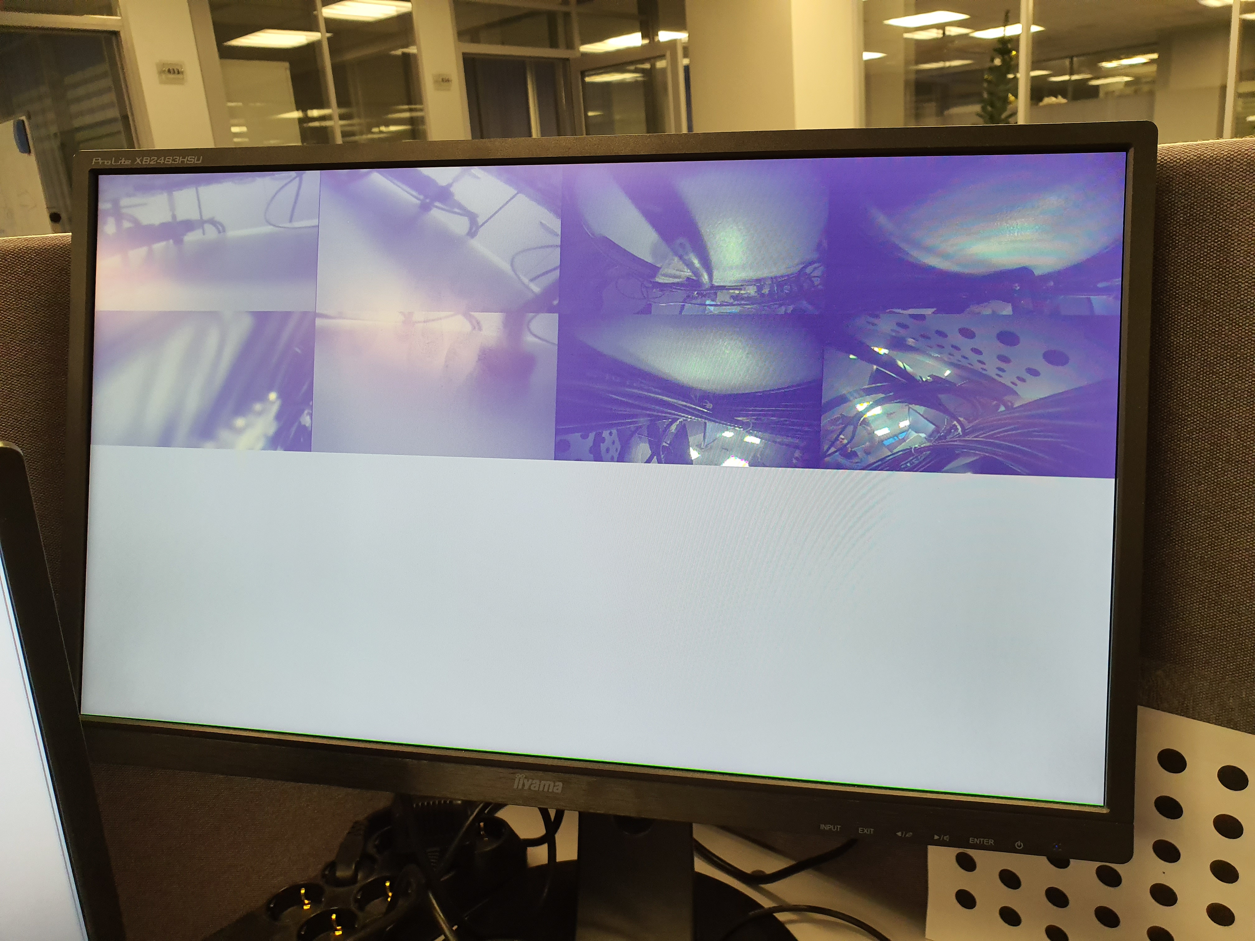

We have successfully connected 8 cameras to TDA2P-EVM using both CSI2 ports (4 cameras to 'csi2_0' using 4DL mode and 4 cameras to 'csi2_1' using 2DL mode).
Csi-data flow normally and we got 8 live images from 8 cameras, but now We have a problem with 8 channel de-bayering using ISP.
(see attached picture).
Only 4 channel of ISP works. Other 4 cameras data looks like not de-Bayering.
The question is about ISP. Does it support 8 cameras for De-Bayering?

The second question is about Vision_SDK. ISP-link has define-constant for 4 cameras. Can we legitible replace this constant to 8 and then make re-build?
We already changed this constant to 8 and we can see that data flows from 8 cameras (IssCapture) and ISP accept 8 channels (see attached log). But only first 4 channels (0-3) are de-Bayered, but other 4 channels(4-7) are not.
The last strange situation is that csi2_1 (2DL mode) is coming only 15 fps, but csi2_0 (4DL mode) is 30fps.
Attached log demonstrate this situation. Channels 0-3 are mapped to csi2_1(2DL) mode, but channels 4-7 are mapped to csi2_0(4DL). This way we tested that is not csi port fault. ISP is done de-bayering only for first four channels 0-3 independant of csi port used.
How we can resolve this issue?

  • Hello Brijesh,
    I work with senchuss. I think we discovered why images are corrupted. It is because of pixel processing contexts. There are only 4 of them on tda2px (according to trm). I saw a post
    http://e2e.ti.com/support/processors/f/791/p/703535/2593582?tisearch=e2e-sitesearch&keymatch=%2525252522pixel%2525252520processing%2525252522#2593582
    where it is said that solution is in development. Before starting improving the fps we would like to receive correct images and know whether it is even possible.
  • Hi Andrew,
    oh, i remember it now.
    We cannot capture more than 4 channels, unless the sensor outputs in linear format for the rest of the channels. Please configure the sensor to output in linear 12bit format, not in 12bit mipi format.

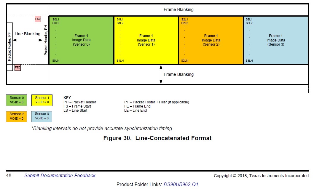

  • Hi, Brijesh.
    How about Line-Concatenated Mode?
    For example. The 1st UB962 combine 4 frames from cameras to one big metaframe. The 2nd UB962 combine 4 frames from cameras to another big metaframe.
    In this case I need to de-Bayering only two frames.
    Finally I need to configure EDMA3-controller to split/extract 4 frames from 1st metaframe and extract other 4 frames from 2nd metaframe.
    Is this technique can resolve our problem?
    best regards
  • Hi senchuss,
    Yes, that should possible. we can get complete super frame in the memory using two DMA channels and can then pass through ISP individual camera frames.
    But which modules does merging of 4 frames into one super frame?

  • Hello, Brijesh,
    It was already in raw12 mode,
    There were lines in code
    if (SYSTEM_BPP_BITS12_PACKED_MIPI == drvCalCfg->inFmt[strmId].bpp)
    drvCalCfg->isPixProcCfgValid[strmId] = (UInt32)FALSE;
    /* These modules are not required */
    Which say that pixel processing context is disabled with mipi, so I changed bpp to mipi and now, images are looking normal
    White Balance and AutoExposure now are working strangely.
    But fps is still 15. The fps from PHY1 is 30 and from PHY2 15 even though they have the same setup, what could be the reason?

    I figured out the fps issue, it was not connected with vision sdk
    The last remaining issue is with image quality. Oversaturated pixels become purple, because of that I guess aewb algorithm is not working properly.
    Maybe I should adjust something in ISP saturation configuration?
  • Hi Andrew,
    Could you please dump few raw frames from capture on second second PHY and share it?
    I doubt it is getting captured correctly.
