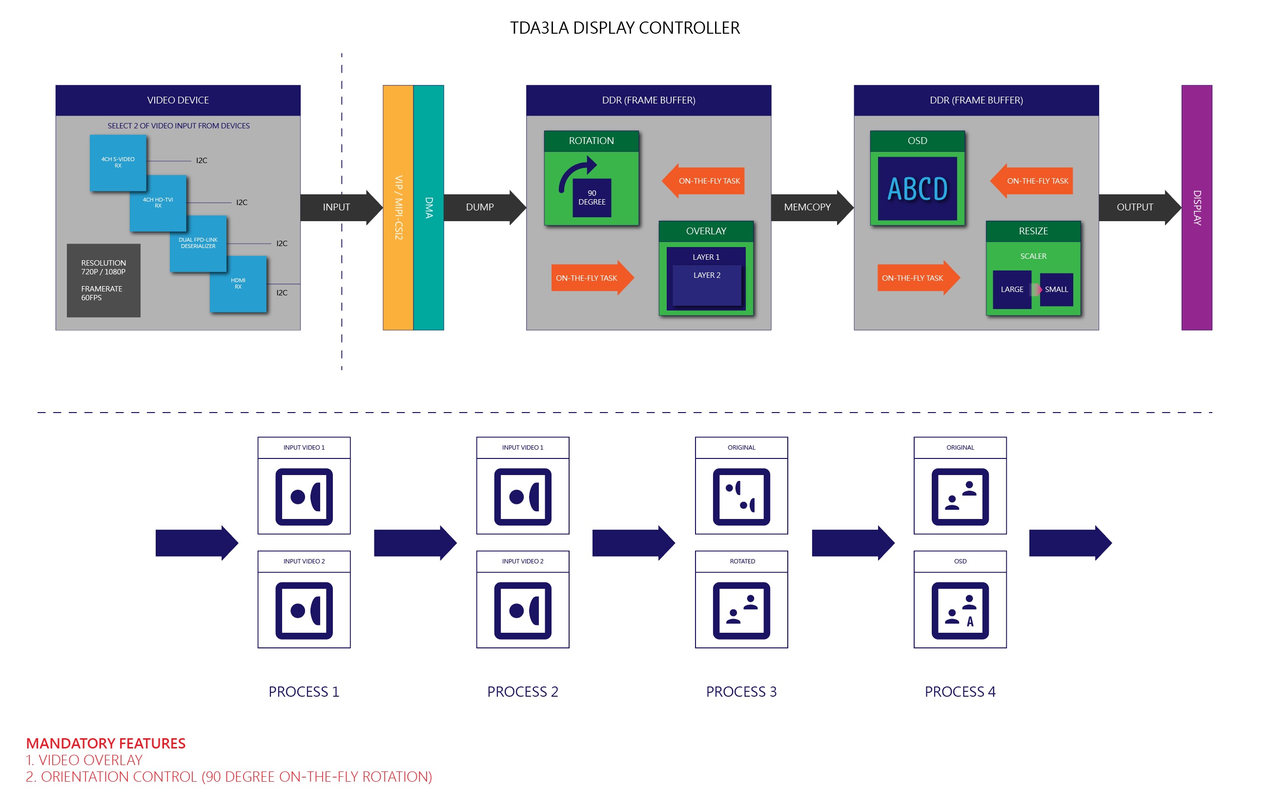

    Our Use Case Is A Display Controller Designed With TDA3LA / LX (ACCORDING TO PRODUCT PAGE TDA3LA DESIGNED WITHOUT ISS AND ONLY HAS ONE DSP) Which Must Be Capable Of Processing 2 - 4 CH 1080P Input Video At 60 FPS Frame Rate And Controlling Display For Wanted Orientation (Landscape To Portrait). That Why I Began My Post From The Question About Using DSS (Display Subsystem) Frame Buffer For Mentioned Conversion (90 Degree Rotation). Once DSS Cannot Directly Support Rotation By 90 Degree By Means Of Configurable Size Of Frame Buffer In DDR. Can We Use VIP (Video Port Frame Buffer) / ISS To Do That?
    Our Most Wanted Use Case Are Listed Below
    1. Select Any Of 2 CH Video Input From VIP / MIPI CSI-2
    2. Overlay The 2 Video Stream Into One
    3. Rotate Video Frames By 90 Degree
    4. Memcopy To DSS Frame Buffer
    5. OSD Overlay
    6. Output
    In Video Port We May Use
    FPD-LINK Deserializer / HDMI RX / SD-TV RX / HD-TVI RX
    Connect To VIP / MIPI-CSI2
    Each Time Our System Requires 2 - 4 CH Video Input In The Meantime With 1080P Resolution @60FPS. The 2 CH Video Stream Must Be Overlaid Together (Video Over Video / PIP) Then Be Converted Into 90 Degree From The Original For Portrait Compliant Display. My Question Is
    1. Is That Possible For My Use Case With Required Frame Rate / Resolution
    2. Does It Perform Well In Target Frame Rate / Resolution
    3. If I Need Video Overlay / PIP / OSD Processing The Frame Buffer Size And DMA Should Be The Factor Which May Limit Performance Due To Data Rate. So My Question Is Can I Set The Size Of Frame Buffer? Video Pipeline Supportability? Is DMA Independent With Enough Channels For Fast-To-Memory?

  • Hi Bright
    I believe the flow for you would be as below:
    ISS Capture (4 Ch 1080p capture RGB) --> Select 2 channels --> Resize 2 channels (60 FPS - assume 1/2 resizing) --> Overlay 2 channels --> Buffer rotate with EDMA --> Display with DSS
    To answer your original question regarding what software you can use to do this. You can download the Processor SDK Vision which supports TDA3x and also have examples for ISS capture and display and being able to select channels and resize them. You would need to create a custom link on top of Processor SDK vision to rotate the image by 90 deg as this is something that is not supported by any hardware block in TDA3x.
    The SDK can be downloaded from http://software-dl.ti.com/processor-sdk-vision/esd/TDAx/vision-sdk/latest/index_FDS.html
    1-1-1. SYSTEM BRING UP USING TI RTOS - This package contains the TI-RTOS support to bring up the system
    2. WHERE IS THE MENTIONED PDK DRIVERS? - This package contains the PDK drivers.
    1-1-2. DDR CALIBRATION TOOL - http://www.ti.com/lit/an/sprac36e/sprac36e.pdf - This mentions TDA2x but this also supports TDA3x family of devices.
    1-1-3. PIN MUX TOOL : The pin mux tool can be accessed from http://www.ti.com/tool/PINMUXTOOL
    2-1. CAN WE USE BUILT-IN DSP AS AUDIO DECODER? (WMA / MP3 / MP4) / OR THE DSP IS DESIGNED PURPOSED ON AUDIO ROUTING / SWITCH ONLY?
    The DSP can be used as an audio decoder as well. You would need to have software libraries which support the decoding operation. https://processors.wiki.ti.com/index.php/Software_libraries#Codecs
    3. ABOUT DISPLAY:
    You would need to drive the input of the LCD from the DSS and the M4 would be responsible to program the clocking for the DSS corresponding to the timing requirements for this LCD.
    CAN WE USE DISPLAY SUBSYSTEM FOR HORIZONTAL / VERTICAL 90 DEGREE SHIFT?
    No DSS does not support 90 deg shift. This needs to be done using EDMA.
    The system performance is sufficient for your usecase in terms of DDR performance. Where you would struggle in the current flow is ISS hardware base resizing of 2 channels of 1080p. If you can resize only one channel then you should be able to fit it in the ISS hardware.
    Also note the ISS resizer works with input of YUV422 images. So if you are inputting RGB565 you would need an additional color space conversion from RGB565 to YUV422 to use the ISS resizer.
    Stage H W FPS Num Bytes per pixel Number of Channels DDR Bandwidth Available on TDA3x Remarks
    CSI output (YUV422) 1920 1080 60 2 4 949.21875
    Resize Input 1920 1080 60 2 2 474.609375
    Resize Output 960 540 60 2 2 118.6523438
    Rotation 90 deg Input 1920 1080 60 2 1 237.3046875
    Rotation 90 deg Output 1920 1080 60 2 1 237.3046875
    Display Input 1920 1080 60 2 1 237.3046875
    Total DDR bandwidth           2254.394531 4256 Required is less than 60% of ideal DDR throughput
    Stage H W FPS Num Bytes per pixel Number of Channels IP MHz
    Resizer Mpix/s 1920 1080 60 NA 2 248.832 212.8 MHz This is more than what the ISS Resizer can support. Can you run the resize pipe at 30 FPS and have the display refresh at 60 FPS instead?

  • PIYALI
    KINDLY THANK YOU FOR YOUR FAVOR TO ANSWER MY QUESTIONS.
    IT REALLY HELPS.
    NOW MY FINAL QUESTIONS ARE ABOUT DMA AND BANDWIDTH.
    ABOUT COLOVER CONVERSION
    IN MIPI-CSI2 RX INTERFACE AND RX CONTROLLLER
    1. SO ISS HARDWARE DOESN'T SUPPORT CONVERSION ACCELERATION BY SOME REGISTER SETTING?
    1-1. I GUESS HERE IS NO PROBLEM BECAUSE
    YOUR POWERFUL FPD-LINK DESERIALIZER CAN RESOLVE FORMATTING PROBLEM.
    FOR EXAMPLE WE USE
    1-1-1. DS90UB940-Q1 IT SUPPORT LVDS RGB TO YUV OUT FOR MIPI-CSI2 TX TO TDA3 MIPI-CSI2 RX
    1-1-2.  FOR HDMI RX TO MIPI-CSI2 ADV7481 IS APPLIED IN OUR DESIGN TO INTERFACE WITH MIPI-CSI2 RX OF TDA3. IT DOES SUPPORT FOR RESOLVING THE SAME FORMATTING PROBLEM:
    1-1-3. FOR HD-TVI RX WE USE TECHPOINT TP2854 WITH DEFAULT SUPPORT FOR YUV FORMAT
    1-1-4. FOR SD-TV ADV7282A IS ADOPTED.
    SO I BELIEVE COLOR CONVERSION IS NOT NECESSARY.
    2. ABOUT ROTATION AND OVERLAY FEATURES AS YOU DESCRIBED ABOVE. MY PROBLEMS FOR THESE TWO FEATURES ARE:
    2-1. IS HERE A FRAME BUFFER SETUP FOR DSS?
    2-2. IS THAT FRAME BUFFER SIZE CONFIGURABLE?
    2-3. ARE THE TWO FUNTIONS POSSIBLE TO BE DONE ON THE FLY IN DDS FRAME BUFFER?
    2-4. HERE IS OSD OVERLAY SUPPORTED BY DSS SO I GUESS OVERLAYING 2 VIDEO STREAMS IN DSS PHASE WITH ITS FRAME BUFFER SHOULD BE BETTER THAN DOING THAT IN ISS.
    (ROTATION REQUIRED 90 DEGREE NOT FLIP IN 180 DEGREE)
    I KNOW THAT YOU HAVE ANSWER THAT SHOULD BE DONE IS DSS BUT I WONDER FOR OVERLAY.
    3. FOR RATION / OVERLAY CAN YOU DO ME A FAVOR TO POINT OUT WHERE SHOULD I MODIFY IN VISIONSDK?
    3-1. WHERE CAN WE SET UP FRAME BUFFER SIZE IN VISIONSDK / RTOS FILE IF POSSIBLE?
    3-2. ALSO CAN THAT FRAME BUFFER TO BE ALLOCATED IN SPECIFIC ADDRESSES?
