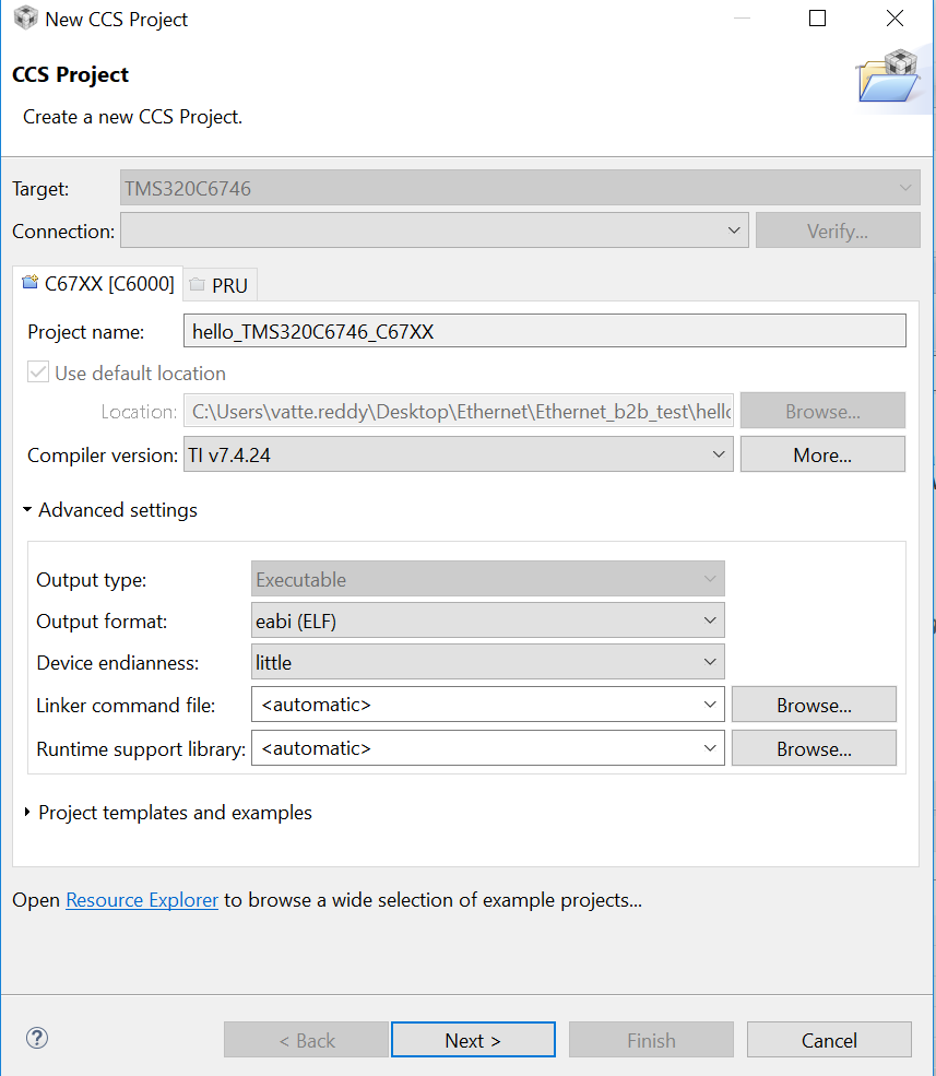

I want use TI-RTOS on C6746. I downloaded SDK for C6748 from TI's website. Then I imported Hello example code from resource explorer. But, when I tried to build the project I'm getting some errors. I'm attaching the screenshot of errors . I'm new to RTOS , so please help me with detailed explanation. This is how my console window looks like:-

Hello Vishnu,
Did you install Processor SDK? http://www.ti.com/tool/PROCESSOR-SDK-C6748
Please make sure you have performed the steps in the following guide.
Sahin
Hi
I have done the things mentioned above, but still it's not working and showing the same errors. Can anyone resolve this issue?
Thanks and Regards,
Vishnu.
I could not reproduce this issue on my end. Are you still having this issue?
Did you try doing a clean and then build?
Sahin
