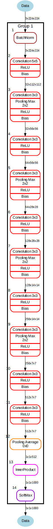

I would like to generate network graph from caffe-jacinto model for TDA2x like below.
Are there any good tool running on Windows PC?
-Shibata
Hi Praveen,
Thank you for your reply.
I confirmed that I could open .caffemodel file from netron and saw network graph.
-Shibata
