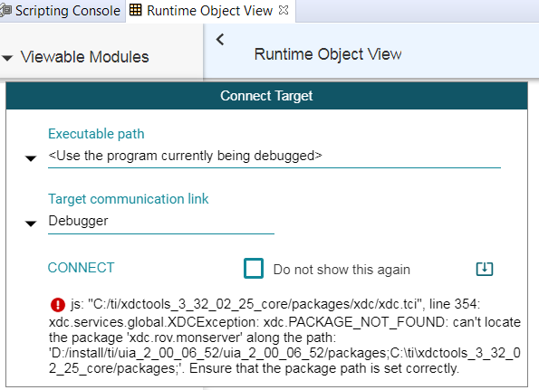

    In general, there is not enough information for me to understand what your issue is.  You application is crashing and you land in the abort function.  I have a few additional questions:
    • Does this crash happen randomly or does it occur after some specific event?
    • How frequently does this crash occur?
    • Are you able to view register dump printed out in CCS?
    • Are you able to decode the exception using ROV? See https://e2e.ti.com/support/processors/f/791/t/854484
    What software do you have running on the CPU cluster?
    -Stephen
  •  when using ROV , error reported , would you give some suggestions? thanks
    Please see similar thread: http://e2e.ti.com/support/microcontrollers/other/f/908/t/799750.  Please try to use ROV classic instead of Runtime Object View as this older version of XDCTools is not supported by the newer ROV.  The view will be slightly different but the options should be the same.
    -Stephen
