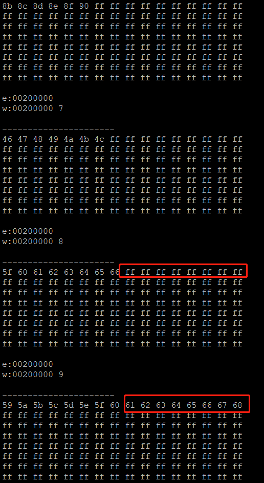

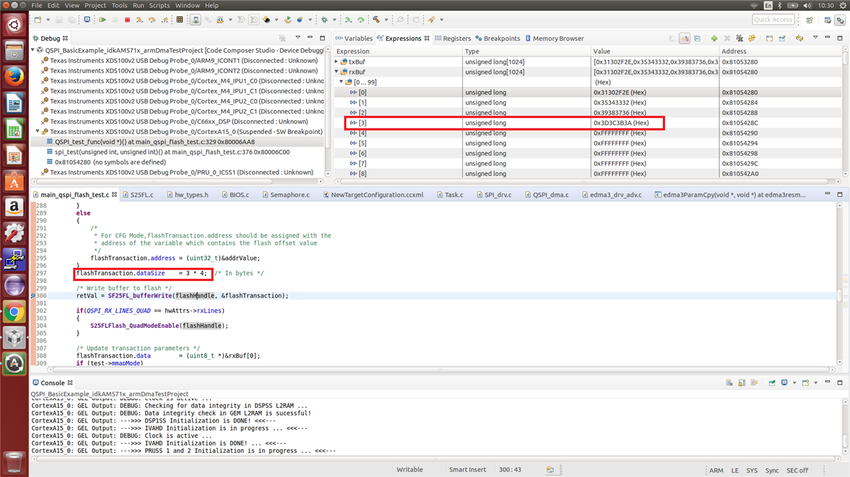

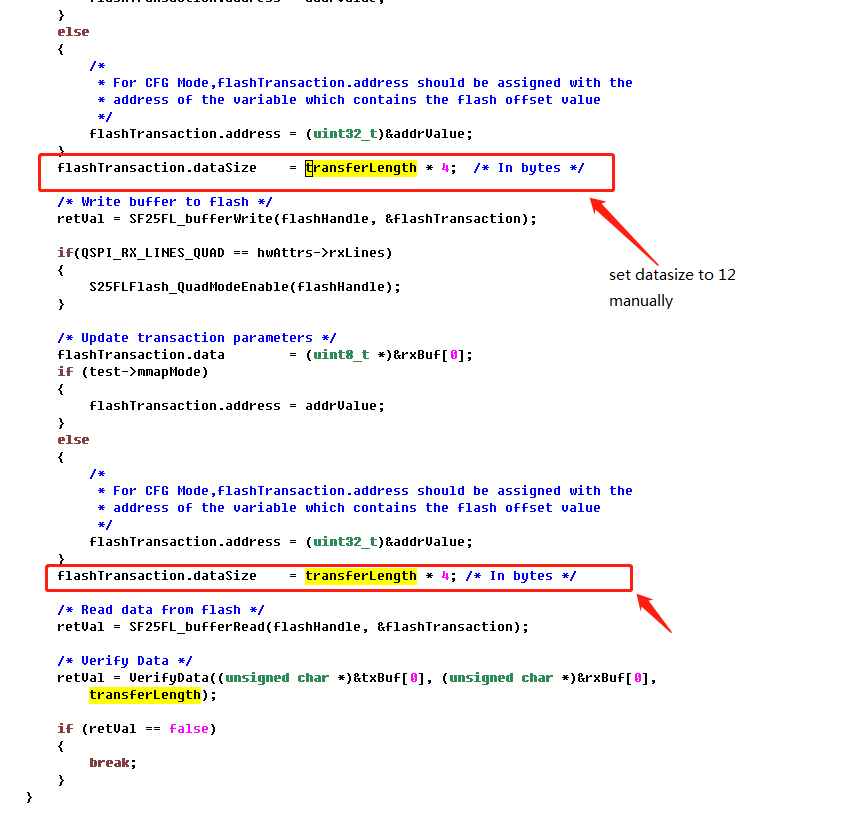

The SF25FL_bufferWrite write JUST ONE byte on every programme cycle in memory map mode.
We try to change the length up to the FLASH's PAGE SIZE, eg.256,
BUT only the first byte is correct on FLASH.
