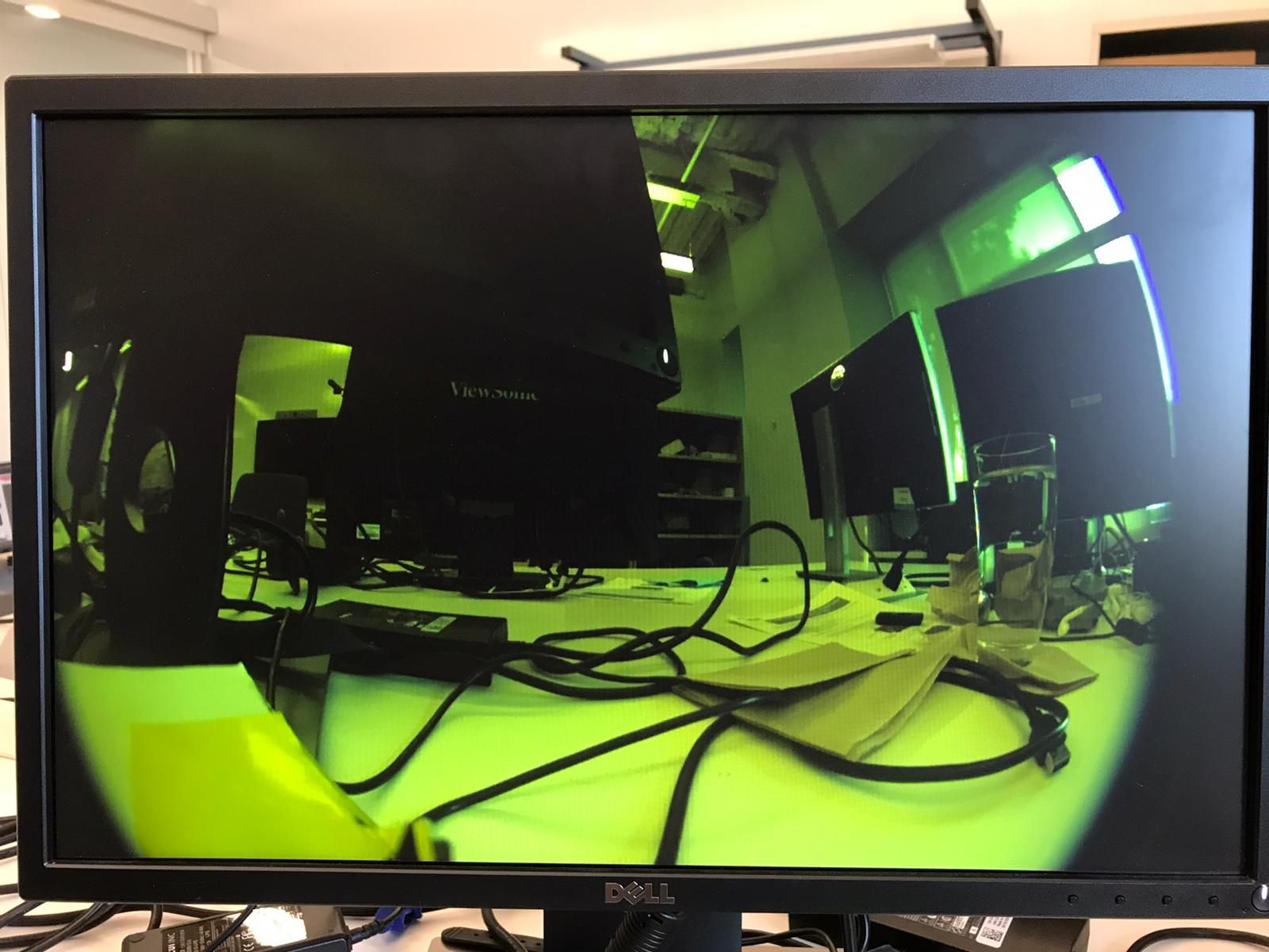

I am running Vision SDK 03.07.00.00 on TDA2P EVM and have a relatively simple use case:
I have taken the reference from "iss_capture_isp_simcop_display" in "Apps" and integrated all the required changes into my use case. I also did the following changes in app_util_iss.c file to enable only 1 output:
pPrm->channelParams[chId].enableOut[
ISSM2MISP_LINK_OUTPUTQUE_IMAGE_RSZ_A] = 1;
ISSM2MISP_LINK_OUTPUTQUE_IMAGE_RSZ_B] = 0;
ISSM2MISP_LINK_OUTPUTQUE_H3A] = 0;
ISSM2MISP_LINK_OUTPUTQUE_H3A_AF] = 0;
The use case work well, but the camera image displayed on the screen is yellowish as shown below:
On the same setup, if I run "iss_capture_isp_simcop_display", it shows the camera image properly.
Could you please let me know what could be the potential cause of this issue?
Suman
  • looks like the issue was there in the ISP output, i had to add "Alg_IssAewb" to the one of the ISP output, something like:
    and enable the corresponding output "ISSM2MISP_LINK_OUTPUTQUE_H3A" in app_util_iss.c file. So, the issue is now resolved.
