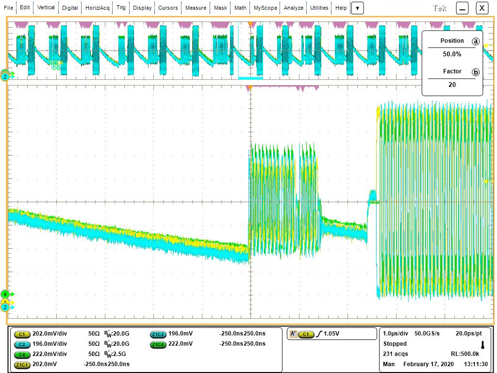

I previously posted questions about DDR2 measurements which were not okay. We have updated the design to solve the non conformance's. Now I do still see some strange behavior in our signals and was wondering if this is normal behavior or maybe a board or setting problem. (We are running at 266 MHz).
When writing to the memory the signals are looking like this:
and zoomed in:
The signals are measured at the DDR2 device:
S1 (Yellow) -> DQS1_n
S2 (Blue) -> DQS1_p
S4 (Green) -> DQ10
IO_CTRL_x = 0x0000030B
In the last picture where the DQS starts, a glitch or pulse is visible. Is this normal behavior of the signals? And can you give a statement about how the signals are looking?
Please let me know if you need more information. Thank you!
F. Veger
  • Hi Francois, can you send the output file of the DSS script with your configuration, much like you did in the previous post?  This will give the full picture of how the controller and memory are configured.
    It may be that you need to adjust ODT on the memory, or there are still some layout anomalies resulting in what looks like signal reflection.  Can you also briefly describe the equpiment you are using to probe the signal
    Do you see any functional issues?  Is the memory read/write access stable?
    James

    The stability of the platform looks good, no functional issues.
    The equipment which I use to measure DDR2 is as follows:
    Oscilloscope: MSO73304DX
    Probe: P7720 with a solder-down tip (P77STFLXA) for DQS1_p
    Probe: P7720 with a solder-down tip (P77STFLXA) for DQS1_n
    Probe: TAP2500 connected to DQ10
    François
  • Francois,
    the only adjustments you could make for a write are the controller's drive strength and the memory's ODT.  Based on the log file you sent of the configuration, you have the drive strength set to 8mA for data (bits 4:0 of DDR_DATAx_IOCTRL) and 5mA for DQS (bits 9:5).  I would try making them both 5mA
    On the memory side, you have ODT set for 50ohms (bits 26:24 in SDRAM_CONFIG).  I think this should be adequate, but it also requires that the ODT signal is properly connected, otherwise the memory ODT will not enable
    James
  • Hi James,
    When I set the drive-strenght to 5mA the first part does not change the pulse/glitch in the beginning. (I set the IOCTRL to 0x318). (Additionally I noticed the green signal was not deskewed with the other signals, which I corrected in the new measurement.)
    It more looks like some initialization getting the signals to a valid level? I double checked the ODT line but it seems to be okay (AM3351 pin G1 to DDR memory pin K9). Is this behavior never seen at Texas Instruments?
    François
  • Hi Francois, the bump you are seeing is during the preamble, where the signals are transitioning from tri-state to driven.  There is no signal integrity defined during the preamble stage.  As long as the signals are stable at the end of the preamble stage (the first differential transition), things should work fine.
    James
