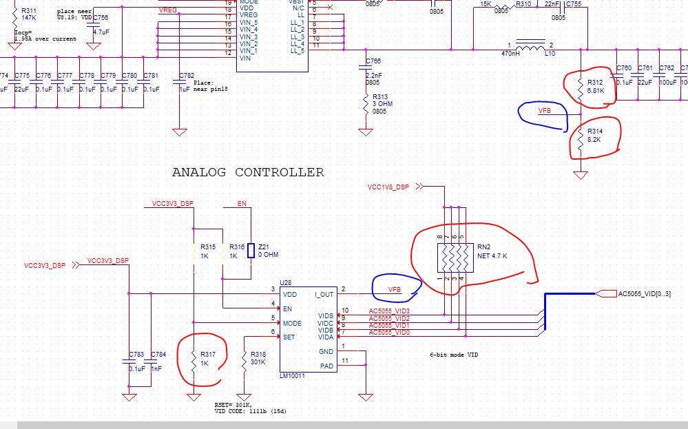

another question,
For the 1.4Ghz TMS320C6678 with the LM10011,
1. What is the start code value that I need for the start?
for now I have this:
2. Is the EN pin of LM10011 need to connect to TPS53355 EN pin? or pull high regularly? (Z21 or R315)
Shay,
Please refer to the Hardware design guide for KeyStone I devices Application Report (SPRABI2D) in Section 2.2.1 to learn more about the VID codes and the associated voltage. Note that the 1400MHz devices have a separate set of voltages that are 50mV higher for each code than the VID table for the lower speed devices.
Also refer to the C6678 Data Manual in Section 6.2 and Table 6-2 for the initial voltage. For 1400MHz devices, the initial voltage must be 1.15V, nominal. Then after the VID code is generated after reset release, the VCNTL pins will transmit the specific VID code for that device. This is described in DM Section 7.3.4.
The LM10011 VID DAC can be used with many different analog power converters. Please see the E2E link below for additional guidance:
Tom
