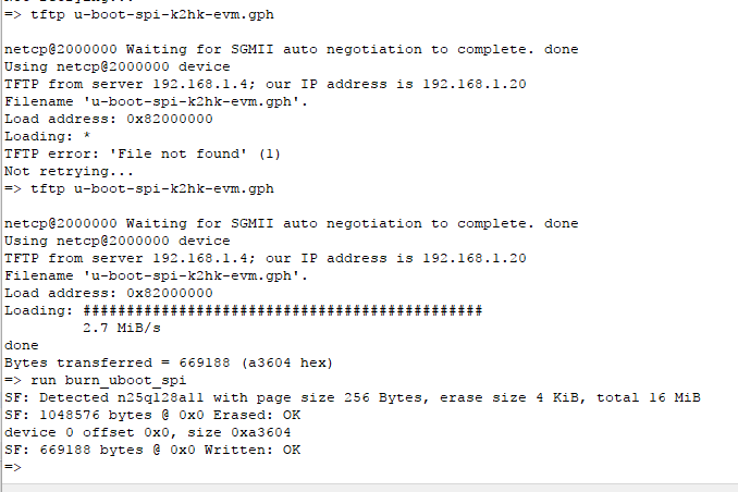

  • Hi,Rex
    I don't think setup of tftp server is wrong. I'm successful  to transfer a sample file to  my other evaluation board with omapl138.
    I try to others command to transfer
    => tftp u-boot-spi-k2hk-evm.gph
    it seems OK
    Do I need other configure for  "# run get_uboot_net"  command ?
    Best Regards
    Jacky
  • Hi, Jacky,
    You can tell the 2 posts have different output. The first showing BOOTP packets are not responded by server. That's server set up issue. The 2nd post doesn't show bootp messages any more. Somehow, server is responding. You can take a look at the scripts and see what they are doing. "get_uboot_net" does a dhcp to transfer file which acquires IP address first. tftp download skips getting IP address for the EVM, but you need to set ipaddr first.
    Your 2nd post shows download and burn successfully. Do you still have issues?
    Rex
