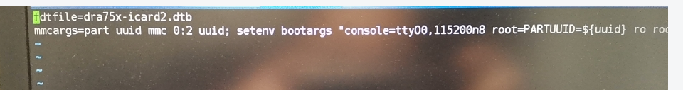

1、At present, our J6 project USES 8G EMMC. At present, we set the system file to read and write by default. During the process of testing switch or reading and writing to the file, the system file will become read-only.Changed to read only and can only be fixed with the repair command:fsck.ext4 –p /dev/mmcblk0p1;
2、Modify the J6 system fstab file to mount the root directory as read-only after the system is started. After repeatedly running up and down for a period of time, there will be an error when executing "fsck.ext4-p /dev/mmcblk0p1". The information is as follows:
root@dra7xx-evm:~# fsck.ext4 -p /dev/mmcblk0p1
rootfs contains a file system with errors, check forced.
rootfs: 3470/7168 files (0.0% non-contiguous), 21493/28672 blocks
What are the possible reasons for this, and how do you find them in terms of software and hardware?ERROR dmesg.txt
3、Power up and down is prone to problems, sometimes I did not power, just frequently copy and delete the file system; Sometimes the file system becomes read-only. Is the system software incompatible with EMMC? Or is there a bug somewhere else? Help give the analysis suggestion; I understand that EMMC is relatively stable, but now I find it is easy to make mistakes?
4、We use the kenel version number:Linux version 3.14.63;
5、I have learned from the EMMC supplier that this is not a problem of hardware design, but a problem of software design. What are the possible reasons?

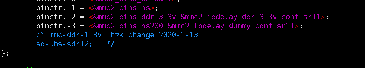

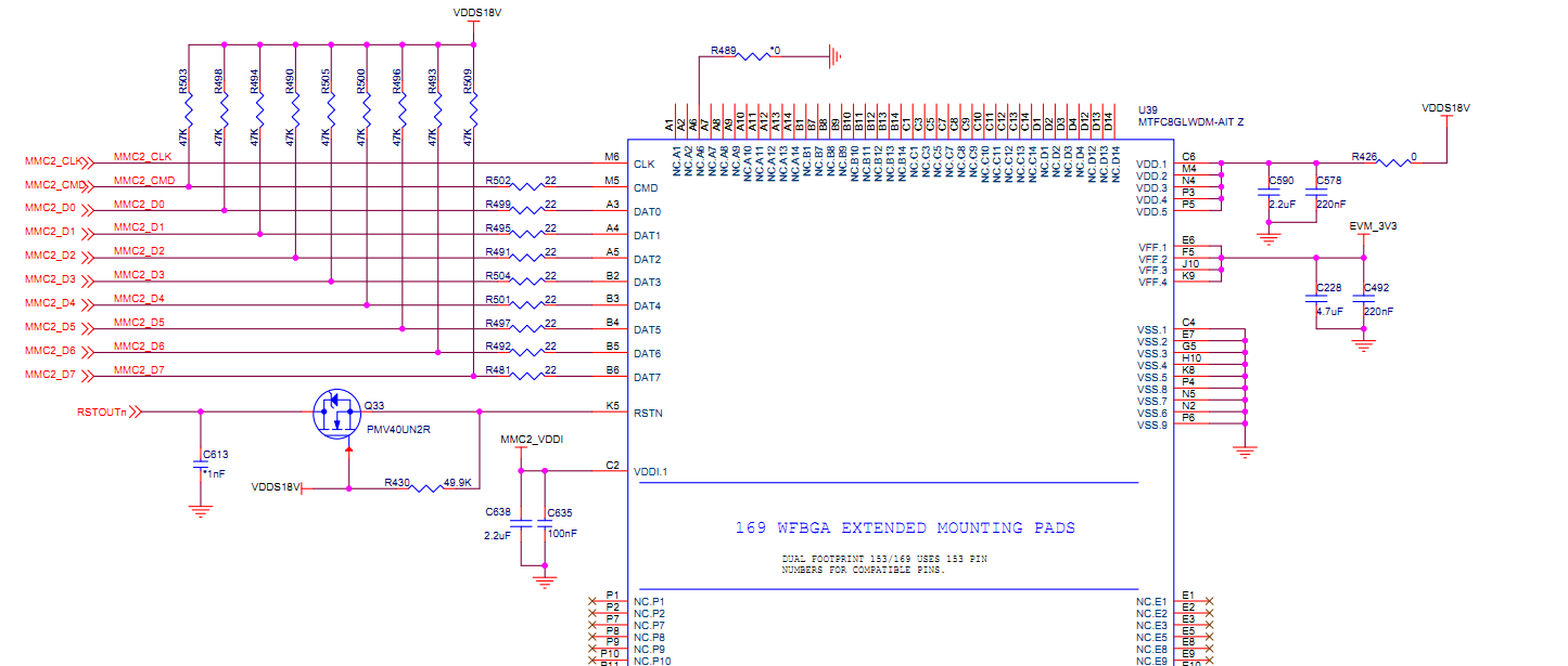

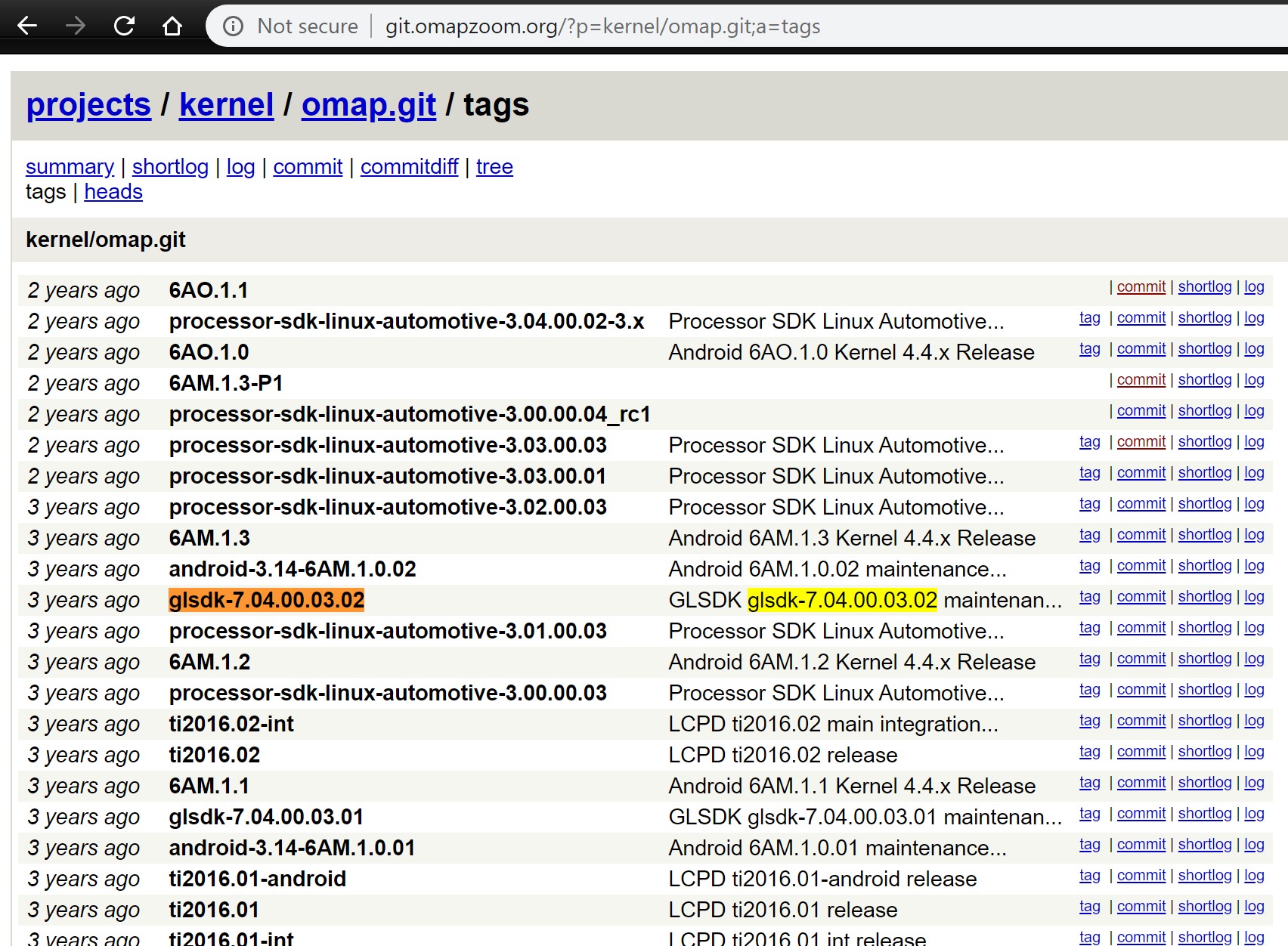

    Few questions.
    - Could you share the full kernel logs when the issue happens?
    - What speed more are you operating eMMC on?
    - The kernel version is old, which SDK are you using?
    - Were there any hardware changes recently?

    5、Below is our reference schematic design:

    Couple of comments in your schematics,
    -1-
    Why do you have the 22 ohm series resistors? The series resistors may cause signal integrity issue.
    -2-
    Could you double check the VDDI.1 connection? On our boards it's connected to GND.
    Vishal
  • Why do you have the 22 ohm series resistors? The series resistors may cause signal integrity issue.
    reply:Signal is straight through, no series resistance.
    -2-
    replay:VDD1.1Just place the capacitor, there is no connection elsewhere,
    And I see in the demo that the circuit is also connected in this way.
    The schematics you shared have 22 ohm resistors. It's not there on the board?

  • 1、YES,Our schematic shows a 22R resistance;Here the resistance is relatively small, should not affect the software。
    2、We are checking the SDK version. Which SDK is more mature for the Kernel version of 3.14?
  • 1. You can look at git tree of Kernel and figure out which TI SDK you are using, If you are on kernel 3.14 look for git tags starting with glsdk-7. Based on your kernel log, you are most probably on 7.04.00.03 version.

  • 1. Would it be possible to test without these resistors?
    2. You can try the tag glsdk-7.04.00.03.02 which has some additional fixes on top of 7.04.00.03 release (tag: glsdk-7.04.00.03)

  • The difference you are showing in the word document does not exist on our code base.
    Also, did you compare your code base against tag glsdk-7.04.00.03.02? This is the latest Kernel 3.14.

    The 3.14 maintenance code base is tag glsdk-7.04.00.03.02 from git tree http://git.omapzoom.org/?p=kernel/omap.git;a=summary
    It's difficult for me to comment on your code base based on git stats log you attached in last response.
    -2-
    The block.c code difference is not seen in our code base.
    http://git.omapzoom.org/?p=kernel/omap.git;a=blob;f=drivers/mmc/card/block.c;hb=glsdk-7.04.00.03.02

    Can you try the test with those 22 ohm resistors removed from the board?
    Vishal
  • Thank you for your reply!
    We use Kernel version 3.14,SDK Version:7.04.00.03;
    Later, we found that our code was equipped with ADAS function, but we turned off the ADAS function, not pure Linux, and the code should be visionSDK.
    I will  try the test with those 22 ohm resistors removed from the board.

  • 1、We deleted the 22R resistance, did the experiment, still can appear, and there should be no relation; I want to know where the software can change the read/write rate of EMMC?
    2、Currently, the CLK clock frequency of EMMC tested is 48M, the read rate is 11M/s, and the write rate is 65M/s. According to the software, it is mmc-ddr-1_8v. How can we modify the mode of EMMC from the agent, such as changing SDR or DDR? Could you please provide detailed explanation?
  • Currently, the CLK clock frequency of EMMC tested is 48M, the write rate is 11M/s, and the read rate is 65M/s. According to the software, it is mmc-ddr-1_8v. How can we modify the mode of EMMC from the agent, such as changing SDR or DDR? Could you please provide detailed explanation?
    Yes, according to your kernel log, eMMC is enumerated in High Speed mode and matches the 48MHz clock value.
    In kernel 3.14, mmc-ddr-1_8v property in dts indicates that i eMMC high-speed DDR mode(1.8V I/O) is supported.
    You can try deleting that property and try adding one of the below properties to try lower speed modes.
    sd-uhs-sdr12 --> SD UHS SDR12 speed is supported
    sd-uhs-sdr25 --> SD UHS SDR25 speed is supported
    Vishal
  • Yes,I looked at the original code, as if it was not configured by default; Mmc-ddr-1_8v is also not available, I also deleted this part, the test found that the default state clock frequency CLK is still 48M, the write rate is not changed to 11MB/s, the read rate is changed to 40MB/s, where is the change affected?
  • Our code compares the demo differences and finds that there are differences here; The software is commented out, the write rate doesn't change, the CLK rate doesn't change; I'm just reading at a rate of 65M/s to 40MB/s.
    Could you also try removing the pinctrl-* entries and test?
    Keep only below and check the behavior.
    pinctrl-names = "default";
    pinctrl-0 = <&mmc2_pins_default>;
