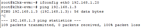

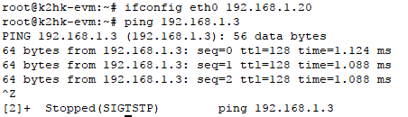

1, Ethernet link  down , after whole filesystem boot up. I saw someone have same question on TI website
    Do I need to disable some function on Linux?
2, Error message comes up.It may be not affect kernel operation.But error message make me feel unstable.
   Have any solution for these error message?
3, The prebuild .ubi file is about 166MB ,but the file size of ubi I compile is about 200Mb. I don't change anything but they aren't same size.
So any parameter or setting I need to modify? Here is the command I input to compile ubi file:
mkfs.ubifs -r ./boot -F -o keystone-evm-boot.ubifs -m 2048 -e 126976 -c 47
mkfs.ubifs -r ./tisdk -o processor-rootfs-k2hk-evm.ubifs -F -m 2048 -e 126976 -c 4800
ubinize -o k2hk-evm-rootfs.ubi -m 2048 -p 128KiB -s 2048 -O 2048 ubinize_k2hk-evm.cfg

    I can't tell why the eth0 is down. You may want to check your boot logs to see if there is any errors when initializing the eth0 including serdes, gbe-firmware, etc. Is this your custom board? If you have a TI EVM, you can compare the boot logs between the 2 boards and see what the difference are.
    The message on "Failed to start Synchronize system and HW clock" has been discussed in the following link. Please refer to it.
    https://e2e.ti.com/support/processors/f/791/t/893165
    The hyper term warning has nothing to do with EVM. To me, it is HyperTerm complaining the text format. It's irrelevant to board operation.
    Rex

    1,This is not my custom board. I always using TI EVMK2H,That is why I confuse about eth0 down issue.
       I used to run MCSDK on EVMK2H , and I don't find any eth0 down issue. So I don't think there is any hardware issue .
    2,Could I disable this error message? Because I don't want anyone saw this error and feel something wrong on my system.
    Are you still using MCSDK or have migrated to ProcSDK? what version? If you migrated to PSDK, are you running prebuilt images? have you reset u-boot env variables?
    Do you use ethernet port? If you don't have ethernet cable connected, it's normal to print that message and doesn't have any impact to operation if network is not used. Besides, it is not an error, but a warning message. If it bothers you, you can disable the print in driver code. Be aware of this file has been upstreamed. You should follow the license term stated in the header of the file.
    Rex

    1, I am trying to migrate to Processor SDK ,using 06.01.00.08
        I use prebuild images and image I build form source code .Both have same issue.
         I don't  think u-boot env have effect on that.Because I only set ftfp path and server ip .But I will reset and see.
    2,Ethernet need to be connected  all the time .This solution sounds a little inflexible.Is there any document about EVMK2H NTP configure?
    Best Regards
    Jacky

  • Hi, Jacky,
    You didn't mentioned the ethernet port goes up and down in your original post. The logs you attached clearly indicates you have Gigabit MDC/MDIO signal integrity issue which is documented in NetCP driver guide,
    http://software-dl.ti.com/processor-sdk-linux/esd/docs/latest/linux/Foundational_Components/Kernel/Kernel_Drivers/Network/NetCP.html
    Follow the instruction in the Driver Guide to disable MDIO will workaround the issue. The document may based on older kernel release, you will need to port it to the latest kernel.
    Rex
  • Hi,Rex
    Sorry for late reply.Sometime ethernet port just goes down and won't go up.But sometime eth port will go up and down .
    Anyway, thanks for your information.I will try your way and see.
    Best Regards
    Jacky
  • Jacky,
    Yes, please try to disable MDIO and post back if it helps.
    Rex
  • Hi,Rex
    It seems OK to disable MDIO ,wouldn't see ethernet port down issue.

    Thanks for your advise. I disable CPTS in tisdk_k2hk-evm_defconfig file
    # CONFIG_TI_CPTS=y
    And I don't see any CPTS message anymore.
    But I find out ethernet work abnormally because disable MDIO. I fail to  ping IP  when disable MDIO, and success to ping  IP on original images.
    Do you have any thought about it ?

    root@k2hk-evm:~# ifconfig eth0 192.168.1.20
    root@k2hk-evm:~# ping 192.168.1.3
    PING 192.168.1.3 (192.168.1.3): 56 data bytes
    ^C
    --- 192.168.1.3 ping statistics ---
    109 packets transmitted, 0 packets received, 100% packet loss
    root@k2hk-evm:~#

  • Hi, Jacky,
    Were you able to ping before you disable CPTS?
    Rex
  • Hi,Rex
    If I only disable MDIO , it fail to ping.
    if I only disable CPTS , it could ping.
    So I could not to ping before disable CPTS ,because I disable MDIO.
    Best Regards
    Jacky
  • Hi, Jacky,
    I don't know what the cause is. We didn't have ping failure issue when MDIO was disabled.

  • Hi, Jacky,
    We root caused the issue. In PLSDK, there were some code got removed. When MDIO is disabled, the ethss_clk is also disabled. The workaround will be modified to keep mdio node, but only remove phy-handle in gbe nodes as show below. The link-interface need to change from 1 to 4 (NO_MDIO).
    I verified the change and it works. Our User's Guide will be modified to reflect the changes. Thanks for your patience.
    @@ -232,14 +232,14 @@ netcp: netcp@2000000 {
                                    gbe0: interface-0 {
                                            phys = <&serdes_lane0>;
                                            slave-port = <0>;
    -                                       link-interface = <1>;
    -                                       phy-handle = <&ethphy0>;
    +                                       link-interface = <4>;
    +                                       /* phy-handle = <&ethphy0>; */
                                    gbe1: interface-1 {
                                            phys = <&serdes_lane1>;
                                            slave-port = <1>;
    -                                       phy-handle = <&ethphy1>;
    +                                       /* phy-handle = <&ethphy1>; */
    Rex
  • Hi,Rex
    Happy to see your solution. And my EVMK2H success to ping IP address.
    64 bytes from 192.168.1.3: seq=0 ttl=128 time=2.551 ms
    64 bytes from 192.168.1.3: seq=1 ttl=128 time=1.789 ms
    64 bytes from 192.168.1.3: seq=2 ttl=128 time=1.112 ms
    ^C
    3 packets transmitted, 3 packets received, 0% packet loss
    round-trip min/avg/max = 1.112/1.817/2.551 ms
    root@k2hk-evm:~#
