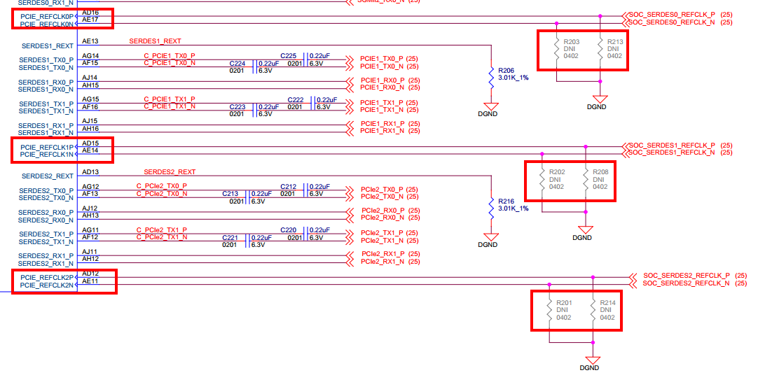

I find that TDA4VM could provide internal PLL clock (100MHz) needed for PCIe operation. So we might remove the external clock generator for PCIe.  (https://e2e.ti.com/support/processors/f/791/t/865372)
I have checked with our local TI FAE, TDA4VM also could internal PLL clock(100MHz) for DP operation before.
The question what I want to ask is :

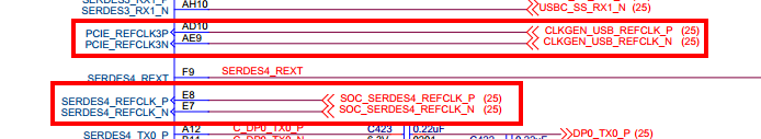

If I select to use internal PLL clock as SerDes reference clock input, then the pin of TDA4VM reference clock is not used. How to correctly handle them? Do we need to push them down with 50Ohm resistor?  I find that in TDA4VM EVM, some SerDes clock input pins (SerDes0/ SerDes1/ SerDes2 ) has reserved the termination resistor packages, some module (SerDes3/ SerDes4) does not reserved.
  • Hi Nick,
    No need for any special handling for Serdes I/Os. Pads for resistors to GND are nice to have for any debugging in the future.
    Please note that if you have PCIe ports in the design and you wish to skip the external clock generator, then the internal (SoC) 100-Mhz clock needs to be routed to the external PCIe devices/slots. I.e. PCIE_REFCLK0/1/2/3 must become outputs (SW configurable) and connected to external PCIe device. More details about PCIE reference clock distribution can be found in the PCIe specs.
