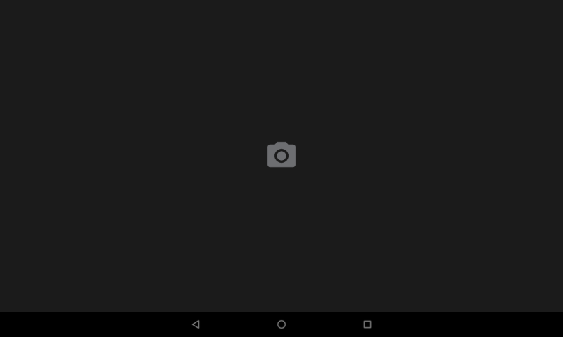

I have an AM572x Evaluation Module TMDSEVM572X with me.  I am using TI Camera Module (TMDSCM572X AM57XX Camera Board REV C).And this camera works successfully on Linux PSDK (all versions).
I am able to successfully compile the Android 5.03 PSDK and flash it on my EVM. I am trying to open camera preview using default system camera application. Please note I have done following changes around Camera HAL code-
However, I am still not able to open a camera preview. Camera app is not crashing anymore but I am getting following error - (error log is attached - CameraAppCrash.txt)
E/CameraService: initializeShimMetadata: Error initializing shim metadata: Status(-8): '10: connectHelper:1399: Failed to initialize camera "1": Function not implemented (-38)'
E/CameraHal: (a817f970)   hardware/ti/dra7xx/camera/CameraHal.cpp:126 getSocFamily - '/sys/board_properties/soc/family' Not Available
On the EVM, I am getting following thing-
Now I know that camera is not supported on TI AM5728 EVM in any Android SDK version, but I am trying to make it work here. Please can you support me with this problem?

2020-04-21 16:03:45.392 202-299/? D/CameraHal: (a817f970)   hardware/ti/dra7xx/camera/CameraParameters.cpp:220 dump - prop-camera-name = USBCAMERA
2020-04-21 16:03:45.392 202-299/? D/CameraHal: (a817f970)   hardware/ti/dra7xx/camera/CameraParameters.cpp:220 dump - prop-effect-values = none
2020-04-21 16:03:45.392 202-299/? D/CameraHal: (a817f970)   hardware/ti/dra7xx/camera/CameraParameters.cpp:220 dump - prop-exposure-mode-values = auto
2020-04-21 16:03:45.392 202-299/? D/CameraHal: (a817f970)   hardware/ti/dra7xx/camera/CameraParameters.cpp:220 dump - prop-facing = back
2020-04-21 16:03:45.392 202-299/? D/CameraHal: (a817f970)   hardware/ti/dra7xx/camera/CameraParameters.cpp:220 dump - prop-flash-mode-values = off
2020-04-21 16:03:45.392 202-299/? D/CameraHal: (a817f970)   hardware/ti/dra7xx/camera/CameraParameters.cpp:220 dump - prop-focal-length = 1
2020-04-21 16:03:45.392 202-299/? D/CameraHal: (a817f970)   hardware/ti/dra7xx/camera/CameraParameters.cpp:220 dump - prop-focus-mode-default = fixed
2020-04-21 16:03:45.392 202-299/? D/CameraHal: (a817f970)   hardware/ti/dra7xx/camera/CameraParameters.cpp:220 dump - prop-focus-mode-values = fixed
2020-04-21 16:03:45.392 202-299/? D/CameraHal: (a817f970)   hardware/ti/dra7xx/camera/CameraParameters.cpp:220 dump - prop-framerate-range-default = (30000,30000)
2020-04-21 16:03:45.392 202-299/? D/CameraHal: (a817f970)   hardware/ti/dra7xx/camera/CameraParameters.cpp:220 dump - prop-framerate-range-values =
2020-04-21 16:03:45.392 202-299/? D/CameraHal: (a817f970)   hardware/ti/dra7xx/camera/CameraParameters.cpp:220 dump - prop-horizontal-angle = 170
2020-04-21 16:03:45.392 202-299/? D/CameraHal: (a817f970)   hardware/ti/dra7xx/camera/CameraParameters.cpp:220 dump - prop-ipp-values = ldc-nsf
2020-04-21 16:03:45.392 202-299/? D/CameraHal: (a817f970)   hardware/ti/dra7xx/camera/CameraParameters.cpp:220 dump - prop-iso-mode-values = auto
2020-04-21 16:03:45.392 202-299/? D/CameraHal: (a817f970)   hardware/ti/dra7xx/camera/CameraParameters.cpp:220 dump - prop-jpeg-quality-default = 90
2020-04-21 16:03:45.392 202-299/? D/CameraHal: (a817f970)   hardware/ti/dra7xx/camera/CameraParameters.cpp:220 dump - prop-jpeg-thumbnail-quality-default = 50
2020-04-21 16:03:45.392 202-299/? D/CameraHal: (a817f970)   hardware/ti/dra7xx/camera/CameraParameters.cpp:220 dump - prop-jpeg-thumbnail-size-default = 320x240
2020-04-21 16:03:45.392 202-299/? D/CameraHal: (a817f970)   hardware/ti/dra7xx/camera/CameraParameters.cpp:220 dump - prop-jpeg-thumbnail-size-values = 0x0,320x240
2020-04-21 16:03:45.392 202-299/? D/CameraHal: (a817f970)   hardware/ti/dra7xx/camera/CameraParameters.cpp:220 dump - prop-max-fd-hw-faces = 0
2020-04-21 16:03:45.392 202-299/? D/CameraHal: (a817f970)   hardware/ti/dra7xx/camera/CameraParameters.cpp:220 dump - prop-orientation = 0
2020-04-21 16:03:45.392 202-299/? D/CameraHal: (a817f970)   hardware/ti/dra7xx/camera/CameraParameters.cpp:220 dump - prop-picture-format-default = jpeg
2020-04-21 16:03:45.392 202-299/? D/CameraHal: (a817f970)   hardware/ti/dra7xx/camera/CameraParameters.cpp:220 dump - prop-picture-format-values = jpeg
2020-04-21 16:03:45.392 202-299/? D/CameraHal: (a817f970)   hardware/ti/dra7xx/camera/CameraParameters.cpp:220 dump - prop-picture-size-default = 1280x720
2020-04-21 16:03:45.392 202-299/? D/CameraHal: (a817f970)   hardware/ti/dra7xx/camera/CameraParameters.cpp:220 dump - prop-picture-size-values = 1280x800,1280x720,752x480,640x480,600x400,352x288,320x240
2020-04-21 16:03:45.392 202-299/? D/CameraHal: (a817f970)   hardware/ti/dra7xx/camera/CameraParameters.cpp:220 dump - prop-preview-format-default = yuv420sp
2020-04-21 16:03:45.392 202-299/? D/CameraHal: (a817f970)   hardware/ti/dra7xx/camera/CameraParameters.cpp:220 dump - prop-preview-format-values = yuv420sp
2020-04-21 16:03:45.392 202-299/? D/CameraHal: (a817f970)   hardware/ti/dra7xx/camera/CameraParameters.cpp:220 dump - prop-preview-frame-rate-default = 30
2020-04-21 16:03:45.392 202-299/? D/CameraHal: (a817f970)   hardware/ti/dra7xx/camera/CameraParameters.cpp:220 dump - prop-preview-frame-rate-values =
2020-04-21 16:03:45.392 202-299/? D/CameraHal: (a817f970)   hardware/ti/dra7xx/camera/CameraParameters.cpp:220 dump - prop-preview-size-default = 1280x720
2020-04-21 16:03:45.392 202-299/? D/CameraHal: (a817f970)   hardware/ti/dra7xx/camera/CameraParameters.cpp:220 dump - prop-preview-size-values = 1280x800,1280x720,752x480,640x480,600x400,352x288,320x240
2020-04-21 16:03:45.392 202-299/? D/CameraHal: (a817f970)   hardware/ti/dra7xx/camera/CameraParameters.cpp:220 dump - prop-preview-subsampled-size-values = 1280x800,1280x720,752x480,640x480,600x400,352x288,320x240
2020-04-21 16:03:45.392 202-299/? D/CameraHal: (a817f970)   hardware/ti/dra7xx/camera/CameraParameters.cpp:220 dump - prop-required-preview-bufs = 8
2020-04-21 16:03:45.392 202-299/? D/CameraHal: (a817f970)   hardware/ti/dra7xx/camera/CameraParameters.cpp:220 dump - prop-s3d-prv-frame-layout = none
2020-04-21 16:03:45.392 202-299/? D/CameraHal: (a817f970)   hardware/ti/dra7xx/camera/CameraParameters.cpp:220 dump - prop-sensor-index = 0
2020-04-21 16:03:45.392 202-299/? D/CameraHal: (a817f970)   hardware/ti/dra7xx/camera/CameraParameters.cpp:220 dump - prop-vertical-angle = 170
2020-04-21 16:03:45.392 202-299/? D/CameraHal: (a817f970)   hardware/ti/dra7xx/camera/CameraParameters.cpp:220 dump - prop-vnf-default = false
2020-04-21 16:03:45.392 202-299/? D/CameraHal: (a817f970)   hardware/ti/dra7xx/camera/CameraParameters.cpp:220 dump - prop-vstab-default = false
2020-04-21 16:03:45.392 202-299/? D/CameraHal: (a817f970)   hardware/ti/dra7xx/camera/CameraParameters.cpp:220 dump - prop-zoom-default = 1
2020-04-21 16:03:45.392 202-299/? D/CameraHal: (a817f970)   hardware/ti/dra7xx/camera/CameraParameters.cpp:220 dump - prop-zoom-ratios = 1
2020-04-21 16:03:45.392 202-299/? D/CameraHal: (a817f970)   hardware/ti/dra7xx/camera/CameraParameters.cpp:220 dump - prop-zoom-stages = 1
2020-04-21 16:03:45.392 202-299/? D/CameraHal: (a817f970)   hardware/ti/dra7xx/camera/CameraParameters.cpp:220 dump - prop-zoom-supported = false
2020-04-21 16:03:45.392 202-299/? D/CameraHal: (a817f970)   hardware/ti/dra7xx/camera/CameraParameters.cpp:220 dump - sensor-orientation = 0
2020-04-21 16:03:45.392 202-299/? D/CameraHal: (a817f970)   hardware/ti/dra7xx/camera/CameraParameters.cpp:223 dump - --------------------------------
2020-04-21 16:03:45.392 202-299/? D/CameraHal: (a817f970)   hardware/ti/dra7xx/camera/CameraHal.cpp:4139 initialize - Sensor index= 0; Sensor name= USBCAMERA
2020-04-21 16:03:45.393 202-299/? E/CameraHal: Found VPE M2M device /dev/video1!!!
2020-04-21 16:03:45.393 202-299/? D/CameraHal: (a817f970)   hardware/ti/dra7xx/camera/V4LCameraAdapter/V4LCameraAdapter.cpp:1212 V4LCameraAdapter_Factory - New V4L Camera adapter instance created for sensor 0
2020-04-21 16:03:45.393 202-299/? D/CameraHal: (a817f970)   hardware/ti/dra7xx/camera/AppCallbackNotifier.cpp:1656 start -  --> AppCallbackNotifier NOTIFIER_STARTED
2020-04-21 16:03:45.393 202-299/? D/CameraHal: (a817f970)   hardware/ti/dra7xx/camera/CameraHal.cpp:4209 initialize - Started AppCallbackNotifier..
2020-04-21 16:03:45.393 202-299/? D/CameraHal: (a817f970)   hardware/ti/dra7xx/camera/CameraHal.cpp:411 setParameters - PreviewFormat set yuv420sp
2020-04-21 16:03:45.393 202-299/? D/CameraHal: (a817f970)   hardware/ti/dra7xx/camera/CameraHal.cpp:572 setParameters - Recording Hint is set to NULL
2020-04-21 16:03:45.393 202-299/? D/CameraHal: (a817f970)   hardware/ti/dra7xx/camera/CameraHal.cpp:593 setParameters - Preview Resolution: 1280 x 720
2020-04-21 16:03:45.393 202-299/? D/CameraHal: (a817f970)   hardware/ti/dra7xx/camera/CameraHal.cpp:597 setParameters - Focus mode set fixed
2020-04-21 16:03:45.393 202-299/? D/CameraHal: (a817f970)   hardware/ti/dra7xx/camera/CameraHal.cpp:641 setParameters - Picture Size by App 1280 x 720
2020-04-21 16:03:45.394 202-299/? D/CameraHal: (a817f970)   hardware/ti/dra7xx/camera/CameraHal.cpp:1000 setParameters - Jpeg quality set 90
2020-04-21 16:03:45.394 202-299/? D/CameraHal: (a817f970)   hardware/ti/dra7xx/camera/CameraHal.cpp:1006 setParameters - Thumbnail width set 320
2020-04-21 16:03:45.394 202-299/? D/CameraHal: (a817f970)   hardware/ti/dra7xx/camera/CameraHal.cpp:1012 setParameters - Thumbnail width set 240
2020-04-21 16:03:45.394 202-299/? D/CameraHal: (a817f970)   hardware/ti/dra7xx/camera/CameraHal.cpp:1018 setParameters - Thumbnail quality set 50
2020-04-21 16:03:45.394 202-299/? D/CameraHal: (a817f970)   hardware/ti/dra7xx/camera/CameraHal.cpp:1125 setParameters - Zoom set 1
2020-04-21 16:03:45.394 202-299/? D/CameraHal: (a817f970)   hardware/ti/dra7xx/camera/CameraHal.cpp:1172 setParameters - External Gamma set false
2020-04-21 16:03:45.394 202-299/? D/CameraHal: (a817f970)   hardware/ti/dra7xx/camera/CameraHal.cpp:1178 setParameters - NSF1 set true
2020-04-21 16:03:45.394 202-299/? D/CameraHal: (a817f970)   hardware/ti/dra7xx/camera/CameraHal.cpp:1184 setParameters - NSF2 set true
2020-04-21 16:03:45.394 202-299/? D/CameraHal: (a817f970)   hardware/ti/dra7xx/camera/CameraHal.cpp:1190 setParameters - Sharpening set true
2020-04-21 16:03:45.394 202-299/? D/CameraHal: (a817f970)   hardware/ti/dra7xx/camera/CameraHal.cpp:1196 setParameters - Color Conversion set true
2020-04-21 16:03:45.394 202-299/? D/CameraHal: (a817f970)   hardware/ti/dra7xx/camera/CameraHal.cpp:1202 setParameters - Green Inballance Correction set true
2020-04-21 16:03:45.394 202-299/? D/CameraHal: (a817f970)   hardware/ti/dra7xx/camera/V4LCameraAdapter/V4LCameraAdapter.cpp:456 setParameters - Width * Height 1280 x 720 format 0x56595559
2020-04-21 16:03:45.394 202-299/? D/CameraHal: (a817f970)   hardware/ti/dra7xx/camera/V4LCameraAdapter/V4LCameraAdapter.cpp:218 v4lSetFormat - Width * Height 1280 x 720 format 0x56595559
2020-04-21 16:03:45.414 202-299/? D/CameraHal: (a817f970)   hardware/ti/dra7xx/camera/V4LCameraAdapter/V4LCameraAdapter.cpp:244 v4lSetFormat - VIDIOC_G_FMT : WxH = 1280x720
2020-04-21 16:03:45.414 202-299/? D/CameraHal: (a817f970)   hardware/ti/dra7xx/camera/V4LCameraAdapter/V4LCameraAdapter.cpp:245 v4lSetFormat - ### Using: WxH = 1280x720  pixelformat=0x56595559
2020-04-21 16:03:45.414 202-299/? D/CameraHal: (a817f970)   hardware/ti/dra7xx/camera/V4LCameraAdapter/V4LCameraAdapter.cpp:246 v4lSetFormat - ### Using: bytesperline=2560 sizeimage=1843200 colorspace=0x1
2020-04-21 16:03:45.414 202-299/? D/CameraHal: (a817f970)   hardware/ti/dra7xx/camera/V4LCameraAdapter/V4LCameraAdapter.cpp:465 setParameters - Current fps is 0 new fps is (30000,30000)
2020-04-21 16:03:45.414 233-295/? I/CameraHardwareInterface: Destroying camera 0
2020-04-21 16:03:45.415 202-299/? D/CameraHal: (a817f970)   hardware/ti/dra7xx/camera/CameraHal.cpp:286 enableMsgType - Preview callback not enabled 409
2020-04-21 16:03:45.436 1115-1157/com.android.camera2 W/LegacyMetadataMapper: No AWB modes supported (HAL bug); defaulting to AWB_MODE_AUTO only
2020-04-21 16:03:45.443 1115-1192/com.android.camera2 I/OMXClient: Treble IOmx obtained
2020-04-21 16:03:45.443 242-274/? I/OMXMaster: makeComponentInstance(OMX.google.vorbis.decoder) in omx@1.0-service process
2020-04-21 16:03:45.445 242-1180/? E/OMXNodeInstance: getConfig(0xa89a30e0:google.vorbis.decoder, ConfigAndroidVendorExtension(0x6f100004)) ERROR: Undefined(0x80001001)
2020-04-21 16:03:45.448 1115-1157/com.android.camera2 I/CAM_Profiler: [149.103ms] GUARD: CaptureModule.openCameraAndStartPreview() - [148.978ms] mOneCameraOpener.open()
2020-04-21 16:03:45.448 200-200/? W//system/bin/hw/android.hidl.allocator@1.0-service: ashmem_create_region(32768) returning hidl_memory(0xa99177d0, 32768)
2020-04-21 16:03:45.448 1115-1157/com.android.camera2 I/CAM_Profiler: [149.103ms] GUARD: CaptureModule.openCameraAndStartPreview() - STOP
2020-04-21 16:03:45.450 1115-1153/com.android.camera2 W/LegacyMetadataMapper: No AWB modes supported (HAL bug); defaulting to AWB_MODE_AUTO only
2020-04-21 16:03:45.454 200-200/? W//system/bin/hw/android.hidl.allocator@1.0-service: ashmem_create_region(32768) returning hidl_memory(0xa99177d0, 32768)
2020-04-21 16:03:45.460 200-200/? I/chatty: uid=1000(system) allocator@1.0-s identical 5 lines
2020-04-21 16:03:45.460 200-200/? W//system/bin/hw/android.hidl.allocator@1.0-service: ashmem_create_region(32768) returning hidl_memory(0xa99177d0, 32768)
2020-04-21 16:03:45.460 1115-1153/com.android.camera2 I/CAM_OneCamCreator: Camera support level: LEGACY_JPEG
2020-04-21 16:03:45.467 200-200/? W//system/bin/hw/android.hidl.allocator@1.0-service: ashmem_create_region(32768) returning hidl_memory(0xa99177d0, 32768)
2020-04-21 16:03:45.468 1115-1153/com.android.camera2 I/CAM_OneCamCreator: Picture Size Configuration: PictureSizeCalculator.Configuration{native size=1280x800, crop=Rect(0, 0 - 1280, 800)}
2020-04-21 16:03:45.468 200-200/? W//system/bin/hw/android.hidl.allocator@1.0-service: ashmem_create_region(32768) returning hidl_memory(0xa99177d0, 32768)
2020-04-21 16:03:45.470 200-200/? I/chatty: uid=1000(system) allocator@1.0-s identical 1 line
2020-04-21 16:03:45.471 200-200/? W//system/bin/hw/android.hidl.allocator@1.0-service: ashmem_create_region(32768) returning hidl_memory(0xa99177d0, 32768)
2020-04-21 16:03:45.480 1115-1153/com.android.camera2 D/CAM_CaptureModule: onCameraOpened: com.android.camera.one.v2.initialization.GenericOneCameraImpl@1c8c78a
2020-04-21 16:03:45.482 1115-1153/com.android.camera2 D/CAM_CaptureModule: starting preview ...
2020-04-21 16:03:45.484 1115-1115/com.android.camera2 D/CAM_Camera2OneCamMgr: Getting First FRONT Camera
2020-04-21 16:03:45.488 1115-1115/com.android.camera2 W/LegacyMetadataMapper: No AWB modes supported (HAL bug); defaulting to AWB_MODE_AUTO only
2020-04-21 16:03:45.488 1115-1153/com.android.camera2 I/CameraDeviceState: Legacy camera service transitioning to state CONFIGURING
2020-04-21 16:03:45.490 1115-1197/com.android.camera2 I/RequestThread-0: Configure outputs: 2 surfaces configured.
2020-04-21 16:03:45.493 1115-1197/com.android.camera2 D/Camera: app passed NULL surface
2020-04-21 16:03:45.493 233-726/? I/CameraService: CameraService::connect call (PID -1 "cameraserver", camera ID 1) for HAL version default and Camera API version 1
2020-04-21 16:03:45.493 233-726/? E/CameraService: CameraService::connect evicting conflicting client for camera ID 0
2020-04-21 16:03:45.493 202-299/? D/CameraHal: (a817f970)   hardware/ti/dra7xx/camera/CameraHal.cpp:314 disableMsgType - Disabling Preview Callback
2020-04-21 16:03:45.493 1115-1181/com.android.camera2 E/Camera: Error 2
2020-04-21 16:03:45.493 1115-1181/com.android.camera2 I/RequestThread-0: Flushing all pending requests.
2020-04-21 16:03:45.494 1115-1181/com.android.camera2 E/RequestQueue: cancel failed: no repeating request exists.
2020-04-21 16:03:45.494 1115-1181/com.android.camera2 I/CameraDeviceState: Legacy camera service transitioning to state ERROR
2020-04-21 16:03:45.495 202-299/? I/CamDev@1.0-impl: Closing camera 0
2020-04-21 16:03:45.495 202-299/? D/CameraHal: (a817f970)   hardware/ti/dra7xx/camera/AppCallbackNotifier.cpp:1678 stop -  --> AppCallbackNotifier NOTIFIER_STOPPED
2020-04-21 16:03:45.495 202-1190/? D/CameraHal: (a82ff970)   hardware/ti/dra7xx/camera/AppCallbackNotifier.cpp:152 notificationThread - Notification Thread received message
2020-04-21 16:03:45.495 202-1190/? D/CameraHal: (a82ff970)   hardware/ti/dra7xx/camera/AppCallbackNotifier.cpp:156 notificationThread - Notification Thread received message from Camera HAL
2020-04-21 16:03:45.495 202-1190/? D/CameraHal: (a82ff970)   hardware/ti/dra7xx/camera/AppCallbackNotifier.cpp:1142 processMessage - +Msg get...
2020-04-21 16:03:45.495 202-1190/? D/CameraHal: (a82ff970)   hardware/ti/dra7xx/camera/AppCallbackNotifier.cpp:1144 processMessage - -Msg get...
2020-04-21 16:03:45.495 202-1190/? D/CameraHal: (a82ff970)   hardware/ti/dra7xx/camera/AppCallbackNotifier.cpp:1151 processMessage - Received NOTIFIER_EXIT command from Camera HAL
2020-04-21 16:03:45.495 202-1190/? D/CameraHal: (a82ff970)   hardware/ti/dra7xx/camera/AppCallbackNotifier.cpp:159 notificationThread - Notification Thread exiting.
2020-04-21 16:03:45.495 202-299/? D/CameraHal: (a817f970)   hardware/ti/dra7xx/camera/AppCallbackNotifier.cpp:1207 ~AppCallbackNotifier - Stopping Event Provider
2020-04-21 16:03:45.495 202-299/? D/CameraHal: (a817f970)   hardware/ti/dra7xx/camera/AppCallbackNotifier.cpp:1215 ~AppCallbackNotifier - Stopping Frame Provider
2020-04-21 16:03:45.497 233-726/? I/CameraService: disconnect: Disconnected client for camera 0 for PID 1115
2020-04-21 16:03:45.497 233-308/? E/CameraClient: attempt to use a camera after disconnect() (pid 1115)
2020-04-21 16:03:45.500 233-726/? I/CameraHardwareInterface: Opening camera 1
2020-04-21 16:03:45.500 1115-1197/com.android.camera2 E/RequestThread-0: Received device exception:
    java.lang.RuntimeException: getParameters failed (empty parameters)
        at android.hardware.Camera.native_getParameters(Native Method)
        at android.hardware.Camera.getParameters(Camera.java:1960)
        at android.hardware.camera2.legacy.RequestThreadManager.configureOutputs(RequestThreadManager.java:421)
        at android.hardware.camera2.legacy.RequestThreadManager.-wrap0(Unknown Source:0)
        at android.hardware.camera2.legacy.RequestThreadManager$5.handleMessage(RequestThreadManager.java:713)
        at android.os.Handler.dispatchMessage(Handler.java:102)
        at android.os.Looper.loop(Looper.java:164)
        at android.os.HandlerThread.run(HandlerThread.java:65)
2020-04-21 16:03:45.500 202-299/? I/CamDev@1.0-impl: Opening camera 1
2020-04-21 16:03:45.500 202-299/? E/CameraHal: (a817f970)   hardware/ti/dra7xx/camera/CameraHal_Module.cpp:634 camera_device_open - CameraHal_Module: ******************* 1 *******************
2020-04-21 16:03:45.500 202-299/? I/CameraHal: (a817f970)   hardware/ti/dra7xx/camera/CameraHal_Module.cpp:638 camera_device_open - camera_device open
2020-04-21 16:03:45.500 202-299/? E/CameraHal: (a817f970)   hardware/ti/dra7xx/camera/CameraHal.cpp:126 getSocFamily - '/sys/board_properties/soc/family' Not Available
2020-04-21 16:03:45.500 202-299/? D/CameraHal: (a817f970)   hardware/ti/dra7xx/camera/CameraParameters.cpp:214 dump - ================================
2020-04-21 16:03:45.500 1115-1153/com.android.camera2 I/CameraDeviceState: Legacy camera service transitioning to state IDLE
2020-04-21 16:03:45.500 202-299/? D/CameraHal: (a817f970)   hardware/ti/dra7xx/camera/CameraParameters.cpp:215 dump - Dumping properties for camera: -1
2020-04-21 16:03:45.500 202-299/? D/CameraHal: (a817f970)   hardware/ti/dra7xx/camera/CameraParameters.cpp:223 dump - --------------------------------
2020-04-21 16:03:45.500 1115-1153/com.android.camera2 E/CameraDeviceState: Cannot call idle while in state: 0
2020-04-21 16:03:45.500 202-299/? E/CameraHal: (a817f970)   hardware/ti/dra7xx/camera/CameraHal_Module.cpp:733 camera_device_open - Couldn't initialize camera instance
2020-04-21 16:03:45.500 202-299/? E/CamDev@1.0-impl: Could not open camera 1: -19
2020-04-21 16:03:45.501 233-726/? E/CameraHardwareInterface: initialize: openSession failed! Function not implemented (-38)
2020-04-21 16:03:45.501 233-726/? E/CameraClient: initialize: Camera 1: unable to initialize device: Function not implemented (-38)
2020-04-21 16:03:45.501 233-726/? E/CameraService: connectHelper: Could not initialize client from HAL.
2020-04-21 16:03:45.504 233-295/? I/CameraHardwareInterface: Destroying camera 1
2020-04-21 16:03:45.504 233-726/? I/CameraService: disconnect: Disconnected client for camera 1 for PID 233
2020-04-21 16:03:45.504 233-726/? E/CameraService: initializeShimMetadata: Error initializing shim metadata: Status(-8): '10: connectHelper:1399: Failed to initialize camera "1": Function not implemented (-38)'
2020-04-21 16:03:45.505 1115-1115/com.android.camera2 W/CAM_Camera2OneCamMgr: Unable to get camera ID
    android.hardware.camera2.CameraAccessException: CAMERA_ERROR (3): connectHelper:1399: Failed to initialize camera "1": Function not implemented (-38)
        at android.hardware.camera2.CameraManager.throwAsPublicException(CameraManager.java:658)
        at android.hardware.camera2.CameraManager.getCameraCharacteristics(CameraManager.java:245)
        at com.android.camera.one.v2.Camera2OneCameraManagerImpl.findFirstCameraIdFacing(Camera2OneCameraManagerImpl.java:158)
        at com.android.camera.one.v2.Camera2OneCameraManagerImpl.findFirstFrontCameraId(Camera2OneCameraManagerImpl.java:145)
        at com.android.camera.one.v2.Camera2OneCameraManagerImpl.findCameraId(Camera2OneCameraManagerImpl.java:126)
        at com.android.camera.one.v2.Camera2OneCameraManagerImpl.hasCameraFacing(Camera2OneCameraManagerImpl.java:83)
        at com.android.camera.CaptureModule$11.isFrontCameraSupported(CaptureModule.java:776)

Kindly acknowledge and revert back.

  • Hi Devashish,
    We won't be able to support this task.
    I can however share the camera logcat logs from Jacinto6 Android SDK 6AO.1.1 (Android Oreo + Kernel 4.4) for your reference.
    Vishal
  • Hi Vishal,
    Yes, it would be good if you share the complete camera logcat logs from Jacinto6 Android SDK 6AO1.1 so that I can see if there's anything else I am missing here on my end. Please share the complete Camera Initialization Logs from beginning of system and Camera App logs as well from the point it is launched.
    Also, I wonder why you are not able to comment on the errors I have posted here. Your experts have told me in various posts that it is certainly a possible task to make camera work on AM5728 EVM in Android PSDK. Is it possible if you refer me to some Android Experts who have been working on this as Mr. David Huang in this thread (https://e2e.ti.com/support/processors/f/791/t/642097) ?
    Please see that I have been trying to make it work here. Earlier my app used to crash, now there is no crash but it throws up errors. It would really help if your experts can really guide me on these errors I am receiving while launching camera app.
    Devashish
  • Hi Devashish,
    We don't have a dra7xx Android + camera setup handy at the moment, it will take some time to get the logs. Without that I cannot tell which reported error is real issue.
    For example, the below error can be ignored. It's some legacy code and this sysfs path doesn't exist anymore.
    I don't know about other errors in the log.
    Do you have below patch in your setup?
    http://review.omapzoom.org/#/c/38634/
    Vishal
  • Hi Vishal,
    Thank you for responding.
    The patch that you have mentioned has already been included in Android PSDK 5.03 as well as all other patches mentioned in this thread (https://e2e.ti.com/support/processors/f/791/t/635129).
    Once you have the setup ready with you, please go through the camera_app crash logs I have attached in the post. Please let me know if you need more debug logs or any other information from my end.
    Devashish

  • Make sure you have the all the video nodes enumerated and listed in /dev. Also the permissions.
    Snippet below from dra7xx EVM from where I collected the logs.

  • If you have all the dev nodes, then make sure you have the permissions in ueventd.<device>.rc file.
    dra7xx example --> http://git.omapzoom.org/?p=device/ti/jacinto6evm.git;a=blob;f=ueventd.jacinto6evmboard.rc;hb=refs/heads/d-oreo-mr1-release#l11
    Thank you for sending logs and giving me heads up.
    All my video nodes are enumerated and have same permissions as you mentioned.
    The ueventd.am57xevm.rc file also completely matches with what you have attached.
    I'll be debugging the code further and resolving errors and will get back to you soon.
    Devashish
    I did some changes around Camera HAL, along with what you had already mentioned and after multiple trials I was able to start a camera preview on my Android PSDK 5.03 system camera app. However, the preview opens as a static image. And it gets stuck after taking some initial frames and then camera app crashes. I have attached the crash log (Camera_Preview_Crash_Log.txt)
    On studying these logs further, I found out why this was happening.
    I have set the DEFAULT_PICTURE_SIZE[] & DEFAULT_PREVIEW_SIZE[] to "1280x720" in hatdware/ti/dra7xx/camera/V4LCameraAdapter/V4LCapabilities.cpp file and MIN_WIDTH and MIN_HEIGHT to 1280 & 720 respectively in camera/inc/CameraHal.h file. Please note that I have verified that 1280x720 is a supported resolution by my camera device OV10635.
    However, if you go through the logs, you'll see that when I launch camera application it sets the picture/preview size to 1280x800 automatically (I don't understand how). These two values (the one for my camera device (1280x720) and the one in camera app (1280x800)) doesn't match which is leading to crash of the application. Also, when I change the DEFAULT values in Camera HAL code to something else (say other resolutions supported by my device like : 752x480 or 320x240) the camera application still sets the picture/preview size to 1280x800.
    I found the source code from where camera app is getting this resolution values - it's available in - frameworks/base/core/java/android/hardware/camera2/legacy/RequestThreadManager.java
    mParams.setPreviewSize(mIntermediateBufferSize.getWidth(),mIntermediateBufferSize.getHeight());
    mParams.setPictureSize(smallestSupportedJpegSize.getWidth(), smallestSupportedJpegSize.getHeight());
    And when I change this values manually here to the ones I have included in Camera HAL, the camera app opens preview opens successfully without crashing or getting stuck
    /* Changing Manually supposing 1280x720 is set in DEFAULT_PICTURE_SIZE in Camera HAL */
    mParams.setPreviewSize(1280,720);
    mParams.setPictureSize(1280,720);
    This way I am able to open camera preview successfully. But I know this is just get-around and not a correct way of opening camera app.

  • I think camera app is choosing the best from available list
    2020-04-29 16:23:52.729 1623-1623/? D/CameraHal: (abcf44a4)   hardware/ti/dra7xx/camera/CameraParameters.cpp:220 dump - prop-preview-size-values = 1280x800,1280x720,752x480,640x480,600x400,352x288,320x240
    Follow this property for your debug.
    Vishal
    I found the cause for failure.
    The best preview resolution (1280x800) that camera app was choosing from the list is not supported on my AM5728 EVM LCD display. So, I modified my ov10635 camera sensor's source code to exclude "1280x800" entry from list of available preview formats. Preview opens successfully on the camera app.
    However, I am facing the same issue (camera freezes after showing some initial frames) on a different application that uses camera for opening preview. It throws an exception (a segmentation fault) but the application won't crash. The camera service dies and restarts again with a frozen  camera preview (like a static picture).
    I have attached the crash log here. Can you please review and tell me why I am facing this problem as system camera app is working completely fine.
    Devashish
