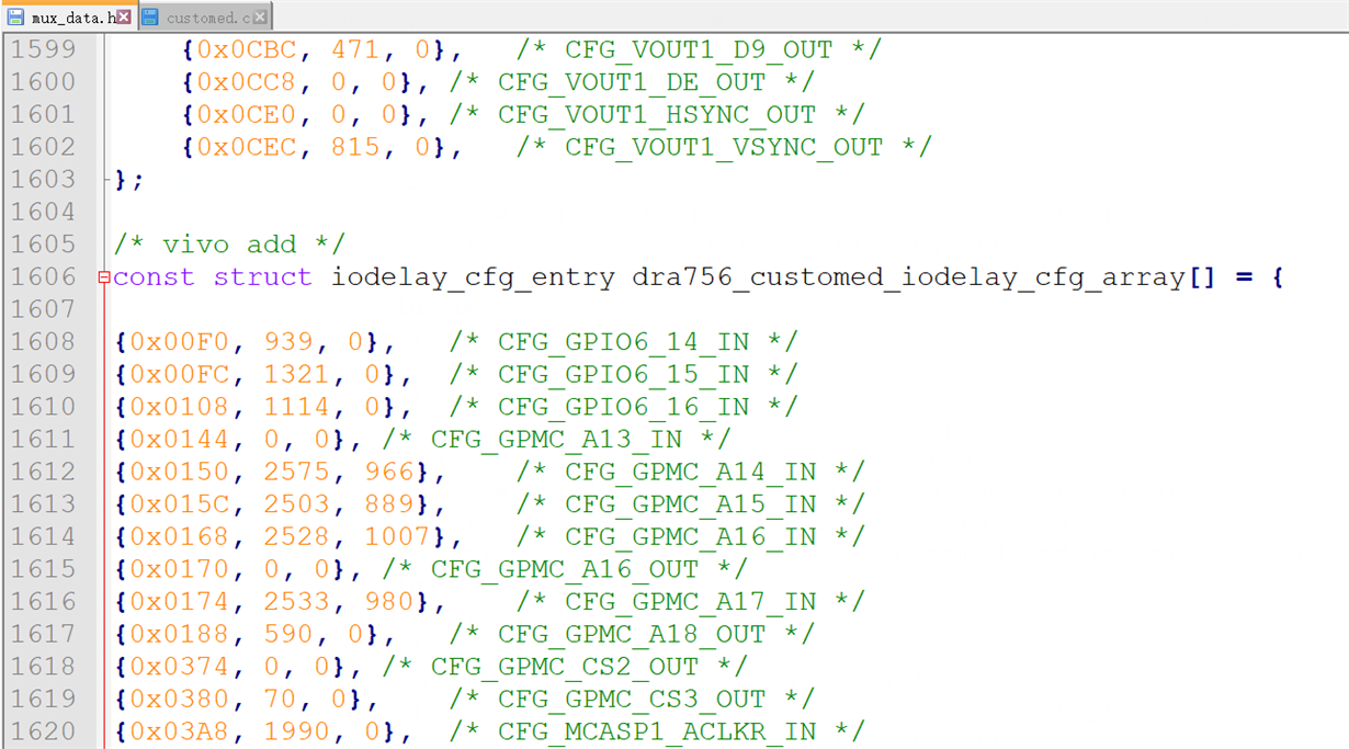

For u-boot, mac related configuration is here. mux_data.h is update with new pad configuration and pad IO delay. However, pad IO delay is genrated by TI pin mux tool and not changed.

We need to move the pinmux to u-boot and also add iodelay values in u-boot and check the behavior.
You can look at TI EVM example in u-boot (board_ti/dra7xx/evm.c, mux_data.h)
Vishal

For iodelay, the files I uploaded before and attached here (7752.dra7xx_customed.zip) again. As you can see, in zip file, mux_data.h and customed.c files contains iodelay related code, which are shown in below figures. The delays values are generated with TI pinmux tool, is there any need to compensate the values and how to do the compensation work ?

The u-boot no clock issue was root caused to pin mux not being done in u-boot (calibrate_iodelay API failure)
This needs to be root caused as the IO lines will have problems without proper iodelay recalibration.
