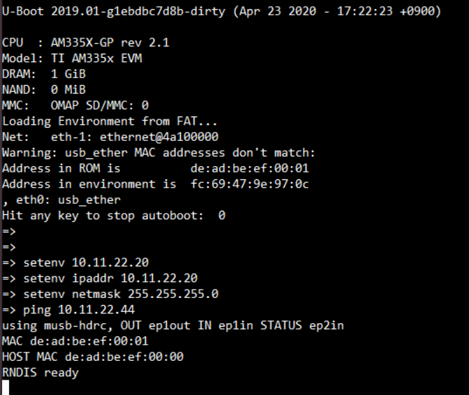

When I checked cpsw_ALE control register, it was all '0' as below, but I think it should be set to '1' in the 'vlan_aware' bit field at least because they should use 'dual mac' mode. is my observation right?
CONTROL 0x00000000
And also, could you please let me know what should be done to make working rgmii2 in the u-boot?
When they tried to ping, there was no response.
And, I'm curious why 'RNDIS ready' was printed in the console. they just make few modification for their custom board from the u-boot source of PSDK.
Thanks and Best Regards,
SI.

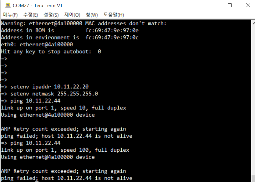

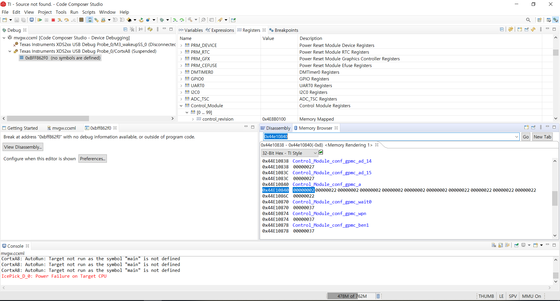

  • Hi Andras,
    I checked control register for gpmc_a0~11 and found the modes were set to '02' properly, but still failed in ping as below.
    It seems the negotiation with PC was done well and I found the connection was changed as 100Mbps when the speed was changed in the PC setting.
    When I checked CPSW_ALE control register, I found c still was not set and all bits are zero.
    Is it right ale_vlan_aware bit should be set to enable RMII2 in uboot?
    In their test, they just enabled RGMII2 only just for test to make clear RGMII pinmux setting as below.
    } else if (board_is_customer()) {
    //configure_module_pin_mux(mii1_pin_mux);
    configure_module_pin_mux(rgmii2_pin_mux);
    SI.
  • SI,
    just to confirm, their first network interface is working as expected, it's just the second one (RGMII2) that they have trouble with? Is this the same issue on all of their boards of that type, assuming there is more than one?
    Before digging a bit deeper, a common reason for the connection not working is an improper "phy-mode" DTS setting. Can you please experiment with the associated setting as suggested in this E2E post https://e2e.ti.com/support/processors/f/791/p/894279/3314324#3314324 and report back.
    If that still doesn't help please share schematic extract showing the connections between the AM335x SOC and the PHY, plus the circuitry around the PHY, so I can double-check this piece.
    Regards, Andreas

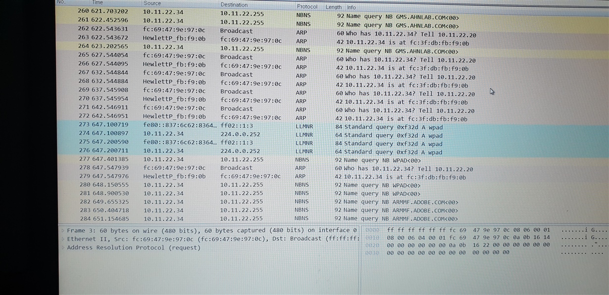

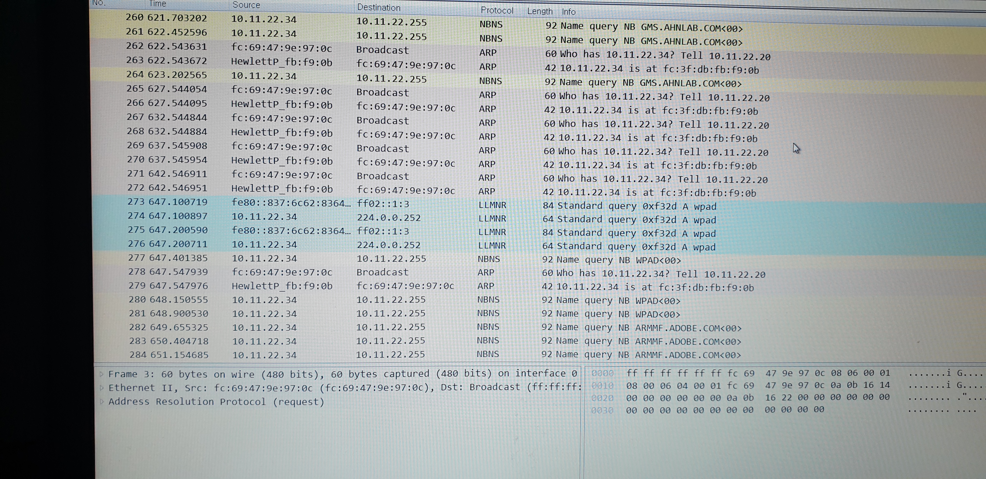

  • Hi Adreas,
    When they checked the network log, they found there was no progress after ARP packet.
    Could you please check their HW schematic?(ping.zip) Do you think there is still an issue in their setup of PHY in their UBOOT SW?
    ping.zip
    Please check below network log also.
    SI.
  • SI,
    thanks for the additional info and the schematic. Please give me a day to review things in a bit more detail.
    As for the ARP request, I can't see anything on that screenshot. The important thing is, do you see the board sending out an ARP request packet (note that U-Boot will never respond to incoming ARP requests)?
    Have you heard back from the suggested phy-mode experiments?
    Also can you see if they can build up and test a second board, so we know that the issue occurs consistently, and is not an outlier?
    Regards, Andreas

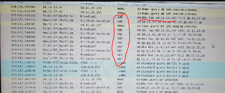

  • Hi Adreas,
    Yes. we believe the board sending out an ARP request packet, but the U-Boot will never response to incoming ARP requests.
    And, unfortunately I heard there was no improvement in the phy-mode experiments.
    We found ARP requests in below, but there was no response in the U-Boot.
    the ip address of PC is 10.11.22.34 and the target custom board is 10.11.22.20 in below.
    SI.

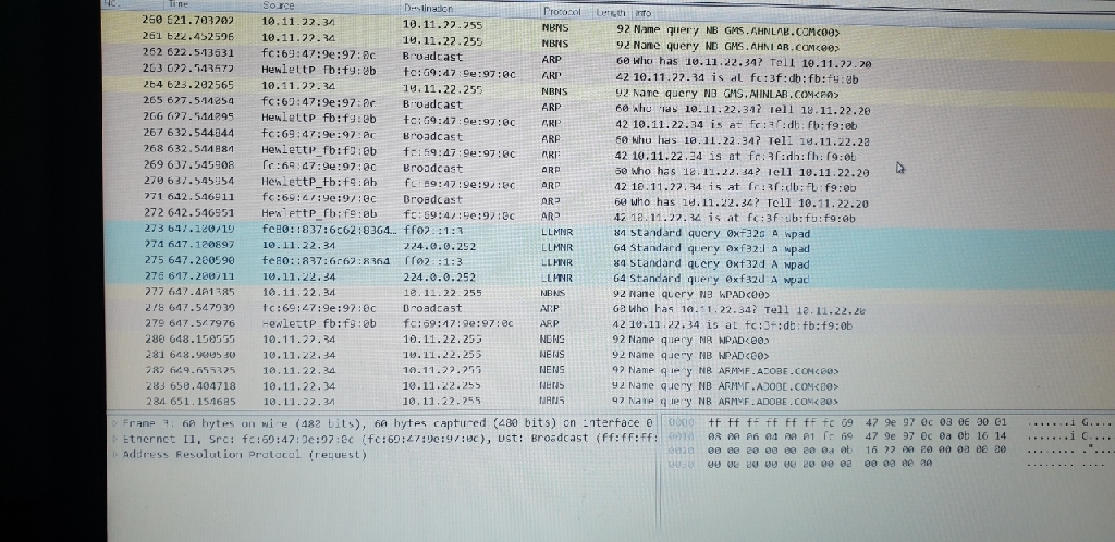

  • Hi Andreas,
    Is there any update?
    I uploaded again the log of wire shark in below.
    Fc:69:47:~~~ is the AM3352 target board and hewlettP_fb:~~ is the PC.
    SI.
  • SI,
    thanks that screenshot is a lot better, and the ARP request/responses are visible.
    I reviewed the HW, and it looks okay I think. It seems aligned with http://www.ti.com/tool/TIDA-00204 which was probably used as a reference for the design I suppose?
    A couple of points:
    • I can't find a datasheet for the magnetic RJ45 connector (CON4) but I noticed that the TRDC- signal is connected to the TXD3+ signal, and vice versa. All other signal pairs have "-" connected to "-", and "+" connected to "+". It could be possible that there is a connection issue here. I've experienced this myself in the past that networking was not working because of a mis-wired connector or magnetic. Sometimes it can be made work (for testing) by cutting an Ethernet cable, and re-arranging the wire pairs (trying different combinations). I've had success with that in the past, but it probably isn't a workaround for all possible mis-wirings that can happen.
    • is the CONFIG_PHY_TI option turned on in U-Boot? It's a dedicated driver for the DP83867 PHY, which also reads a variety of device tree properties for configuration purposes, see example boards using git grep -i DP83867 arch/arm/dts/  and also check the DTS bindings document at doc/device-tree-bindings/net/ti,dp83867.txt.
    • Note that the reference design has strap resistors on RX_D6 to configure RGMII mode, whereas the customer design has not. But the PHY device driver should be able to take care of this too via dp83867_config(). Might be worth adding some printf()s to that function to make sure the right code path is being executed.
    I'm also going to check with one of my colleagues who is more of a networking domain expert to see if it can read something from the symptoms.

    My customer also found tx clock was not changed even when change connection modes(10/100/1000) in the PC although RX clock was changed properly.
    Do you have any idea what should be checked further in this case?

    I also found tx clock was not changed well although rx clock was changed along with 10/100/1000 mode change. e.g. When they set the PC to 1G bps mode, the TX clock of DP83867 to AM3352 in their target board was set to 125Mhz, and then it was changed to 25Mhz at 100Mbps mode, but was not changed to 2.5Mhz at 10Mbps. Do you think there is an issue between GMAC of AM3352 and DP83867?
    I see you are using U-Boot 2019.01, but can you check if you have the following commit in your tree:
    net: ti: cpsw: enable 10Mbps link speed support in rgmii mode
    https://git.ti.com/cgit/processor-sdk/processor-sdk-u-boot/commit/drivers/net/ti/cpsw.c?h=processor-sdk-u-boot-2019.01&id=a1578d58b46efddd889a5b335885c5b1d3498b52
    If I look at the PHY datasheet it seems like the GTX_CLK signal (input to the PHY) is always 125MHz as per "Pin Functions" table, so assuming that this is what you measured I don't think that is an issue. But if you can you could probe the "TX_CLK" signal, which should reflect the link speed.
    A lot of things seem to be working already as you can send out ARP requests and see them on the other side. I'm checking again with my colleague once again but to me it seems like this could be a hardware issue. You mentioned only one board was built, so I'd try to get another one setup to have another data point. Then, it might be worth probing the RX_Dx signals on the PHY with an oscilloscope to see if there is activity during ARP/ARP response. Also have you tried re-arranging the Ethernet wires to see if that makes a difference?
    Regards, Andreas
