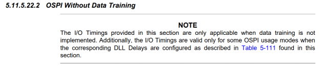

    Karan Saxena said:
    As per 12.3.2.4.14 OSPI PHY Module of TRM, OSPI functional clock should be at least 4 times that of OSPI bus clock in order to use No PHY mode. So in order for 143MHz bus clock (as mentioned in data manual), we need an input functional clock of 572MHz. But OSPI module does not support such high functional clock. The Data Manual needs an update and this discussion has rightly triggered that.
    A correction here, seems like there is not update required to the Data Manual. So the mistake here was confusing PHY mode with data training. "No data training" still has the PHY on, and the requirement that functional clock be 4x the speed of the bus clock does not apply. But instead of using a tuning algorithm (data training) to select the PHYs TX and RX delays, you use a fixed TX/RX values found in table 5-111. See this note:
    So it should be possible to operate at 140MHz if you follow table 5-111.
    Apologies for initial confusion.

  • Hi ,Karan
    Based on your response, I have the following questions:
    1. What is data training? How to enable and use data training mode to achieve 5ns (corresponding clock is 200MHz) in 1.8V platform SDR mode?
    2. Do you mean that when data training is not used, I can set the most suitable DLL DELAY in PHY mode to achieve a time of 7ns (corresponding clock 142MHz)?
    3. Is there any example code to obtain the operation related to the maximum clock frequency?
    Thanks!
