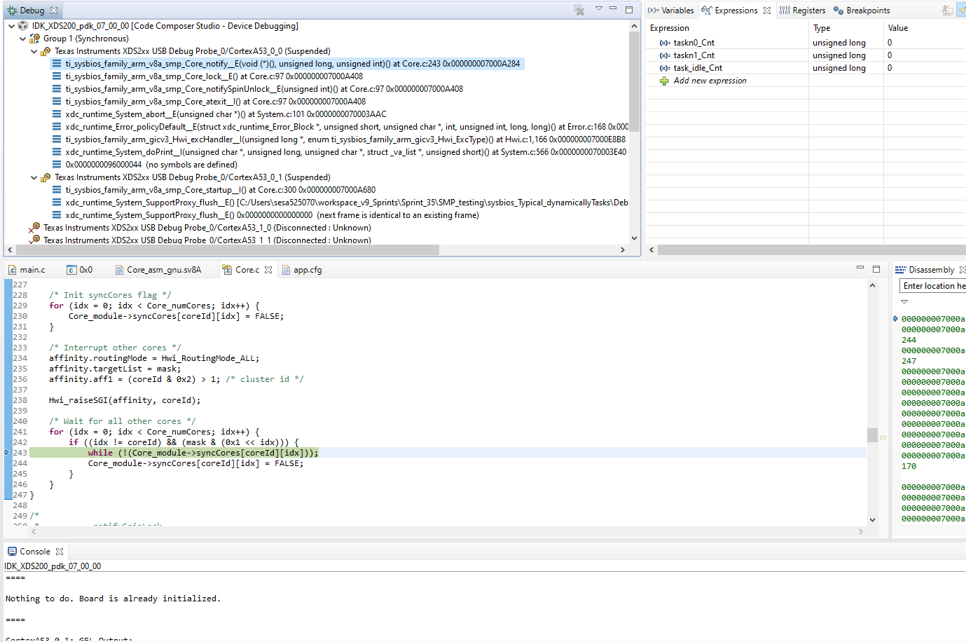

  • Hello Dave,
    I insalled new SDK 7.0 on my side. I was able to build and run both UART_SMP_TestApp and UART_DMA_SMP_TestApp examples from SDK 7.0, and i can confirmed those examples are working on my side.
    Then i made simple SYSBIOS project in CCS without configured SMP. My idea was to create two simple tasks in which i will increment the counter variables each time when some of those two task is run by BIOS. I created both task dynamically in main() function by using "Task_create()" function. But when i tried to build that project i had build error:
    sdk_07_00_00_Bios_DynamicallyTasks.zip

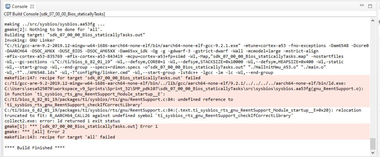

    Then I created both task statically in bios config file (.cfg) and when i tried to build project i didn't have any error and i was able to run that code on IDK board.
    sdk_07_00_00_Bios_StaticallyTasks.zip
    NOTE:
    To build code i was using tools from SDK 7.0 (xdctools_3_61_00_16, bios_6_82_01_19 and gcc-arm-9.2-2019.12-mingw-w64-i686-aarch64-none-elf)
    Just to be shure, i tried to build both version of projects (with statically and dynamically created tasks) with previous version of SDK 6.3 (xdc_tool_3_55_02_22, bios_6_76_03_01, gcc-linaro-7.2.1-2017.11-i686-mingw32_aarch64-elf) . Both version of project were compiled without any error.
    In our application we are creating all Bios object (task, semaphore...) dynamically so it is important for us to have this option.

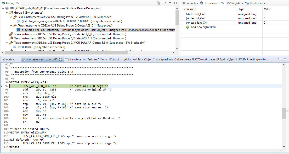

    Q1: Can you help me to figure out why when i use SDK 7.0 i am not able to build project in which tasks were created dynamically ?
    Then i continued to work on SMP by using bios project where task were created statically. I made all modifictaion that are needed to be done to run SMP.
    For first task i set affinity to 0 (run first task on first core) and for second task i set affinity to 1. I was able to compile code without error and to run code on both cores.
    But the problem occured when i tried to pause and continue with code execution or when i tried to continue with execution after breakpoint.
    Source, bios config and linker file that i am using are given above under name  sdk_07_00_00_Bios_StaticallyTasks.zip
    I have created a video with screen capture to show what i did and after which action the problem occurs.
    Q2: Do you have idea what can cause this problem?
    Thank You very much in advance,
    Novica

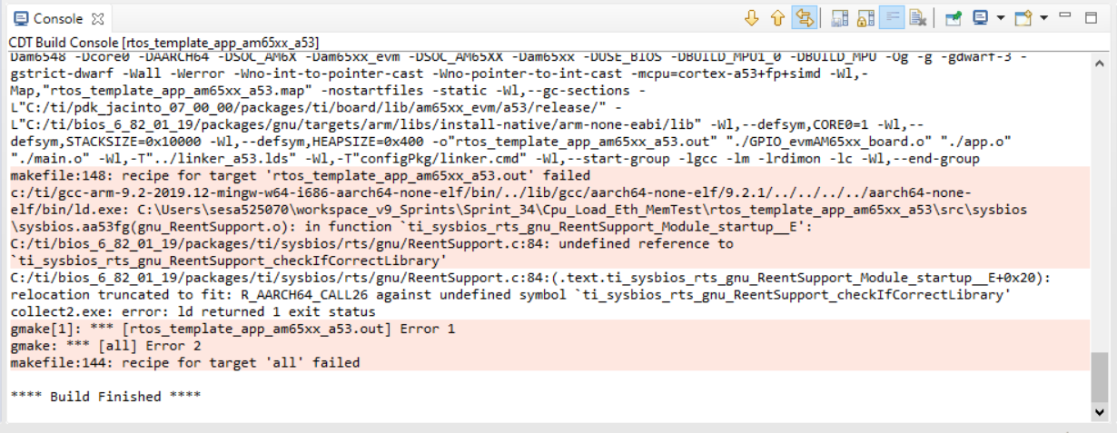

  • Hello Dave,
    One update from my side.  I noticed few strange things regarding to newest SDK.
    1. First one is when i tried to import rtos_template_app_am65xx_a53 example from processor_sdk_rtos_am65xx_07_00_00_05 i noticed that example is configured to use tools/components from previous SDK 6.3 instead of newest SDK 7.0. When i changed tools/component to newest SDK 7.0 and i tried to build this project i got following error:
    2. Then i tried to generate usb CCS project by using pdkProjectCreate.bat script from newest pdk_jacinto_07_00_00. But i had following error:
    3. Then i tried include and use newest PDK in SYS/BIOS project with statically created tasks from previous post. I included UART driver from PDK but when i tried to build this example i got an error:
    Novica
  • Novica,
    I had previously recompiled the SMP examples from the command line and used CCS to load and run only... I did not check from within a CCS project.
    I do see the same error when importing and compiling the BIOS version of the template app (baremetal compiles fine). I'll follow up and see what the issue is here.
    Dave
  • Regarding the undefined reference to ti_sysbios_rts_gnu_ReentSupport_checkIfCorrectLibrary:
    We've had the same issue after migrating our application to the new SDK. There is a Library search path in the template application that points at ${xdc_find:gnu/targets/arm/libs/install-native/arm-none-eabi/lib:${ProjName}}
    This is apparently wrong for the A53, although I'm not sure how this worked for SDK 06.03. Anyway, we fixed this by changing the library search path to ${xdc_find:gnu/targets/arm/libs/install-native/aarch64-none-elf/lib:${ProjName}}
    Dominic
  • Dominic,
    You are right. There are 5 files that need to be updated (carry-over from SDK6.3 that weren't modified):
    <pdk>\demos\rtos_template_app\am65xx\components_am65xx.dtd:  change to "com.ti.pdk.jacinto:7.0.0"
    <pdk>\demos\rtos_template_app\common\cgt_a53_ver.dtd: change to "GNU_9.2.1:null aarch64"
    <pdk>\demos\rtos_template_app\common\common_components.dtd: change to "com.ti.rtsc.SYSBIOS:6.82.01.19"
    <pdk>\demos\rtos_template_app\common\xdc_ver.dtd: change to "3_61_00_16_core"
    <pdk>\demos\rtos_template_app\am65xx\evmAM65xx\A53\template_app\rtos\rtos_template_app_am65xx_a53_evmAM65xx.projectspec: change lib path to "-L${xdc_find:gnu/targets/arm/libs/install-native/aarch64-none-elf/lib:${ProjName}}"
    With these changes the CCS project should build properly. This has been filed for correction to the SDK for the next release.
    Dave

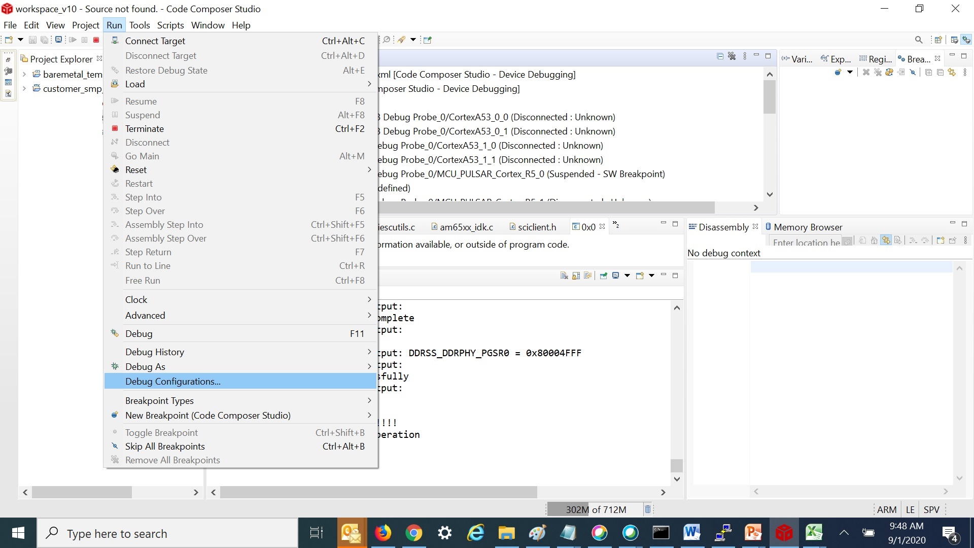

  • Novica,
    Thanks for pointing out the image didn't post properly. I've attached two images. What I'm looking to point out and confirm is that you have disabled the run-to-symbol option for both cores in the SMP cluster. In my earlier testing I had disabled only for Core0, but not for Core1 and this was causing problems.
    Dave
  • Hi Dave,
    Thanks for clarifying this.
    I disabled the run-to-symbol option for both cores for the SMP cluster in the debug configuration and i made following tests:

    Then in the same project (with statically created tasks) i add UART driver to print somthing on UART0. I can build project without error but when i tried to run code the code execution is stuck on line 97 in file  Hwi_asm_vecs_gnu.sv8A:
    But when i remove MMU init code from BIOS config file i can run the code and i can do SMP debuging without problem. I removed following code from BIos config file.
    var Mmu = xdc.useModule('ti.sysbios.family.arm.v8a.Mmu');
    Mmu.initFunc = "&HalInitMmu";
    Mmu.tableArrayLen = 30;
    Does in the case when the SMP is enabled, the initialization of the MMU must be done differently?

    Then i continued with further testing. Now, instead to create all tasks statically in bios config file I create tasks dynamically in main function (in our project all BIOS object are created dynamically).
     I can build project without error but when i tried to run code on sync group the code is stuck in file C:\ti\bios_6_82_01_19\packages\ti\sysbios\family\arm\v8a\smp\Core.c
    https://e2e.ti.com/cfs-file/__key/communityserver-discussions-components-files/791/sysbios_5F00_Typical_5F00_dynamicallyTasks.7z
    Can you try to run both projects on your side?
    Do you have the same results of testing on your side as i did or these tests fails only on my side.

  • Hi Vineet,
    now I tested according to your last post.
    But I did the tests with latest CCS v10.2.
    As you described, I imported rtos_template_app_am65xx_a53 and applyed your patch.
    In your patch, in function biosTaskCreate() the new function argument affinity was not applied to the taskParams.
    I corrected that.
    Then I created the Sync Group, loaded the program and let it run.
    It seem to run as expected.
    To confirm SMP behavior, I replaced LED blinking in GPIO task with just incrementing counter and removed task_sleep() so that task would never yield.
    As GPIO task has higher priority than uart task if both are running on the same core uart task would never execute which is not the case.
    Then I inspected the debugging problems we had so far.
    Result:
    1. Using HW Breakpoints seem to work
    2. Single-stepping seem to work
    3. Using SW Breakpoints does NOT reliably work well.
      The SW breakpoint adds a "hlt #0" instruction at the location, and does not remove it anymore.
      So the execution gets stuck at this location and does never resume.
    4. "Step-Over" does NOT work, since this implicitely uses SW breakpoints

  • Hi again Jian,
    now I did a further test with exactly the project you sent me (without the affinity fix).
    It shows the same issues as I had before: When using "step over" the core keeps haltet.
    See this picture:
    Could you try again at your setup?
