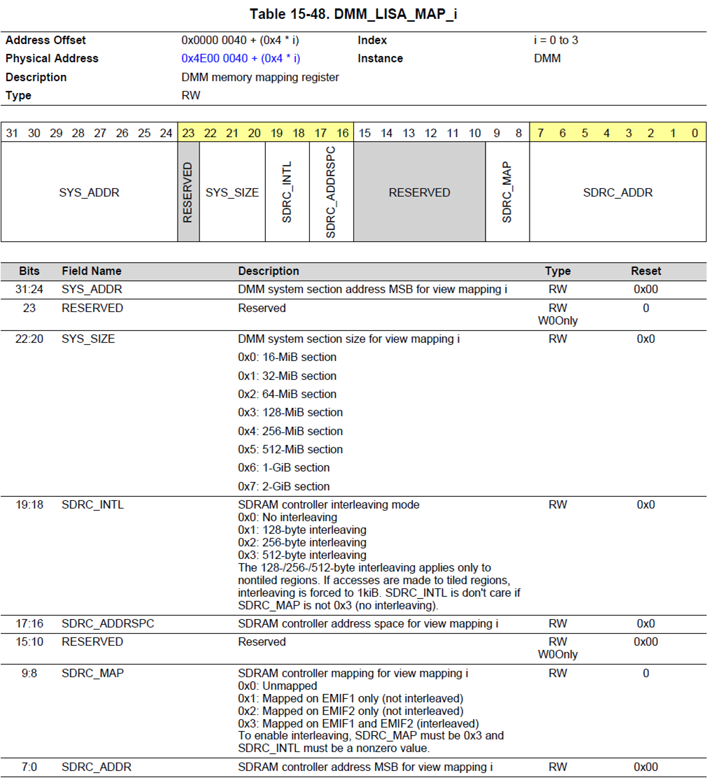

    This is wxchen, the Rio's customer.
    1) I wanna know how to enlarge heap size on RTOS(SR1_FRAME_BUFFER_SIZE in mem_segment_definition_bios.xs, please correct  me if i wrong) at EMIFMODE=DUAL_EMIF_2X512MB setup.
        is it possible to having continuous memory on RTOS using both of EMIF1 & EMIF2?
    2) I also wanna know how to setup EMIDMODE=DUAL_EMIF_1GB_512MB and SINGLE_EMIF_1GB,
        I have referred the settings written on https://e2e.ti.com/support/processors/f/791/p/613857/2277707, but evm-board will stuck on booting.
        Is there any document indicating that changing memory map to DUAL_EMIF_1GB_512MB and SINGLE_EMIF_1GB? ( i found how to change memory map to DUAL_EMIF_2X512MB on VisionSDK_UserGuide_MemoryMap.pdf in VSDK, and i successed changing memory map to DUAL_EMIF_2X512MB by steps of that document. )
    3) In addition, what’s exactly HW setup for EMIFMODE=DUAL_EMIF_2X512MB? Is it using two EMIF modules and dual 512 MB DDR chips for each EMIF?
    Wxchen
  • HI,
    The  supported EMIFMODE option in TDA2XX are
    EMIFMODE = SINGLE_EMIF_512MB (default) or you can set below options
    DUAL_EMIF_1GB_512MB or
    DUAL_EMIF_2X512MB or
    SINGLE_EMIF_256MB
    NOTE:
    DUAL_EMIF_1GB_512MB : uses EMIF2 - 1GB and EMIF1 512MB, BUT in non-interleaved mode
    Vision SDK uses only 1GB hence effectivly this is single EMIF
    non-interleaved mode for Vision SDK
    0x8000_0000 - 0xBFFF_FFFF is mapped to EMIF2
    0xC000_0000 - 0xDFFF_FFFF is mapped to EMIF1
    DUAL_EMIF_2X512MB : uses EMIF1 and EMIF 512MB each in interleaved mode
    0x8000_0000 - 0x9FFF_FFFF is interleaved between EMIF1 and EMIF2
    SINGLE_EMIF_256MB : uses EMIF1 with 256MB
    0x8000_0000 - 0x8FFF_FFFF is mapped to EMIF1
    SINGLE_EMIF_512MB : uses EMIF1 with 512MB
    0x8000_0000 - 0x9FFF_FFFF is mapped to EMIF1
    By default, TDA2XX is configured with SINGLE_EMIF_512MB & here we will get SR1 memory around 250MB. If it is not sufficient for TIDL processing you choose the DUAL_EMIF_2X512MB option. In this configuration, we will get SR1 around 430MB. After choosing EMIFMODE=DUAL_EMIF_2X512MB we have to apply some patches to work & this is already explained in the "VisionSDK_UserGuide_MemoryMap.pdf". But this is not updated with the latest SDK version. So please add the below changes in your code to work properly.

    3) However, I was trying to setup SINGLE_EMIF_1GB. At first, I referred to TRM and I modified the HW setup inside SBL(as following figure),
        and then I modified the memory map to SINGLE_EMIF_1GB.
        But, the evm board stuck on booting (message as shown below).

    1) because of the HW setup is 512+512mb, but your providing setup was swapping eve & dsp to second section and made the first section of SR1_FRAME_BUFFER larger about 100mb, i'd like to know why can't I allocate memory up to 330MB+512MB.
    2) because DDR of my target board will be designed to SINGLE_EMIF and most likely to 1GiB, I want to try it first on evm board.

    It is possible to map 330+512 MB to SR1. You need to update SR1_FRAME_BUFFER_SIZE in mem_segment_definition_bios.xs in order to increase the size of SR1.
    Regarding the question on A15 MMU/AMMU/VPS mappings, one can map 0x8000_0000 virtual address to 0x8000_0000 physical address and 0xA000_0000 VA to 0xA000_0000 PA if there is enough memory. However in case there is only 512 MB on the system then the use needs to map 0xA000_0000 virtual address to 0x8000_0000 physical address.
