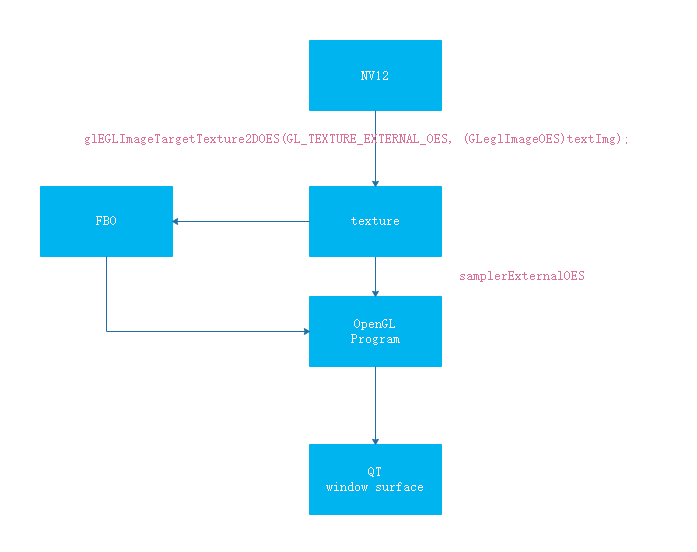

As you known, the OpenGL on visonSDK only support the NV12 input, thus when we bind the texture, have to use
    glGenTextures(1, outTexIndex);
    System_eglCheckGlError("glGenTextures");
    printf("outTexIndex 0x%x \n",*outTexIndex);
    glBindTexture(GL_TEXTURE_EXTERNAL_OES, *outTexIndex);
    System_eglCheckGlError("glBindTexture");
    glTexParameteri(GL_TEXTURE_EXTERNAL_OES, GL_TEXTURE_MIN_FILTER, GL_LINEAR);
    glTexParameteri(GL_TEXTURE_EXTERNAL_OES, GL_TEXTURE_MAG_FILTER, GL_LINEAR);
    System_eglCheckGlError("glTexParameteri");
    glEGLImageTargetTexture2DOES(GL_TEXTURE_EXTERNAL_OES, (GLeglImageOES)textImg);
    System_eglCheckGlError("glEGLImageTargetTexture2DOES");

for above code, how we can use the FBO with NV12?
per discussed before, the FBO only support the RGB, that means we can't use FBO with NV12?

  • Hi Hemant:
      see the flow of my case:
    1. did the visionsdk OpenGL support the RGB as texture? all the glsl using samplerExternalOES which to load NV12
    2. for the FBO, as previous post said, FBO only support RGB, if so how can render it with NV12 texutue together
    3. did FBO support NV12?
    above all, the FBO input should be NV12,and which format does FBO output? RGB or NV12. and can you share some sample code to demo this?
    thanks....
    Both RGB and YUV textures are supported.
    FBO supports RGB and the GPU will convert YUV to RGB.
    On TDA2, FBO has to be RGB. Does your use case need YUV output?

  • Hi Hemant:
    it seem to use YUV, because other texture is YUV, we don't know whether the tda2 support use RGB and YUV mixed
    You can read YUV texture and output to RGB FBO. You can use EXT_image_dma_buf_import to create an NV12 EGL Image and then use GL_OES_EGL_image_external to read the image as a texture. Your FBO can continue to be RGB format.
    Hemant
  • Hi Hemant:
      per discussion above, we looks need to use FBO with YUV not the RGB, can you share how to use FBO with YUV texture?
  • Hi Hemant:
    But the RGB FBO should render together with the YUV texture as it's the parts of whole rendering like card model, camera image.
