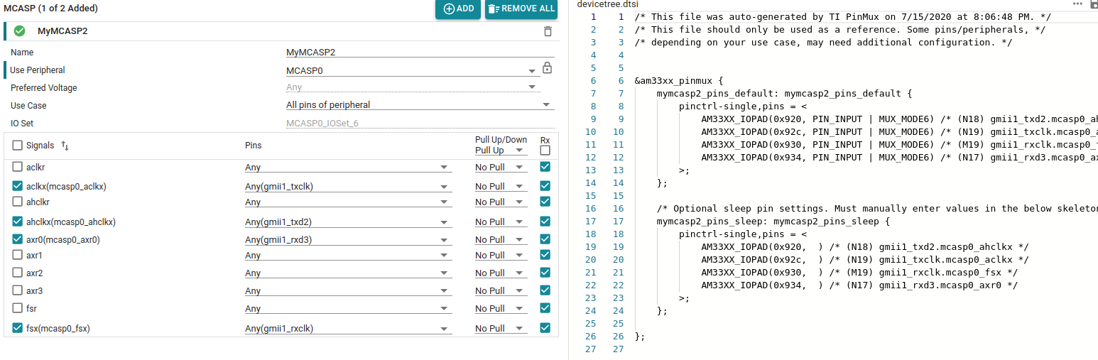

AM3358: dts config for AM3358 for McASP0
Part Number: AM3358
Other Parts Discussed in Thread: TLV320DAC3100
I need to configure I2S lines for AM3358 with McASP0.
im unable to figure out the exact dts config for it.
Another thing i want to understand is that how to confirm whether that line has been configured as per requirement.
