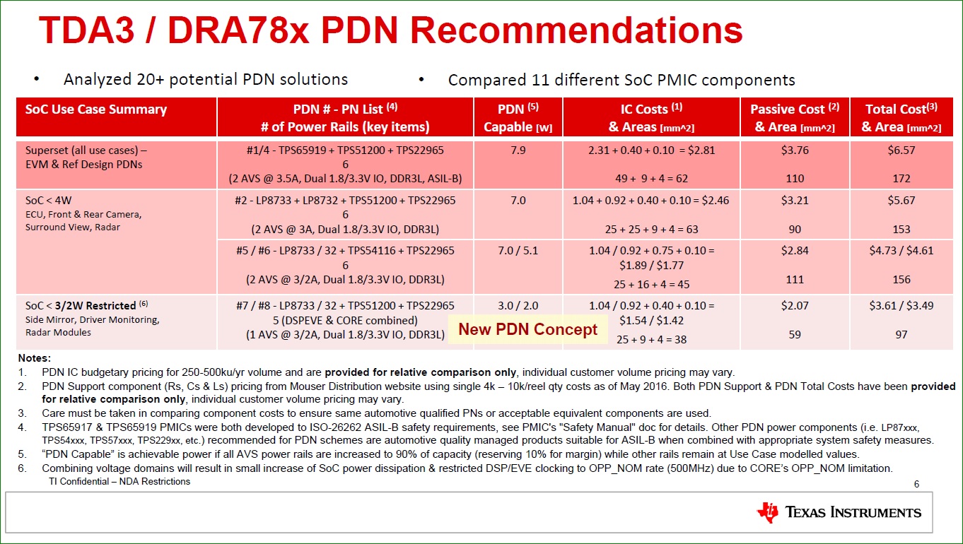

I'd like to check the compatible PMIC of TDA3MVSBFABFQ1 for automotive DMS application. Could you recommend a PMIC like TPS65919-Q1(O919A152TRGZRQ1) for TDA3MVSBFABFQ1?
Regards, Jeffrey
  • There are 3 different PMICs (TPS65919, LP8733 & LP8732) recommended for TDA3 PDNs depending upon processor resource loadings & resulting SoC power. Attached PDN Recommendations summary show 4 different PDNs capable of supplying 5.1 to 7.9W
  • Hi Robert,
    Thanks for your recommendations. Let me decide a PMIC for TDA3MVSBFABFQ1 depending on current consumption as you comment. I'll ask you more questions if I have some issues.
    Regards, Jeffrey
