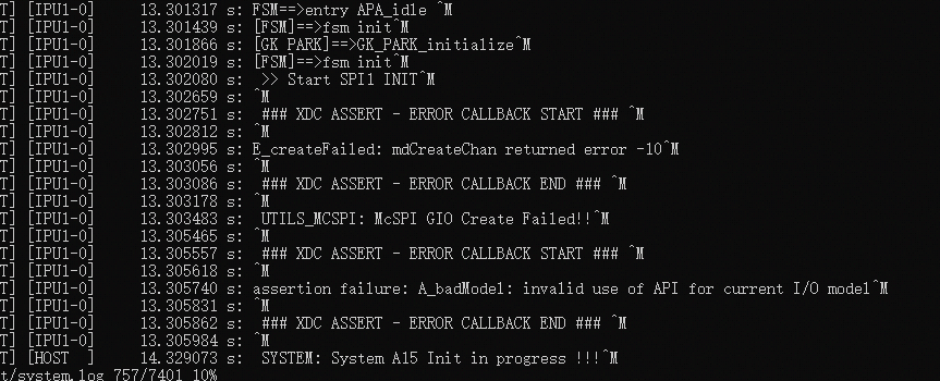

I edit "links_fw/src/rtos/utils_common/src/utils_mcspi.c" to make it support MCSPI_OPMODE_INTERRUPT and slave mode.
But since CPU load problem, I need use MCSPI_OPMODE_DMAINTERRUPT and slave mode. But just change opMode seems it not enough, I got:
I attached my utils_mcspi.c file, would you please help to check why it return this error?

    Utils_mcspiCommHandle commHndl = (Utils_mcspiCommHandle) fd;
    GIO_delete((GIO_Handle *) &commHndl->mcspiHandle);
    return SYSTEM_LINK_STATUS_SOK;
Int32 Utils_mcspiReadWrite(void * fd, UInt8 *pRxBuff,UInt8 *pTxBuff, UInt16 len)
    UInt32                    size             = 0U;
    Int                       status           = IOM_COMPLETED;
    Mcspi_DataParam           issueDataparam   = {0};
    Mcspi_DataParam           reclaimDataparam = {0};
    Ptr                       pReclaimDataParam;
    Int32                     retVal   = SYSTEM_LINK_STATUS_SOK;
    commHndl->mcspiIoPrms.timeout = 1000 * 1000;
    issueDataparam.inBuffer = (UInt8 *) pRxBuff;
    issueDataparam.outBuffer = (UInt8 *) pTxBuff;
    issueDataparam.bufLen   = (UInt32) len;
    if ((UInt32)len > 0x1000U)
        /* Something is wrong if this condition is met */
        Vps_printf(" UTILS_MCSPI: Too large read requested!! Length = %x\r\n",
                  (UInt32)len);
        retVal = SYSTEM_LINK_STATUS_EFAIL;
    if (retVal == SYSTEM_LINK_STATUS_SOK)
        size = (UInt32)len;
        /* Issue the first & second empty buffers to the input stream */
        status = GIO_issue(commHndl->mcspiHandle, &issueDataparam, size,
                           NULL);
        if ((status != IOM_PENDING) && (status != IOM_COMPLETED))
            Vps_printf(" UTILS_MCSPI: Failed to issue empty buffer to stream!!\r\n");
        /* Reclaim is done after every issue and buffers are not primed. If
         * the buffers are primed next transfer is initialized as soon as
         * the first one is completed. We wont be able to ensure transfer
         * initializaton on Slave before master for second buffer
        pReclaimDataParam = (Ptr) & reclaimDataparam;
        status =
            GIO_reclaim((GIO_Object *) commHndl->mcspiHandle,
                        (Ptr *) &pReclaimDataParam,
                        NULL,
                        NULL);
        if (IOM_COMPLETED != status)
            Vps_printf(" UTILS_MCSPI: SPI Read/Write Failed: %d\r\n", status);
        else
            retVal = (Int32) len;
    return retVal;
 * \brief  Function to read from the McSPI device
 * \param fd    Pointer to the McSPI commnication Handle.
 * \param pBuff Pointer to the buffer to which the data is written.
 * \param len   Number of bytes to read.
 * \return  SYSTEM_LINK_STATUS_SOK if operation successful,
 *          SYSTEM_LINK_STATUS_EFAIL otherwise.
Int32 Utils_mcspiRead(void * fd, UInt8 *pBuff, UInt16 len)
    UInt32                    size             = 0U;
    issueDataparam.inBuffer = (UInt8 *) pBuff;
                  (UInt32)len);
        issueDataparam.outBuffer = NULL;
        size = (UInt32)len;
                           NULL);
        status =
                        NULL,
                        NULL);
            Vps_printf(" UTILS_MCSPI: SPI Read Failed: %d\r\n", status);
        else
    return retVal;
 * \brief  Function to write to the McSPI device
Int32 Utils_mcspiWrite(void * fd, UInt8 *pBuff, UInt16 len)
    UInt32                    size             = 0;
    Ptr                       pReclaimDataparam;
    issueDataparam.outBuffer = (UInt8 *) pBuff;
    issueDataparam.inBuffer  = NULL;
    size = (UInt32) len;
                       NULL);
    pReclaimDataparam = (Ptr) & reclaimDataparam;
    status =
        GIO_reclaim(commHndl->mcspiHandle,
                    (Ptr *) &pReclaimDataparam,
                    NULL,
                    NULL);
        Vps_printf(" UTILS_MCSPI: SPI Write Failed: %d\r\n", status);
    else
    return retVal;
static void Utils_mcspiUserSlaveCommonInit(uint32_t mcSPINum)
    static uint32_t done = 0U;
    if (done == 0U)
        Mcspi_init();
        done = 1U;
    memcpy((Void *)&mcspiCfgPrms[mcSPINum], (const Void *)&Mcspi_PARAMS, sizeof(Mcspi_Params));
    /* Set the McSPI parameters */
    mcspiCfgPrms[mcSPINum].instNum = mcSPINum;
    mcspiCfgPrms[mcSPINum].opMode          = MCSPI_OPMODE_DMAINTERRUPT;
    mcspiCfgPrms[mcSPINum].hwiNumber       = 7;
    mcspiCfgPrms[mcSPINum].enableCache     = (UInt32) TRUE;
    mcspiCfgPrms[mcSPINum].edma3EventQueue = 0;
    mcspiCfgPrms[mcSPINum].enableErrIntr   = (UInt32) FALSE;
    mcspiCfgPrms[mcSPINum].prcmPwrmEnable = TRUE;
    mcspiCfgPrms[mcSPINum].spiHWCfgData.masterOrSlave         = MCSPI_COMMMODE_SLAVE;
    mcspiCfgPrms[mcSPINum].spiHWCfgData.singleOrMultiChEnable = MCSPI_SINGLE_CHANNEL;
    mcspiCfgPrms[mcSPINum].spiHWCfgData.pinOpModes    = MCSPI_PINOPMODE_4PIN;
    mcspiCfgPrms[mcSPINum].spiHWCfgData.fifoRxTrigLvl = 32;
    mcspiCfgPrms[mcSPINum].spiHWCfgData.fifoTxTrigLvl = 32;
    mcspiCfgPrms[mcSPINum].spiHWCfgData.configChfmt[0].charLength = MCSPI_LEN_32BIT;
    mcspiCfgPrms[mcSPINum].spiHWCfgData.configChfmt[0].multiWordAccessEnable =
        (UInt32)FALSE;
    mcspiCfgPrms[mcSPINum].spiHWCfgData.configChfmt[0].spiChipSelectEnablePol =
        (UInt32)FALSE;
    mcspiCfgPrms[mcSPINum].spiHWCfgData.configChfmt[0].clockMode =
        MCSPI_MODE0;
    mcspiCfgPrms[mcSPINum].spiHWCfgData.configChfmt[0].clockRatioExtension = 0;
    mcspiCfgPrms[mcSPINum].spiHWCfgData.configChfmt[0].spiWordInitDelay =
        MCSPI_NO_DELAY;
    mcspiCfgPrms[mcSPINum].spiHWCfgData.configChfmt[0].trasmitReceiveMode =
        MCSPI_BOTH_RXTX;
    mcspiCfgPrms[mcSPINum].spiHWCfgData.configChfmt[0].granularityEnable =
        (UInt32)TRUE;
    /* 24 MHz Bus Frequency */
    mcspiCfgPrms[mcSPINum].spiHWCfgData.configChfmt[0].busFreq = 0;
    mcspiCfgPrms[mcSPINum].spiHWCfgData.configChfmt[0].spienHighPolarity =
        (UInt32)FALSE;
    mcspiCfgPrms[mcSPINum].spiHWCfgData.configChfmt[0].slaveModeChipSelect =
        MCSPI_SPIEN_0;
    mcspiCfgPrms[mcSPINum].spiHWCfgData.configChfmt[0].spiDat0Dir = MCSPI_IN;
    mcspiCfgPrms[mcSPINum].spiHWCfgData.configChfmt[0].spiDat1Dir = MCSPI_OUT;
    if (MCSPI_OPMODE_INTERRUPT == mcspiCfgPrms[mcSPINum].opMode) {
        Vps_printf(" UTILS_MCSPI: %s is configured in interrupt mode!!\r\n", gMcspiDriverNames[mcSPINum]);
static void Utils_mcspi0UserInit(void)
    Utils_mcspiUserSlaveCommonInit(0U);
static void Utils_mcspi1UserInit(void)
    Utils_mcspiUserSlaveCommonInit(1U);
static void Utils_mcspi2UserInit(void)
    Utils_mcspiUserCommonInit(2U);
static void Utils_mcspi3UserInit(void)
    Utils_mcspiUserCommonInit(3U);
static void Utils_mcspiUserCommonInit(uint32_t mcSPINum)
    UInt32       i = 0U;
    if (done == 0U)
        Mcspi_init();
        done = 1U;
    mcspiCfgPrms[mcSPINum].opMode          = MCSPI_OPMODE_INTERRUPT;
    mcspiCfgPrms[mcSPINum].spiHWCfgData.masterOrSlave         = MCSPI_COMMMODE_MASTER;
    mcspiCfgPrms[mcSPINum].spiHWCfgData.singleOrMultiChEnable = MCSPI_MULTI_CHANNEL;
    for (i = 0U; i < CSL_MCSPI_0_NumOfPhyChannels; i++)
        mcspiCfgPrms[mcSPINum].spiHWCfgData.configChfmt[i].charLength = MCSPI_LEN_16BIT;
        mcspiCfgPrms[mcSPINum].spiHWCfgData.configChfmt[i].multiWordAccessEnable =
            (UInt32) FALSE;
        mcspiCfgPrms[mcSPINum].spiHWCfgData.configChfmt[i].spiChipSelectEnablePol =
            (UInt32) FALSE;
        mcspiCfgPrms[mcSPINum].spiHWCfgData.configChfmt[i].clockMode =
            MCSPI_MODE0;
        mcspiCfgPrms[mcSPINum].spiHWCfgData.configChfmt[i].clockRatioExtension = 0;
        mcspiCfgPrms[mcSPINum].spiHWCfgData.configChfmt[i].spiWordInitDelay    =
            MCSPI_NO_DELAY;
        mcspiCfgPrms[mcSPINum].spiHWCfgData.configChfmt[i].trasmitReceiveMode =
            MCSPI_BOTH_RXTX;
        mcspiCfgPrms[mcSPINum].spiHWCfgData.configChfmt[i].granularityEnable =
            (UInt32) TRUE;
#if defined (TDA3XX_AR12_ALPS)
        /* 8 MHz Bus Frequency */
        mcspiCfgPrms[mcSPINum].spiHWCfgData.configChfmt[i].busFreq           = 8000000;
#else
        mcspiCfgPrms[mcSPINum].spiHWCfgData.configChfmt[i].busFreq           = 24000000;
#endif
        mcspiCfgPrms[mcSPINum].spiHWCfgData.configChfmt[i].spienHighPolarity =
            (UInt32) FALSE;
        mcspiCfgPrms[mcSPINum].spiHWCfgData.configChfmt[i].slaveModeChipSelect =
            MCSPI_SPIEN_0;
#if defined (RADAR_ONLY) && defined(SOC_TDA2XX)
        if (mcSPINum == 2)
            mcspiCfgPrms[mcSPINum].spiHWCfgData.configChfmt[i].spiDat0Dir = MCSPI_IN;
            mcspiCfgPrms[mcSPINum].spiHWCfgData.configChfmt[i].spiDat1Dir = MCSPI_OUT;
        else
            mcspiCfgPrms[mcSPINum].spiHWCfgData.configChfmt[i].spiDat0Dir = MCSPI_OUT;
            mcspiCfgPrms[mcSPINum].spiHWCfgData.configChfmt[i].spiDat1Dir = MCSPI_IN;
#else
#endif
        Vps_printf(" UTILS_MCSPI: McSPI is configured in interrupt mode!!\r\n");
Thanks a lot!
