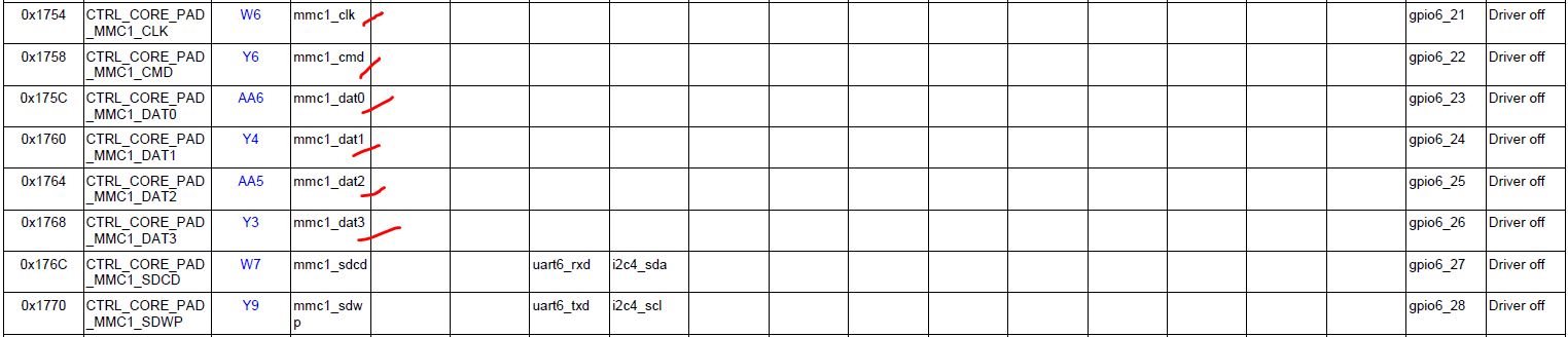

2. I probed the MMC1_CMD and MMC1_CLK lines on the board and I see that neither of them is toggling when the command is submitted to the controller. This in a way explains why the command timed out, but now I am not sure why the lines are not toggling
3. I checked the Pinmux configuration of the MMC1 pins W6, Y6, AA6, Y4, AA5 & Y3. W7 and Y9 are not configured as our SDIO device is I/O only. I see that all six pins have pinmux configuration value of 0x00060000, ie, all are in MMC1 mode with MMC1_CLK_PULLTYPESELECT and MMC1_CLK_ACTIVE register bits set. Below are the references.

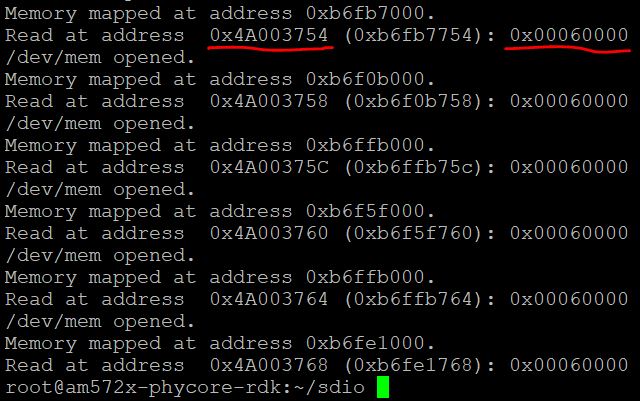

  • Additional update on the issue.
    Tested this at Uboot level. I configured the mmc_clk1 (0x1754) pin to gpio6_21 by writing CTRL_CORE_PAD_MMC1_CLK (0x4A00_3754) register to 0xE. With this PinMux update, GPIO_OE (0x4805_D134) register was cleared to make complete GPIO6 bank pins to output and toggling all bits on GPIO_DATAOUT (0x4805_D13C) register toggles the probe point being checked for MMC1_CLK line.
    I am assuming this observation rules out any hardware connectivity issues, atleast till the probe point on the board. Now beyond Uboot, after ARM boots up Linux and loads DSP firmware for MMC1 configuration I am not able to pin point what configuration maybe going wrong.
    If I try to repeat the above test executed at Uboot level on Linux using devmem2, I see L3 violation messages being dumps on ARM/Linux console. Does this mean there is still some conflict in configuration between ARM/Linux and DSP/Sysbios?

    I have kept the MMC1_CLK line trigger enabled for rising edge. In the non-working case, the clock always remains low and does not trigger. I have checked the clock trigger behavior when DSP runs with JTAG connection and confirmed that trigger settings are fine.
    Sorry for the confusion. MMC1 is being used by DSP and running SysBios based example project. MMC2 is being used by ARM and running Linux. This was described in the first post and that is the correct configuration.
    Thanks for the correction in device-tree, I will define the 'status=disabled' instead and then try with the updated DTB file.
    I will update my observations after testing.

    Just to clarify:  You have two ways to interface to MMC1.  One is via direct JTAG connect and load program into C66x; this one is working successfully.  The other one is to access C66x as remote cores and initialize sysbios via rproc commands, this one you can see the MMC1 module initialized, but no outputs at all.  Is this correct?
    Let me check with the SW team to understand what else needs to be set with rproc to enable the pinmux.  in the interim, can you set MMCHS_CON[16] CLKEXTFREE and [15] PADEN to 1 and see if there are any clocks coming out?
