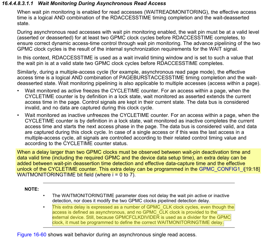

    GpmcFclkDivider actually does get used in asynch mode when latching WAIT inputs with WaitMonitoringTime > 0 - ie you need more than 2 GPMC_FCLK cycles from WAIT to data valid on bus (reads) or data latched by FPGA (writes). But GpmcFclkDivider does not alter the timings of the ONTIME/OFFTIME timings (CS,ADV,WE,OE). TimeParaGranularity can stretch their timings by a factor of 2. *EXTRADELAY can cause the ONTIME/OFFTIME to launch 1/2 GPMC_FCLK cycle later. You can slow the input clock to GPMC if the peripherals sharing it can still operate.
    Check out TRM 16.4.4.8.3.1.1 Wait Monitoring During Asynchronous Read Access
    And TRM 16.4.4.8.3.1.2 Wait Monitoring During Asynchronous Write Access
    AM574x Technical Reference Manual (Rev. B)
    Make sure to setup WRACCESSTIME and RDACCESSTIME to be at least 2 GPMC_FLCK cycles after your WAIT signal is valid (asserted either high or low after the address latch)
