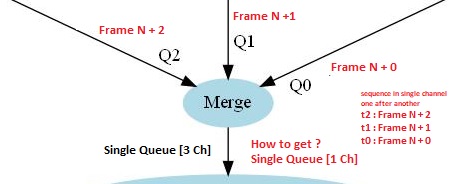

I am referring to tidl_OD usecase. and I have designed my usecase on similar lines as tidl_OD. Only difference is tidl_OD has grpx which overlays output on dupped input video.
In my case, I have alg link which draws on video frame itself and pass it to Display.
eg. Camera -> Alg_preProc(A15) -> Alg_Split(IPU)
Alg_Split(IPU) -> Alg_tidl(EVE1) -> Merge
Merge ->Alg_postProc(A15) -> Display
After merge, I am getting single queue with 3 channels output. But, my Alg_postProc is expecting single channel input and finally display also expects single channel input,
Can you comment , how can I get single queue single channel output after merge ?

    Use the Sync link after the Merge link.
