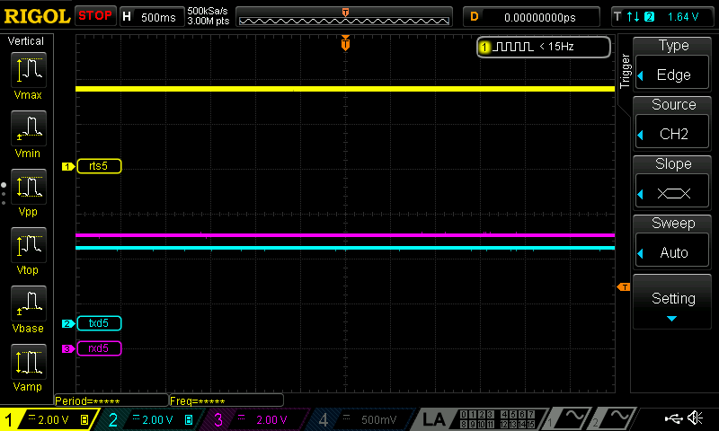

2. get the register dump of the locked port. you can use devmem2 command to read the registers.
It will be in the file UART5registers.txt which will be sent to the local support team
3. get all the tasks in the system by command "echo t > /proc/sysrq-trigger". You can send this log offline if you are not comfortable to post it here.
It will be in the file sysrq.txt which will be sent to the local support team
4. what is the state of RTS line (high or low) after the port is locked up?
It is high:
Once above states and logs are collected, please check if the UART IP is in sane state:
- write a char directly to the TX FIFO to see if there is any activity on the TX line, for example on UART5, "devmem2 0x481aa000 b 0x55", where 0xa81aa000 is the base address of UART5.
When writing to the failed port, there is no effect on the TX line

When writing to a working port, data can be observed on the TX line:
- send some data from the other side and see if AM3352 UART FIFO occupancy increases in offset 0x64 (UART_RXFIFO_LVL register).
For the failed port RXFIFO doesn't increase:
/dev/mem opened.
Memory mapped at address 0xb6f73000.
Read at address  0x481AA064 (0xb6f73064): 0x00
For the working port RXFIFO increases:
/dev/mem opened.
Memory mapped at address 0xb6f49000.
Read at address  0x481A8064 (0xb6f49064): 0x01
Also do you understand when exactly the lockup happens? Is it just after switching baud rate or in the middle of transfer or at the start or random? When the AM3352 UART lockup happens, it is a rs485 master, not slave, right?
It is after switching when trying to transfer data. Device is working as rs485 master.

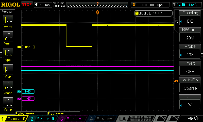

    The result is that port is still not working. The TX line is not changing after writing to register:
    root@test:~# devmem2 0x481aa000 b 0x55
    /dev/mem opened.
    Memory mapped at address 0xb6f2b000.
    Read at address  0x481AA000 (0xb6f2b000): 0x00
    Write at address 0x481AA000 (0xb6f2b000): 0x55, readback 0x55
    Our application is also not working with this port. What I observed is that after reset the following Python script is not hanging now. Means properly exits when finished.

    After running it, the TX counter in /proc/tty/driver/OMAP-SERIAL increases by 1. But there is no effect on TX line. Only RTS line reacts (the same as before port reset):
    Then SYSC register is 0x0 after reset:

    The good news is that resetting the UART5 unlocks it:
    root@test:~# root@test:~# devmem2 0x481aa040 b 0x1
    -sh: root@test:~#: command not found
    /dev/mem opened.
    Memory mapped at address 0xb6f26000.
    Read at address  0x481AA040 (0xb6f26040): 0x88
    Write at address 0x481AA040 (0xb6f26040): 0x01, readback 0x01

    Based on that we can try to implement in our application a workaround solution. However the best option would be to have it on the driver level.
