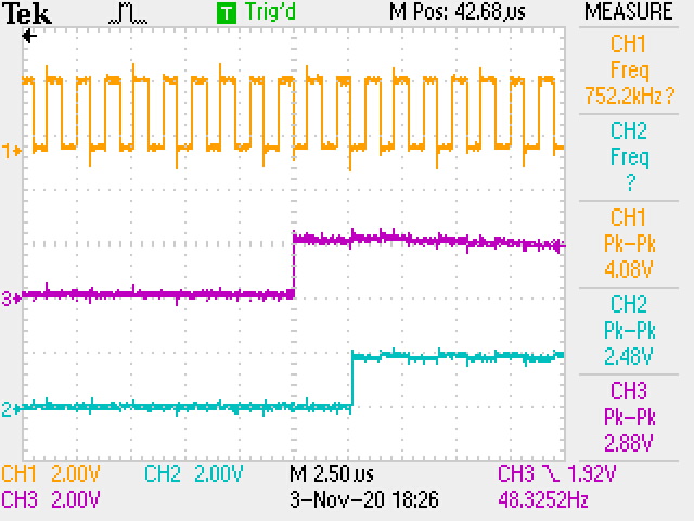

I am using TMDSEVM572X board for development.
As I mentioned earlier in my previous thread that I want to get data from 80x80 thermal
sensor where pixels info are :-
8bit raw - monochrome , 1pixel = 2byte.
Sensor gives hsync , vsync , pclk (sourced by external crystal:- 750khz) and 8 bit parallel data.
Data shall be captured on falling edge of pclk and sampled on rising edge of pclk.

the sensor is getting initialized by separate user space i2c test application,
data lines , pclk, hsync ,vsync are verified on DSO.
I have downloaded the yavta test application from github.
when the application gets run, the buffers get created for enqueue but dequeue
operation not performed it get stucked in ioctl(dev->fd, VIDIOC_DQBUF, &buf);
by the command defined in documentation
cat /proc/interrupts | grep vip
getting nothing , no interrupts found.
In vip documentation.
Why I am not seeing any interrupt generated from the sensor?

    I checked on DSO to verify the pclk,hsync,vsync according to sensor document.
    Still the same problem occurred.
    do not get anything in parser size register.
    devmem2 0x48995530
    Read at address 0x48995530 : 0x00000000
    I am attaching the screenshot of DSO for your convenience.
    The yellow line is pclk, pink one is vsync and blue is hsync.
    Output wave-forms are correct as per sensor document.
    What would be the another reason to obtain parser size register as 0x00000000?

    I have checked once again all the following:-
    1 Pinmux is not a problem, muxmode is set correctly.
    2. Device tree format is right but I assume, capture may fail due to set wrong polarity of hsync,vsysnc and pclk-sample.
    3.Yes, parser config register is set correctly and it is according to programmed parameters.
    I attached the DSO image in my previous post.
    where the vsync is skewed before the hsync, can VIP parser take input in this format?

    One thing which I not mentioned earlier, sensor gives data at 50 hz, is it ok with vip driver?
    Can I use ACTIVD style capture instead of HSYNC? to avoid blanking pixels.
    It is defined in documentation.
    HSYNC and Discrete Basic Mode set as 1 are hard coded in the driver and not controlled through dts entries.
    VIP driver register settings will need changes if the signals used for capture are DE (ACTVID) and/or Discrete Basic Mode set as 0.
    Should I change in somewhere in vip driver?
    Warmly thankful to you...!!!
    Krishna Vashistha
  • Hi Krishna,
    In the first diagram, yes, VIP will capture data when vsync is low, so if you dont have any hsync toggling during vsync is low, vip will not detect anything. You could change VIP setting to make vsync active low. In this case, VIP will capture when vsync is high.
    Yes, you could change to DE signal, instead of HS signal. Please check if DE input signal is connected and then you could change it in the VIP parser register.
    Brijesh
  • Hello Brijesh,
    Thanks for the quick response.
    You mean to say I should use vsync-active = 0 for figure (a) , right?
    and what about 50 hz for vip?
    Krishna Vashistha
  • Krishna,
    Yes, it should be fine. VIP is just a port, so does not care about 50fps, as long as pixel clock is within supported limit..
    Brijesh
