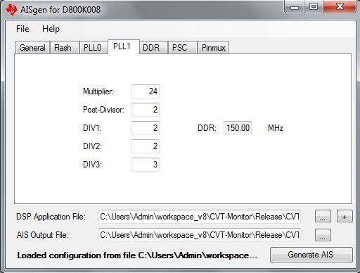

CCS/TMS320C6748: Not booting from NOR FLASH of DDR2 memory?
Part Number: TMS320C6748
Other Parts Discussed in Thread: OMAPL138
Hi sir,

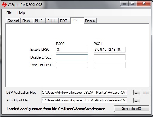

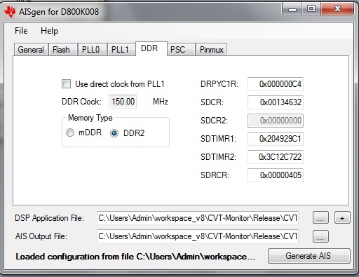

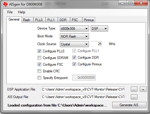

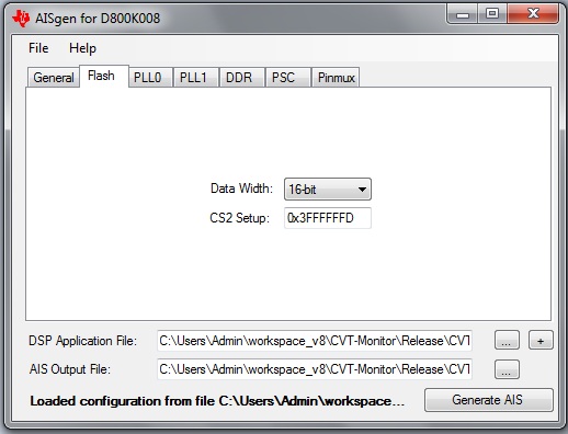

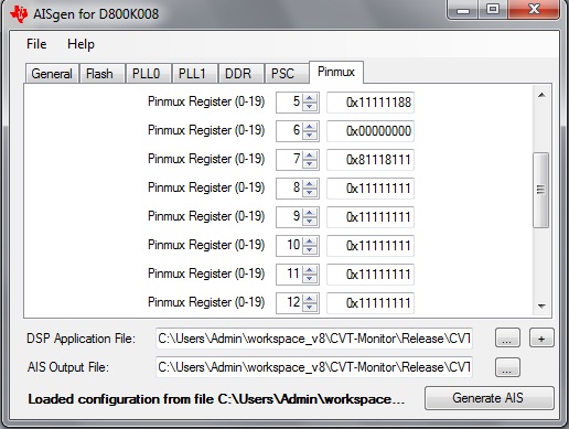

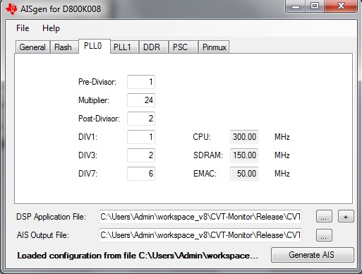

I am using TMS320C6748 DSP with External NOR Flash using.
Actually in .cmd file DSPL2RAM i used it is booting from NOR FLASH, when i will change to DDR2 in .cmd it's not booting.
In AIS Gen all settings given properly please could you give me some suggestions.
below i am attaching AIS Gen setting images and (whatever in Debug mode DDR2 worked fine used) OMAPL138_LCDK.gel attaching.
and i am attaching my gel(OMAPL138_LCDK) file also sir,

OnTargetConnect( )
GEL_TextOut("\tTarget Connected.\n","Output",1,1,1);
GEL_TextOut("\t---------------------------------------------\n","Output",1,1,1);
Clear_Memory_Map();
Setup_Memory_Map();
PSC_All_On();
Core_300MHz_mDDR_150MHz();
Wake_DSP();

Set_Core_456MHz() {
device_PLL0(0,18,0,0,1,11,5);
GEL_TextOut("\tPLL0 init done for Core:456MHz, EMIFA:38MHz\n","Output",1,1,1);
Set_Core_300MHz() {
device_PLL0(0,24,1,0,1,11,5);
GEL_TextOut("\tPLL0 init done for Core:300MHz, EMIFA:25MHz\n","Output",1,1,1);

Set_DDR2_150MHz() {
GEL_TextOut("\tDDR initialization is in progress....\n","Output",1,1,1);
Set_DDRPLL_150MHz();
DEVICE_DDRConfig(DDR2, 150);

Device_PLL0 init:
CLKMODE - 0---->On Chip Oscilator 1---->External Oscilator
PLL0_SYSCLK1 - Fixed ratio /1
PLL0_SYSCLK2 - Fixed ratio /2
PLL0_SYSCLK3 - Variable Divider (EMIFA)
PLL0_SYSCLK4 - Fixed ratio /4
PLL0_SYSCLK5 - Not used -- do nothing
PLL0_SYSCLK6 - Fixed ratio /1
PLL0_SYSCLK7 - Variable Divider (RMII)
0,24,1,0,1,11,5
device_PLL0(unsigned int CLKMODE, unsigned int PLLM, unsigned int POSTDIV,unsigned int PLLDIV1, unsigned int PLLDIV2, unsigned int PLLDIV3, unsigned int PLLDIV7 ) {
unsigned int i=0;
/* Clear PLL lock bit */
CFGCHIP0 &= ~(0x00000010);
/* Set PLLENSRC '0',bit 5, PLL Enable(PLLEN) selection is controlled through MMR */
PLL0_PLLCTL &= ~(0x00000020);
/* PLLCTL.EXTCLKSRC bit 9 should be left at 0 for Freon */
PLL0_PLLCTL &= ~(0x00000200);
/* Set PLLEN=0 to put in bypass mode*/
PLL0_PLLCTL &= ~(0x00000001);
/*wait for 4 cycles to allow PLLEN mux switches properly to bypass clock*/
for(i=0; i<PLLEN_MUX_SWITCH; i++) {;}
/* Select the Clock Mode bit 8 as External Clock or On Chip Oscilator*/
PLL0_PLLCTL &= 0xFFFFFEFF;
PLL0_PLLCTL |= (CLKMODE << 8);
/*Clear PLLRST bit to reset the PLL */
PLL0_PLLCTL &= ~(0x00000008);
/* Disable the PLL output*/
PLL0_PLLCTL |= (0x00000010);
/* PLL initialization sequence
Power up the PLL by setting PWRDN bit set to 0 */
PLL0_PLLCTL &= ~(0x00000002);
/* Enable the PLL output*/
PLL0_PLLCTL &= ~(0x00000010);
/*PLL stabilisation time- take out this step , not required here when PLL in bypassmode*/
for(i=0; i<PLL_STABILIZATION_TIME; i++) {;}
/*Program the required multiplier value in PLLM*/
PLL0_PLLM = PLLM;
/*If desired to scale all the SYSCLK frequencies of a given PLLC, program the POSTDIV ratio*/
PLL0_POSTDIV = 0x8000 | POSTDIV;
/*Check for the GOSTAT bit in PLLSTAT to clear to 0 to indicate that no GO operation is currently in progress*/
while(PLL0_PLLSTAT & 0x1==1){}
/*Program the RATIO field in PLLDIVx with the desired divide factors. In addition, make sure in this step you leave the PLLDIVx.DxEN bits set so clocks are still enabled (default).*/
PLL0_PLLDIV1 = 0x8000 | PLLDIV1; // Fixed Ratio /1
PLL0_PLLDIV2 = 0x8000 | PLLDIV2; // Fixed Ratio /2
PLL0_PLLDIV4 = 0x8000 | (((PLLDIV1+1)*4)-1); // Fixed Ratio /4
PLL0_PLLDIV6 = 0x8000 | PLLDIV1; // Fixed Ratio /1
PLL0_PLLDIV3 = 0x8000 | PLLDIV3; // Variable Ratio (EMIF)
PLL0_PLLDIV7 = 0x8000 | PLLDIV7; // Variable Ratio (RMII)
/*Set the GOSET bit in PLLCMD to 1 to initiate a new divider transition.*/
PLL0_PLLCMD |= 0x1;
/*Wait for the GOSTAT bit in PLLSTAT to clear to 0 (completion of phase alignment).*/
while(PLL0_PLLSTAT & 0x1==1) { }
/*Wait for PLL to reset properly.*/
for(i=0; i<PLL_RESET_TIME_CNT; i++) {;}
/*Set the PLLRST bit in PLLCTL to 1 to bring the PLL out of reset*/
PLL0_PLLCTL |= 0x8;
/*Wait for PLL to lock.*/
for(i=0; i<PLL_LOCK_TIME_CNT; i++) {;}
/*Set the PLLEN bit in PLLCTL to 1 to remove the PLL from bypass mode*/
PLL0_PLLCTL |= 0x1;
DDR PLL1 init:
device_PLL1(unsigned int PLLM,unsigned int POSTDIV,unsigned int PLLDIV1, unsigned int PLLDIV2, unsigned int PLLDIV3 ) {
unsigned int i=0;
CFGCHIP3 &= ~(0x00000020);
PLL1_PLLCTL &= ~(0x00000020);
PLL1_PLLCTL &= ~(0x00000200);
PLL1_PLLCTL &= ~(0x00000001);
PLL1_PLLCTL &= ~(0x00000008);
PLL1_PLLCTL |= (0x00000010);
PLL1_PLLCTL &= ~(0x00000002);
PLL1_PLLCTL &= ~(0x00000010);
PLL1_PLLM = PLLM;
PLL1_POSTDIV = 0x8000 | POSTDIV;
while(PLL1_PLLSTAT & 0x1==1){}
PLL1_PLLDIV1 = 0x8000 | PLLDIV1; // DDR frequency (aka 2X_CLK)
PLL1_PLLDIV2 = 0x8000 | PLLDIV2; // Optional CFGCHIP3[ASYNC3_CLKSRC] clock source
PLL1_PLLDIV3 = 0x8000 | PLLDIV3; // Optional PLL0 clock source
PLL1_PLLCMD |= 0x1;
while(PLL1_PLLSTAT & 0x1==1) { }
/*Wait for PLL to reset properly */
PLL1_PLLCTL |= 0x8;
/*Wait for PLL to lock. See PLL spec for PLL lock time*/
PLL1_PLLCTL |= 0x1;

But through serial port not displaying any thing from DDR2 settings,
from Internal DSPL2RAM it's working fine sir.
Any Specific entry point i want add because its disable i used.
Could you give me some suggestions.
Thanking you,
