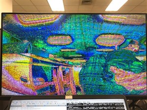

Now I already can play some image data on DP, but there are some format issue still need to debug.

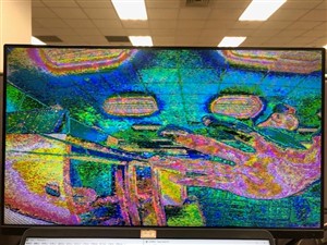

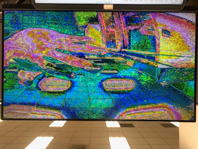

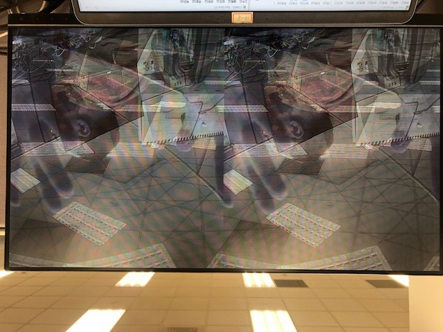

Please see below format type and map to result picture

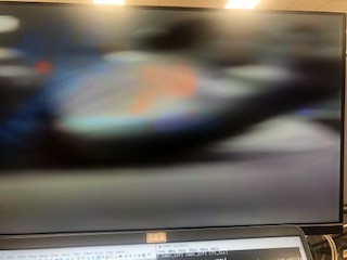

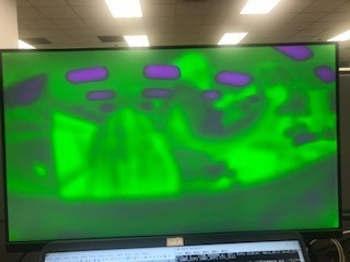

  • When I set DataFormat is VX_DF_IMAGE_YUYV, the image output as below
  • When I set DataFormat is VX_DF_IMAGE_UYVY, the image output as below
I set the capture size as 2880 * 1860, and output size as 1920 * 1080. and pitchY / pitchUV as 5760.
Can anyone give me advise how to modify the caputre/display parameter for IMX490 sensor?
BR
Sentinen Chen
  • Hi Chen,
    Can you please adjust the focus on the camera to view image clear?
    It looks like YUYV image format displays correct output, please confirm..

  • HI Brijesh:
    ==> Sorry, does this mean that I create a new thread and change part number to DS90UB962/DS90UB953/IMX490 ??
    ==> Yes, I also think YUYV image is correct than UYVY, but I didn't know why the Y part image size seem still as 2880*1860, it didn't resize to 1920*1080.
    And UV part seem close to 1920*1080 more.

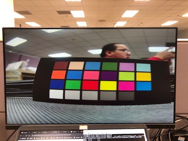

  • Hi Chen,
    I mean, do you have lens connected to the sensor? Can this lens be adjusted to change the focus of the scene?
    Also if the format is YUYV interleaved, then luma and chroma will have exactly same size, it cannot be different.
    Brijesh

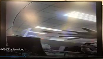

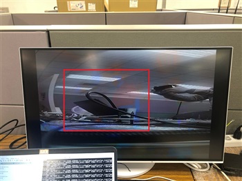

  • Hi Brijesh:
    Sorry for I misunderstand your information early.
    After check IMX490 camera module, I change the distance between lens and sensor.
    Now I can get more clearly image, like below picture
    But you can see the red part in picture,
    it seem the luma and chroma still didn't have the same size.

  • Hi Chen,
    ok, that's good.
    It seems the chroma is slight shifted. But this is not possible for YUV422 interleaved format to have chroma shifted in the middle of the frame. It seems few first lines are correct, but somewhere in the middle, there is shift..
    In YUV422 Interleaved format, CSIRx just outputs the data into memory as it is receives from external device. It does not conversion..
    Can you please confirm that ISP is outputting in YUV422 format?
    Also if you just revert the changes in CSIRX node and get the original frame, save the frame and view it offset and see if there are any artifacts..
    Brijesh

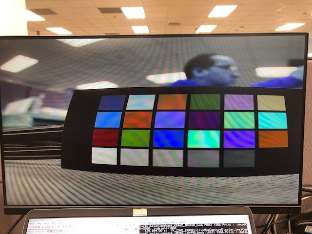

  • Hi Chen,
    ok, so now input resolution and output resolutions are exactly same? 2880x1800? Even then are you seeing artifacts?
    Brijesh
  • Hi Brijesh;
    Oh, not exactly same, but very close (input resoultion: 2880*1860, output resoultion: 2880*1800).
    we still can see artifacts when camera preview.
    BR
    Sentinen Chen
  • Hi Chen,
    Just for the experiment, can you please input size same as output size ie 2880x1800? You just need to override inFmt.width/inFmt.height to 2880x1800..
    It will disable scalar completely and lets see if there are still issues in the image.
    Brijesh

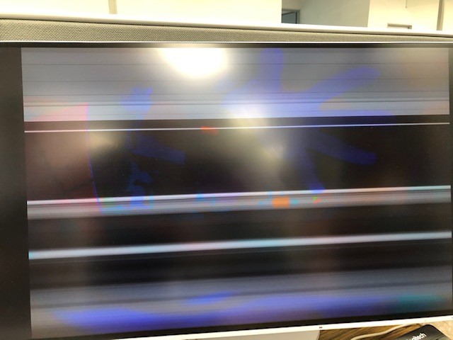

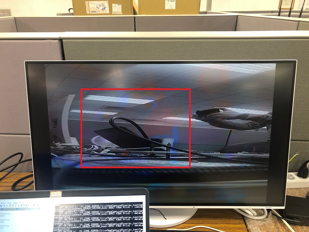

  • Hi Brijesh:
    Update the latest status to you
    Because I can't direct control IMX490 camera sensor output size.
    I config Vision_Apps all resolution as 2880 * 1860, no matter in display controller or display pipeline.
    [MCU2_0]    207.070845 s:  VX_ZONE_ERROR:[tivxDisplayCreate:468] [tivxDisplayCreate]468, in.width=2880, in.height=1860, outWidth=2880, outHeight=1860
    [MCU2_0]    207.070926 s:  VX_ZONE_ERROR:[tivxDisplayCreate:469] [tivxDisplayCreate]469, pitch[0]=5760, pitch[1]=0, pitch[2]=0
    But I still can see the artifacts,
    Please see below picture
    PS: I think display controller output already be 2880*1860 and no scalar,  then the Luma size in this picture should more than 2880 * 1860.
    Do you have any idea?
    BR
    Sentinen Chen
  • Hi Chen,
    Now since the input and output resolutions are exactly same, there is no scaling involved. The scaling will just be used for YUV422 to YUV444 conversion, this is just chroma upsampling..
    I am just wondering if this is something to do with scaling at such high line size.
    So can you one experiment, can change inFmt.width to lets says 2048, keeping the pitch of the image size.. It will not display last 800 pixels, but lets see if this issue still comes or not.
    Brijesh

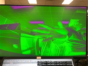

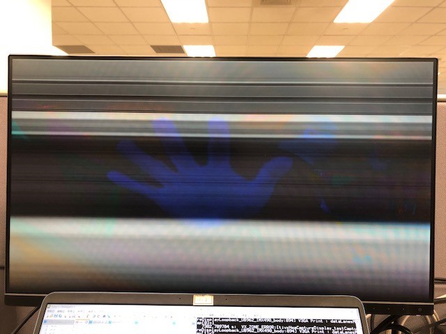

  • Hi Brijesh:
    I try below two situation
    • inFmt.width=2048, pitch[0]=5760, display controller is 1920*1080
    [MCU2_0]   7382.794844 s:  VX_ZONE_ERROR:[tivxDisplayExtractFvid2Format:205] tivxDisplayExtractFvid2Format[205], format->width=2048, format->height=1860
    [MCU2_0]   7382.794953 s:  VX_ZONE_ERROR:[tivxDisplayCreate:472] [tivxDisplayCreate]472, in.width=2048, in.height=1860, outWidth=1920, outHeight=1080
    [MCU2_0]   7382.795017 s:  VX_ZONE_ERROR:[tivxDisplayCreate:473] [tivxDisplayCreate]473, pitch[0]=5760, pitch[1]=0, pitch[2]=0
    [MCU2_0]   7382.795065 s:  VX_ZONE_ERROR:[tivxDisplayCreate:477] [tivxDisplayCreate]477 scEnable set to TRUE
    the preivew result as below
    • inFmt.width=2048, pitch[0]=5760, display controller is 2880*1860
      [MCU2_0]    284.186022 s:  VX_ZONE_ERROR:[tivxDisplayExtractFvid2Format:205] tivxDisplayExtractFvid2Format[205], format->width=2048, format->height=1860
      [MCU2_0]    284.186104 s:  VX_ZONE_ERROR:[tivxDisplayCreate:472] [tivxDisplayCreate]472, in.width=2048, in.height=1860, outWidth=2880, outHeight=1860
      [MCU2_0]    284.186164 s:  VX_ZONE_ERROR:[tivxDisplayCreate:473] [tivxDisplayCreate]473, pitch[0]=5760, pitch[1]=0, pitch[2]=0
      [MCU2_0]    284.186213 s:  VX_ZONE_ERROR:[tivxDisplayCreate:477] [tivxDisplayCreate]477 scEnable set to TRUE
      The preview result as below
    The two situation all can see chroma part, but luma part can't preview.
    BR
    Sentinen Chen
  • Hi Brijesh:
    Update latest information to you.
    I try to modify inFmt.width to 1920, and test:
    • inFmt.width=1920, pitch[0]=5760, display controller is 1920*1080
    [MCU2_0]   4124.176447 s:  VX_ZONE_ERROR:[tivxDisplayExtractFvid2Format:205] tivxDisplayExtractFvid2Format[205], format->width=1920, format->height=1860
    [MCU2_0]   4124.176530 s:  VX_ZONE_ERROR:[tivxDisplayCreate:472] [tivxDisplayCreate]472, in.width=1920, in.height=1860, outWidth=1920, outHeight=1080
    [MCU2_0]   4124.176588 s:  VX_ZONE_ERROR:[tivxDisplayCreate:473] [tivxDisplayCreate]473, pitch[0]=5760, pitch[1]=0, pitch[2]=0
    [MCU2_0]   4124.176636 s:  VX_ZONE_ERROR:[tivxDisplayCreate:477] [tivxDisplayCreate]477 scEnable set to TRUE
    Below is result picture
    The result resolution seem right, only color still have some problem.
    BR
    Sentinen Chen
  • Hi Chen,
    But then it is not issue in the DSS. 1920 frame size for the input and output is tested and by default supported resolution in SDK. We dont see color artifacts for 1920 image size.
    Are you sure the image that is given to the DSS input is correct? or may be is it in correct format? For example, input image is in YUYV format, but DSS is configured for UYVY format. Can you try different input format  in DSS for 1920 frame size?
    Brijesh
  • Hi Brijesh:
    • then it is not issue in the DSS.
      ==> But I only change display pipeline input as 1920 in tiovx/kernels_j7/hwa/test/display/vx_display_target.c,
             pitch[0] still is 5760, like below modify:
      @@ -194,11 +196,13 @@ static vx_status tivxDisplayExtractFvid2Format(const tivx_obj_desc_image_t *obj_
           vx_status status = (vx_status)VX_SUCCESS;
           Fvid2Format_init(format);
      -    format->width = obj_desc_img->imagepatch_addr[0].dim_x;
      +    //format->width = obj_desc_img->imagepatch_addr[0].dim_x;
      +    format->width = 1920;
           format->height = obj_desc_img->imagepatch_addr[0].dim_y;
           format->ccsFormat = FVID2_CCSF_BITS8_PACKED;
           format->scanFormat = FVID2_SF_PROGRESSIVE;
      In this modify, we can see yesterday picture.
      But if I directly modify "inWidth as 1920" in tiovx/kernels_j7/hwa/test/test_capture_display.c
      then inFmt.width is1920, and pitch[0] is 3840, and preview picture will become below status:
    • Can you try different input format  in DSS for 1920 frame size?
      ==> Below is different Format setup:
      • inFmt.width=1920, picth[0]=5760, display Format use UYVY,
      • inFmt.width=1920, picth[0]=5760, display Format use YVYU,
      • inFmt.width=1920, picth[0]=5760, display Format use VYUY,
    PS: I ask our colleague who enable IMX490 in Qualcomm platform, they set their code as 2880*1860 and UYVY format.
    BR
    Sentinen Chen

  • Hi Brijesh:
    We find one interesting situation,
    1. if we use YVYU format to open the save picture, then the picture preview's color become normal.
    2. I try to edit the save picture by hex editer tool that I directly add one byte( as U) in the beginning of picture.
        Then preview the new picture by UYVY format, the color is also normal.
    Compare with Qualcomm platform's config that it is preview by UYVY format ,
    Is it possible we lost one byte when capture csirx data and put into framebuffer
    BR
    Sentinen Chen
  • Hi Chen,
    That's very unlikely. CSIRX will not drop any byte and that too at the start of the image..
    When you say your transmitter is sending frame in UYVY format, which component is output on the first clock cycle? If it is Y, followed by V and so on, then capture is in the correct format, Y in lower byte, followed by V and so on..
    We should not add additional byte in the image, as it will change correspondence between luma and chroma pixels.
    I think what we are trying to debug is the display. Display seems to be not displaying this image correctly, capture is correct and in the correct format.. isn't it correct?
    Rgds,
    Brijesh
  • Hi Brijesh:
    I test the same IMX490 camera on Vision_apps 07_01 version.
    It seem we set the YUYV format is correct.
    The preview picture on Vision_apps 07_01 version as below:
    But I still need set "inFmt.width to 1920" (inFmt.width=1920, pitch[0]=5760, display controller is 1920*1080)
    BR
    Sentinen Chen
  • Hi Chen,
    The colors still looks off. could not get get why you are saying it looks correct.
    Brijesh
  • Hi Brijesh:
    You can see below two picture compare
    The first one: RTOS  0701 version,  the second one: RTOS 0700 version
    PS: Below is origin color card taked by cellphone.
    BR
    Sentinen Chen
  • Hello Chen,
    ok, good to see it is working fine on SDK7.1 release.
    We have support for few more formats in the SDK7.1, may be that's helping here.
    Please close the thread if you think your question is answered.
    Brijesh
