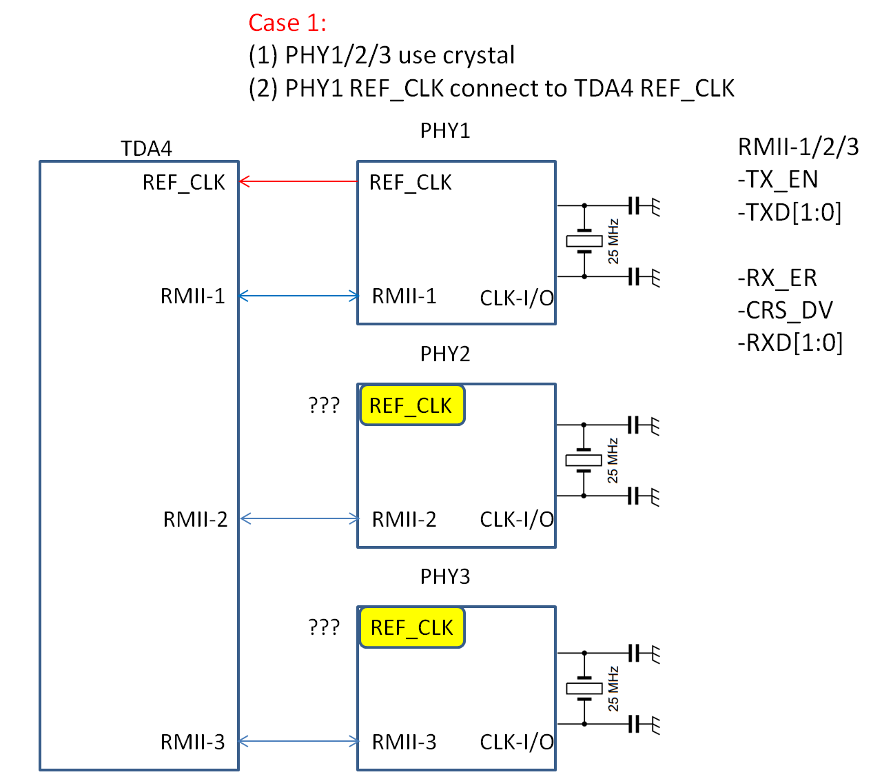

We want to use 3 PHY (RMII) connect to TDA4 CPSW9 (Main) Ethernet domain.
As the TDA4 only have one REF_CLK pin for all CPSW9 RMII interface. So I want to double check with you about the REF_CLK connection concept. If every PHY REF_CLK need connect to TDA4 REF_CLK.
Please check the below use case 1 / 2 / 3. I want to know if they can working or not ?
Yutai
Option 1 is no. Option 2 is yes. Option 3 might be yes – PHY supports multiple output pins for REF_CLK.
The key for options 2/3 is to make sure to include the clock propagation and routing delays into the timing analysis for each interface. The setup/hold timings for all three RMII interfaces must be met when timing all three data busses against the common REF_CLK input to the SoC.

Can we use the TDA4 CLK OUT (50MHz) to sync TDA4 REF_CLK and others PHY REF_CLK
Yutai
Yes - MCU_CLKOUT0 assuming you buffer the clock to route to multiple destinations.
That means Main domain (CPSW9G) signal CLKOUT (pin AA25 / AJ28 /Y29) or WKUP/mcu domain signal MCU_CLK_OUT0 (pin H27) both used the sync TDA4 RMII and PHY RMII REF CLK.
Question:
1. How about the CLKOUT driver strength, does it can driver 3 PHY and route back to TDA4 RMII REF CLK.
2. If we must add external clock buffer ?
Yutai
As previously mentioned, and as discussed with your diagrams - an external clock driver is recommended - primarily for signal integrity reasons.
